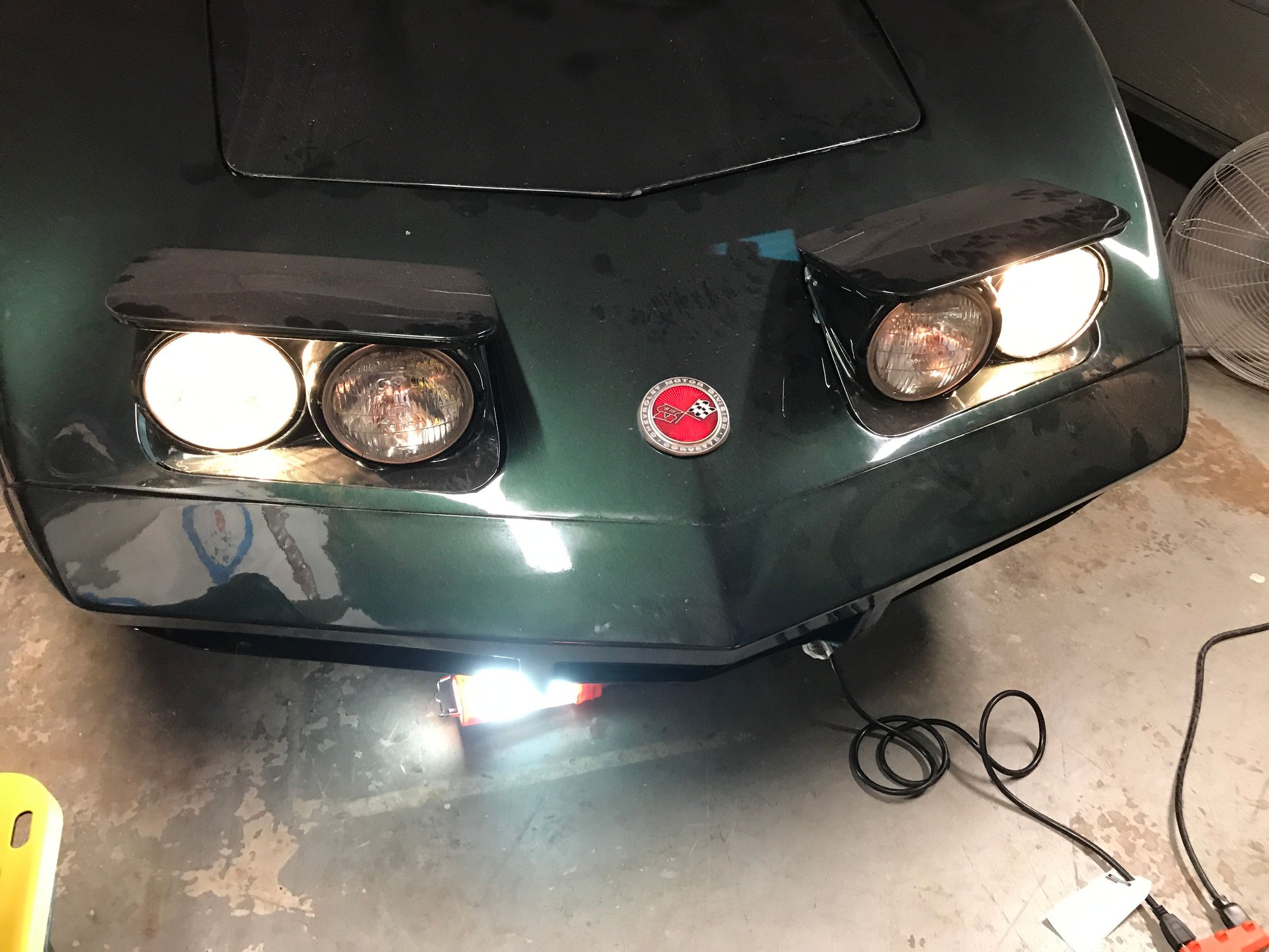

Trying to troubleshoot headlights, 1974.
My headlights will come up, and high beams work... just no low beams. Would both low beams go out at the same time? I wouldn't think so...
Are the high and low on separate fuses? I wouldn't think so, but just asking.
Also, the fuse box - there's nothing that blatantly says headlights... so which fuse runs them?
I know they worked, but the car was at a shop for 16 months not driven... now they don't work. Tail lights and turns work... as well as interior dash & dimmer on the instrument cluster.

Is there a trick to get this out? It's almost like the assembly isn't going high enough for this to come out.

Yes... I only have the two side screws... missing all 4 top screws... ordering some now.
But the bezel is stuck.. the whole assembly needs to come up more in order to pull out... but reaching the adjustment screw is gonna be a challenge.

Just a burned out light... fenegled the lamp out without taking the bezel off... replaced the lamp and it worked.
both low beams went out at the same time :O
