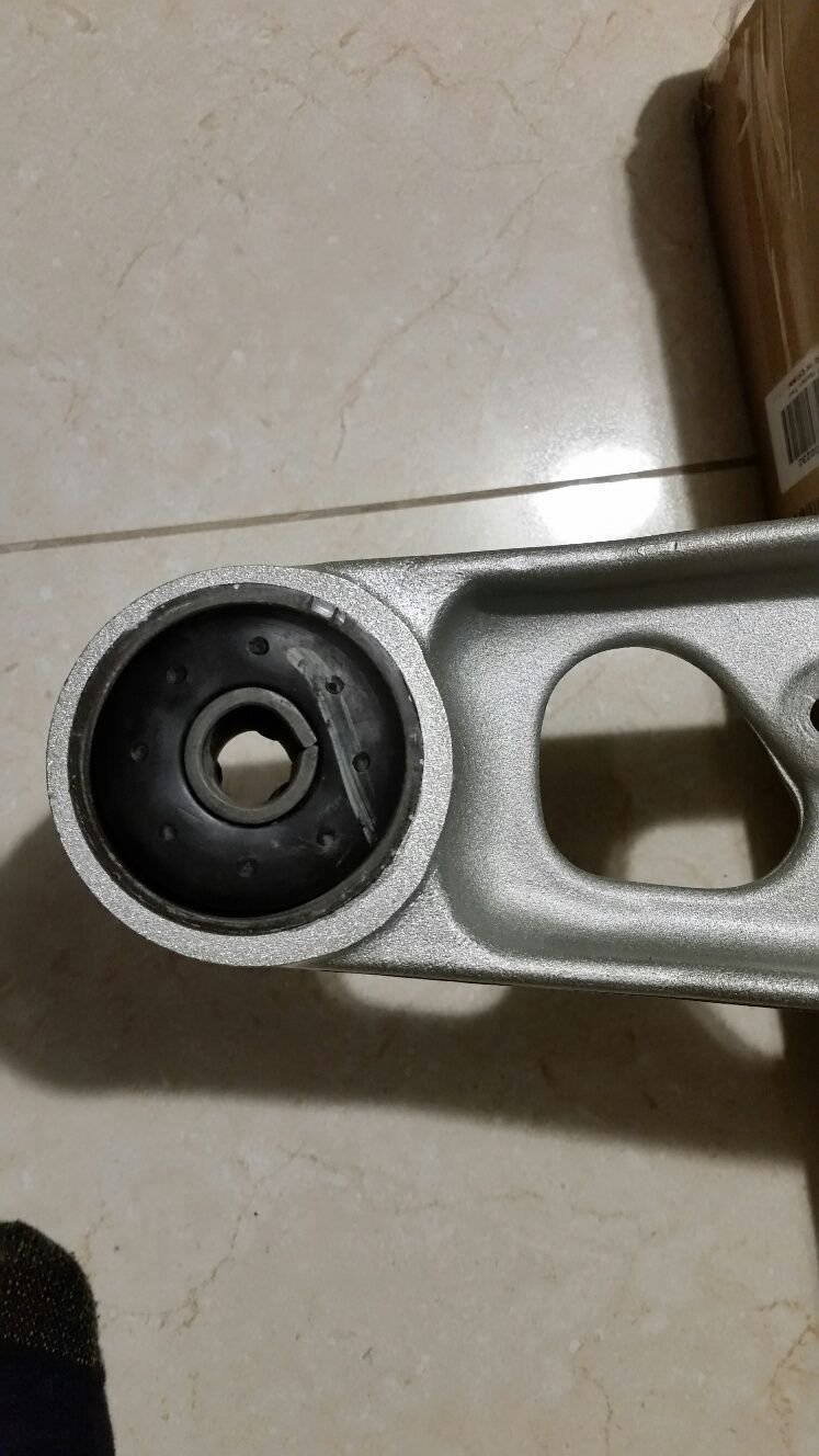

I'm looking to reinstall the stock rubber bushings into the diff cover/carrier. Anyone have a technique that worked for them? i plan on starting with a big c-clamp and not anticipating an issue but ya know how that goes. And can someone confirm they press in from the front facing the rear of the crossnember? All my research leads to that and they seem to get a better start in that position.

I was starting to think that no one attempted this. i read up that putting them in the freezer overnight contracts the metal some and to lubricate the housing. i have a 2 ft. heavy duty c-clamp i'm gonna start with, most likely with a breaker bar towards the end. 2nd option is a grade 8 nut, bolt and impact gun and pull it in. Any other thoughts or ideas are welcome. Going to attempt it this week, ill let ya know.

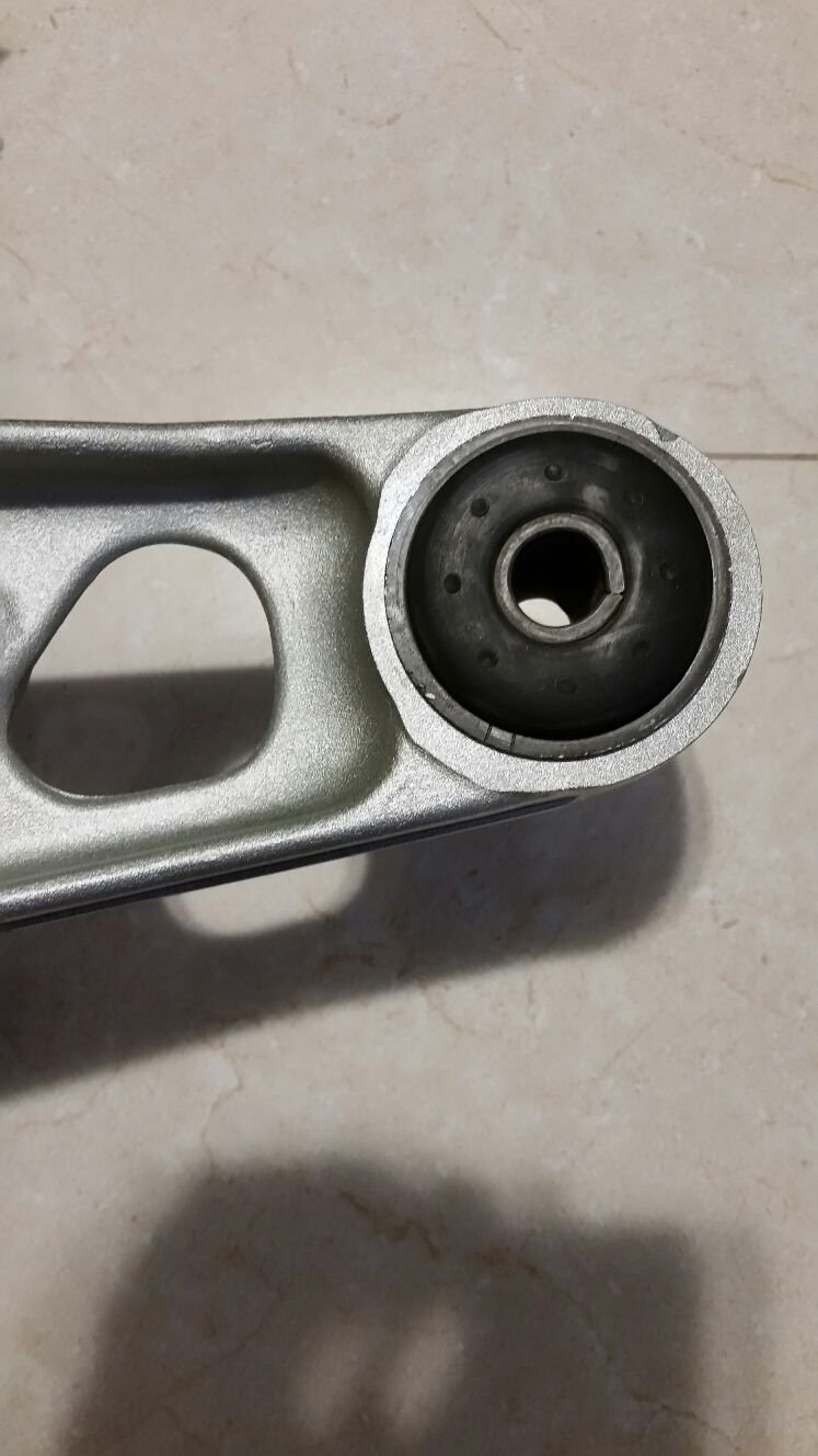

Yes they install from the front. Upon a closer look there is an indent in the housing on the batwing which corresponds with an outdent on the bushing. Gonna play with it this week.

So the 1st attempt with the c clamp failed due to the screw extending too far and bending. In its defense i took a phone call 3/4 of the way in and left the pressure on it. When i resumed it bent. Next attempt with the bolt and washers, pulling it in went nowhere also. Wound up purchasing a 21 piece ball joint press and it went in with ease. Heavy duty clamp and screw with plenty of attachments and I can use it for other bushing replacements. I would recommend it if you don't have. EBAY of course. However between the width of the housing and bushing, i needed another 3/4in receiving tube as the others are 2 and 2 1/4. Went to auto zone and rented another kit at no charge.
They're in and next step, attaching the differential with new 354:1 gears.
