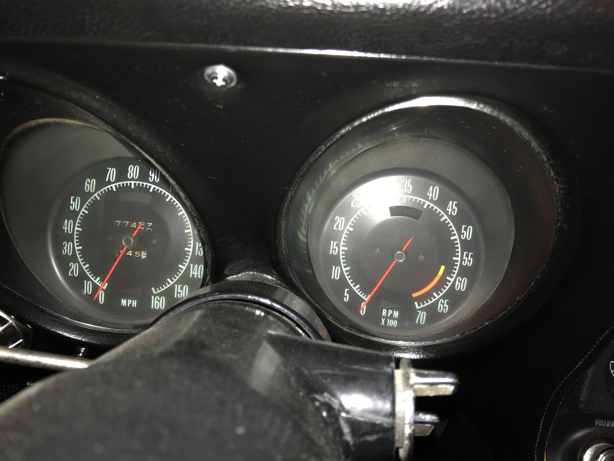

Default maybe it really was a 350/350 like the console plate says
Originally Posted by Revi
If the tach is original to the car, the redline will give you a clue as to which engine was originally installed.
IIRC,
5300rpm - 300hp/350
5500rpm - 390/400hp/427
6000rpm - 350hp/350
6500rpm - 430/435hp/427
