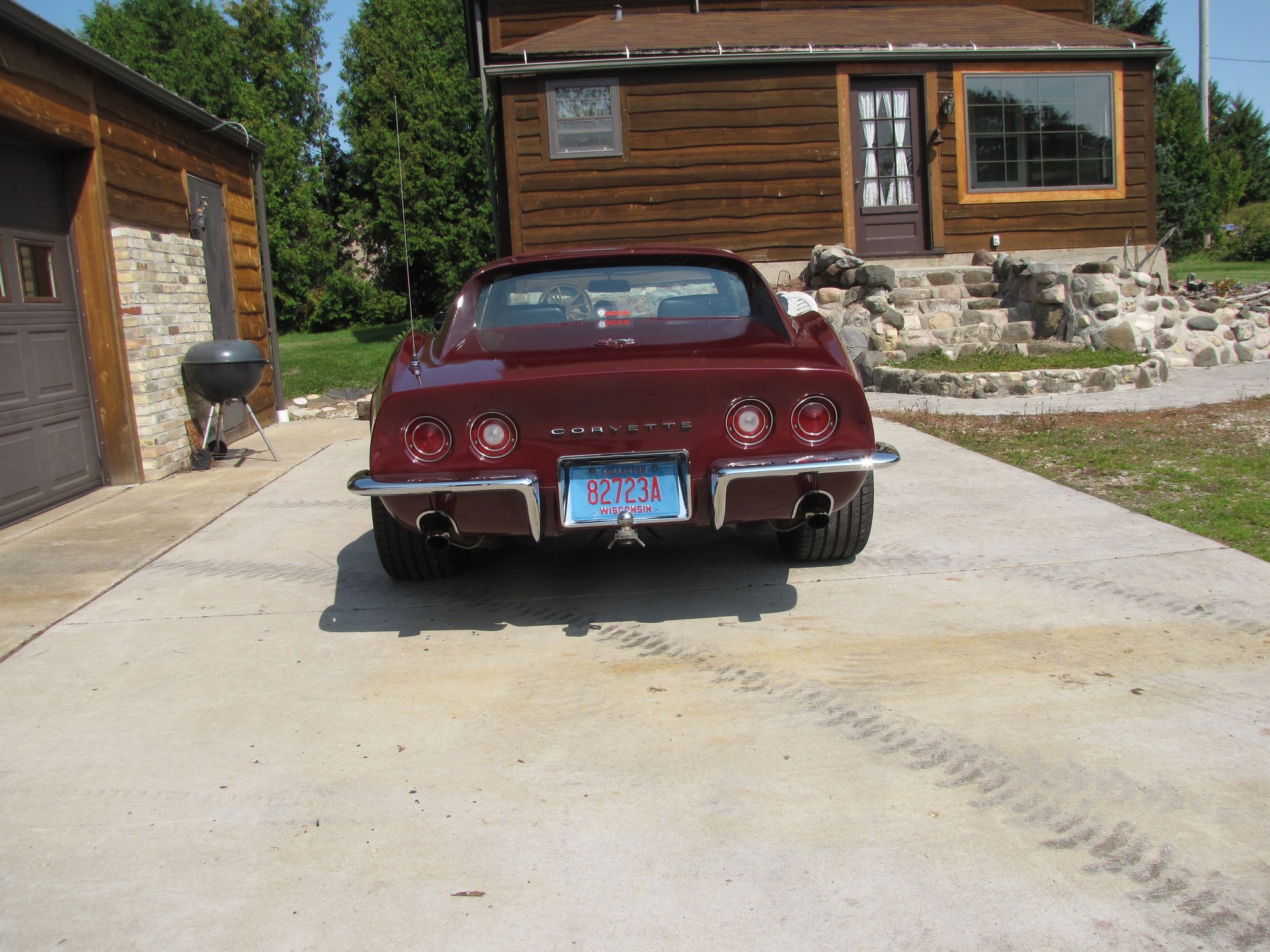

A 1969.
Front 255/40/18x9.0 4.5 backspace. No modifications needed.
Rear 285/40/18x10 5.0 backspace. Offset trailing arms [not deeded with parking brake calbe relocate, but I had 1 bad T/A] and shortened rear composite spring.
There is a sticky at the top of general section for wheel and tire upgrades with so much eye candy and info you'll go into overload.

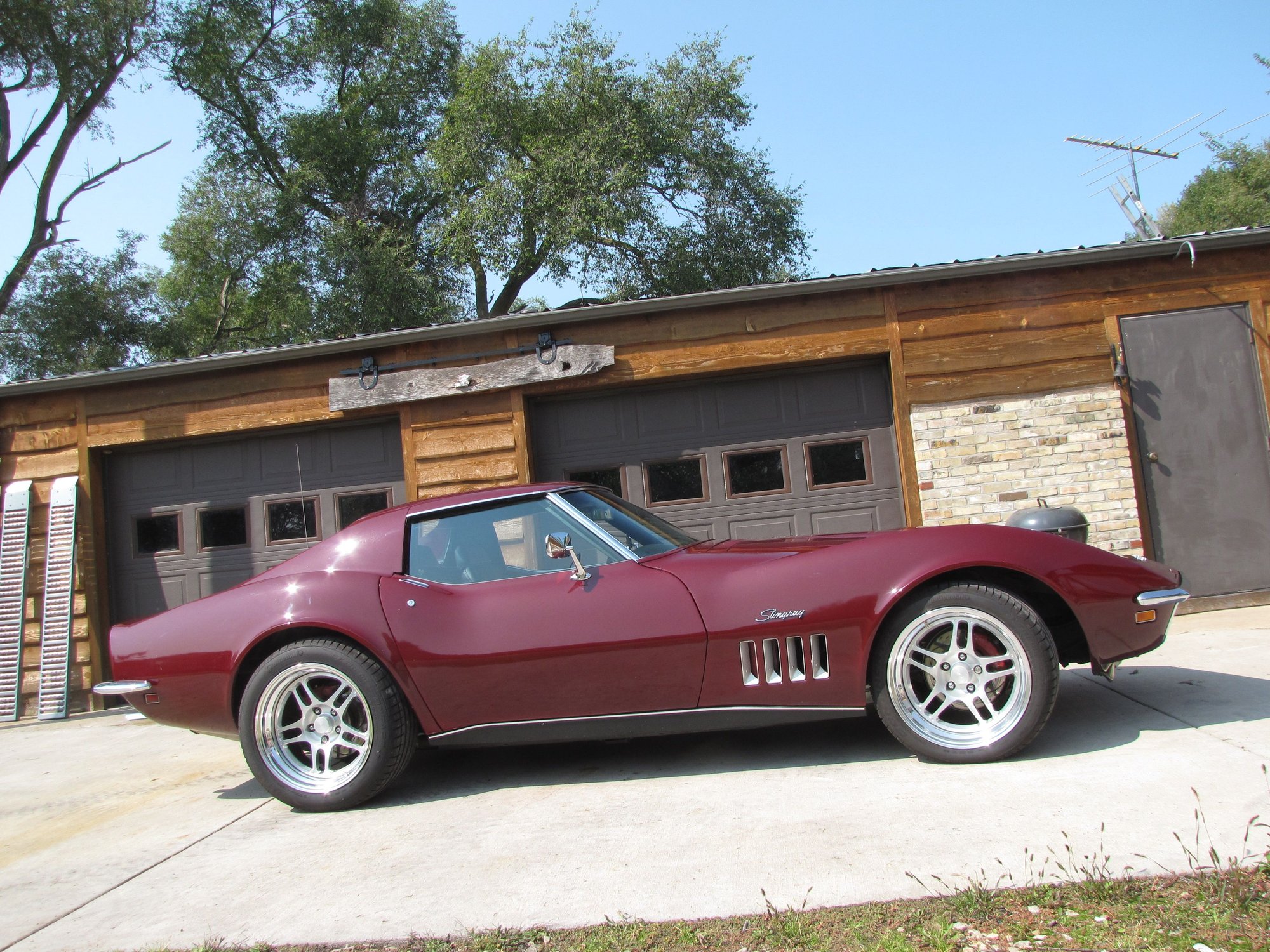

Here's what the 69 looks like. T

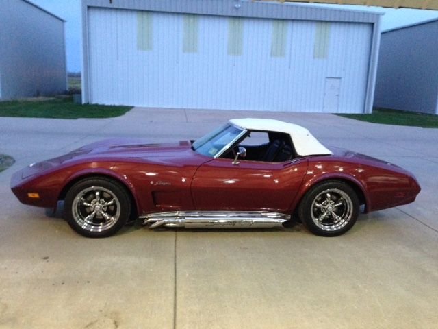

Added these over the summer. American Racing Torque Thrust II polished 17x8 4.03" backspace with Nitto NT 555 G2 245/45zr17 front 255/50zr17 rear. I HAD to have tires and couldn't wait any longer. Wanted the better rubber and bigger wheels and with other stuff going on, wanted something I knew would bolt right up because I didn't have time to mess with moving the p brake bracket. The car had Truespoke 15s on it with a spacer, and even with everything I read saying spacers are ok, I wanted something that didn't need them. Later on I'll move the bracket and go wider on the rear.

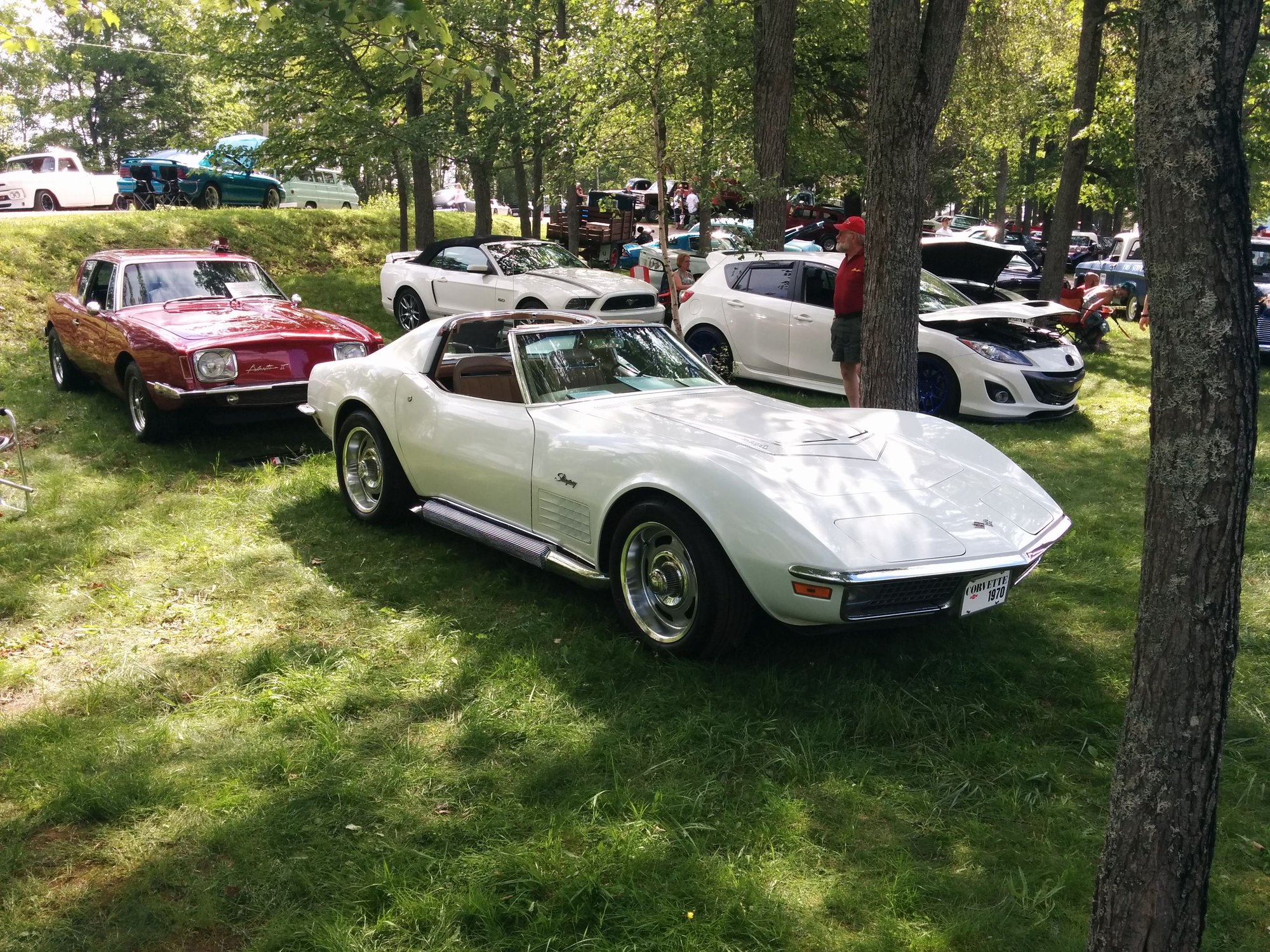

Originally Posted by VETFEVER
google "Year One" wheels and you will see a 17 inch full alloy wheel that looks like the 15 inch rally wheel.
Gives you an OEM look with modern tire choices...
A few on here have them and say god things about them.

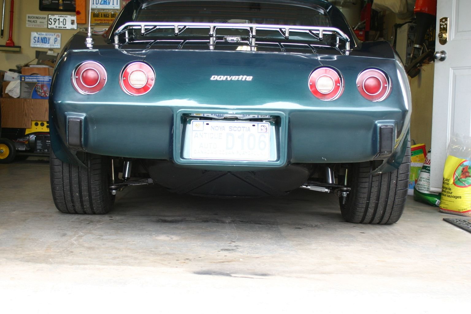

The Year One Wheels...

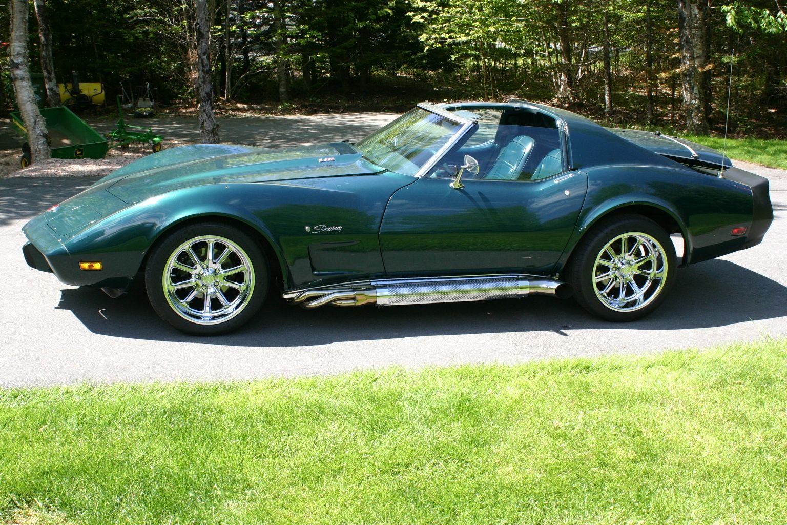

I see a lot of people over do with too tall a wheel and too low a profile tire and it starts to look like this:

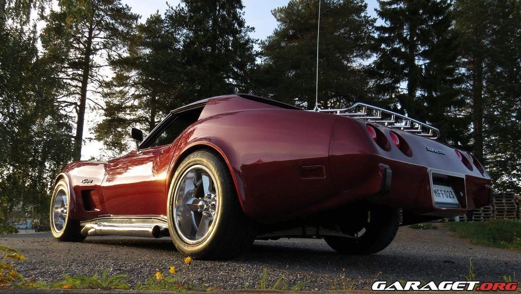

I like My 17's
225/55 and 255/50 on 17x8 and 17x9.5

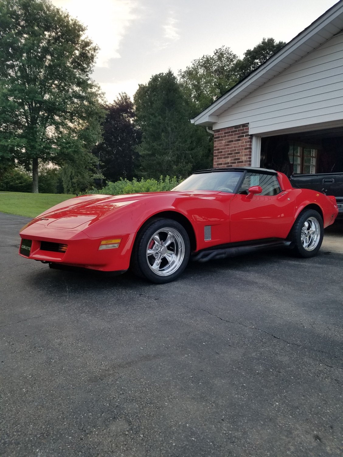

Torque Thrust ll with 245/45/17 tires
