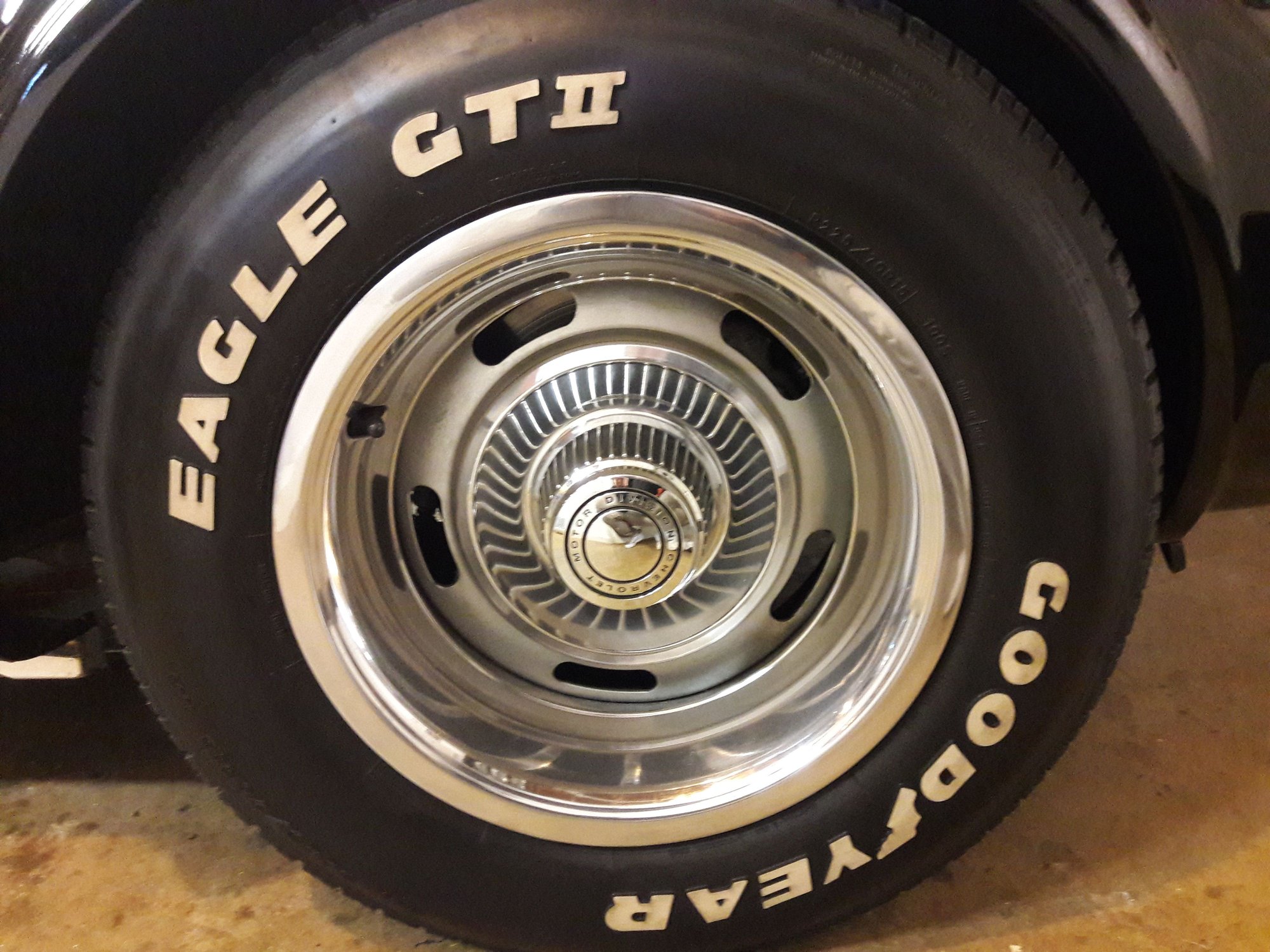

Old Oct 26, 2017 | 11:07 AM

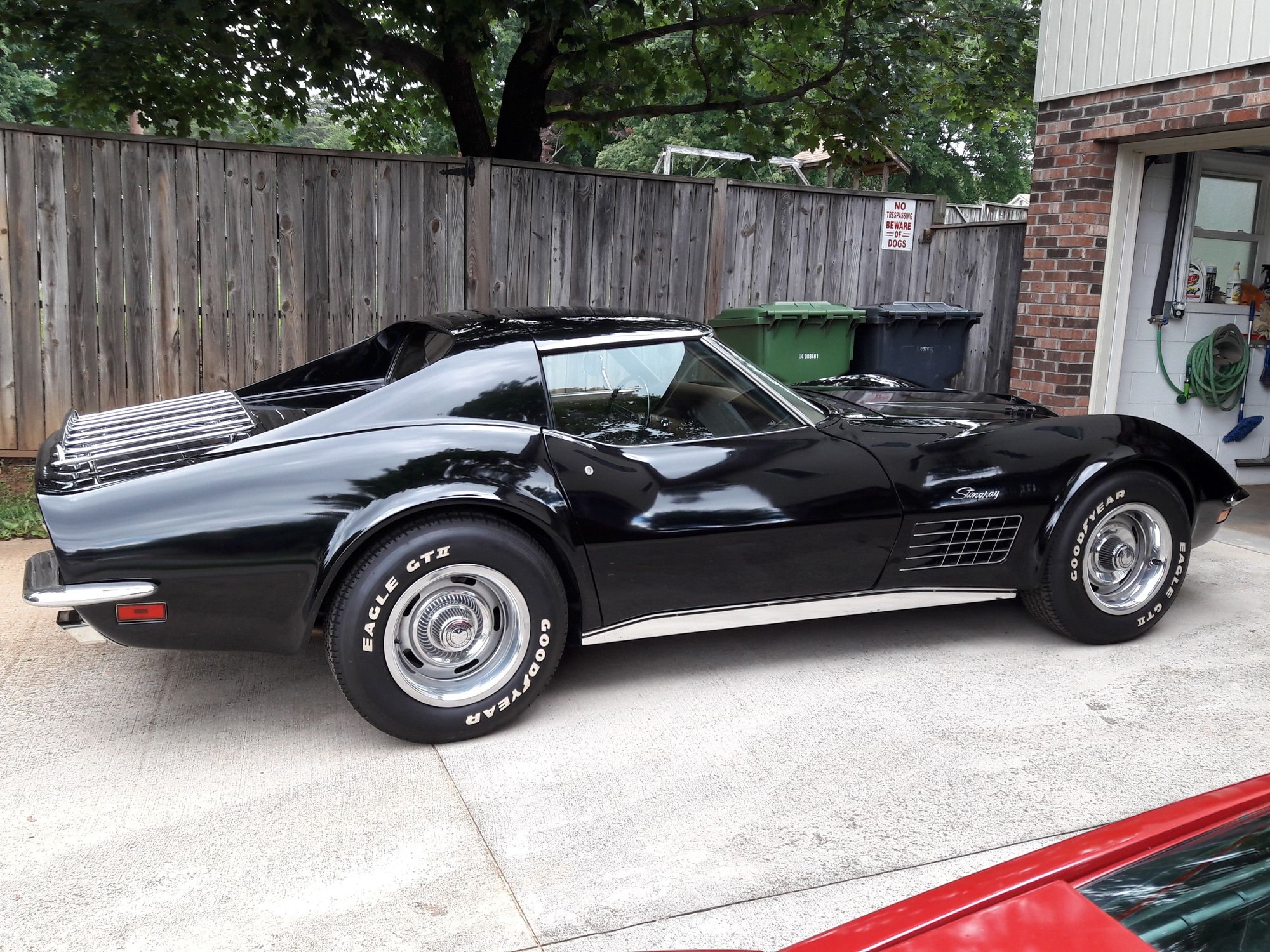

Originally Posted by Eric -
Nice car. It would be a shame to have a 20 year old tire let go and shred a fender.

I bet there's no date code on these, like my old ones. They look good but I'd replace!
