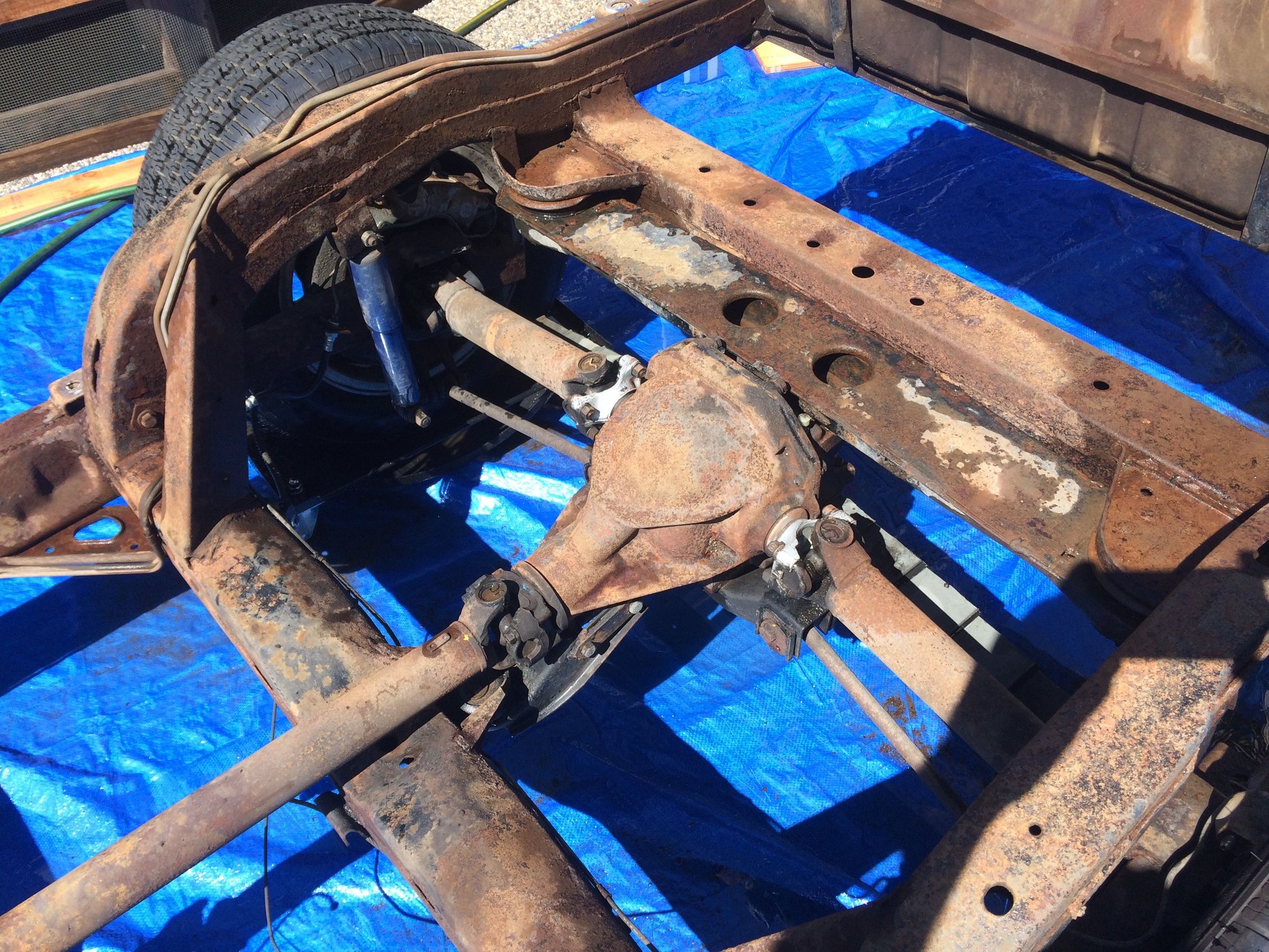

I found that the rear crossmember is welded to the frame.
Has anyone done it? What are the drawbacks of having it like this?

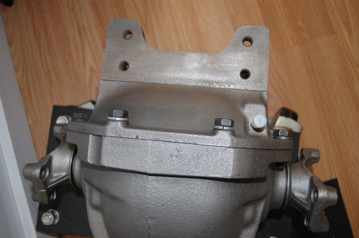

Hi,
If the cross-member is welded in place the only access to the 4 bolts that mount the rear differential case to the cross-member is by cutting a hole in the floor of the rear compartment.
Some folks may not want to do that.
Regards,
Alan

Hi f,
Typically folks loosen the bolt at each the end of the crossmember and 'drop' the differential and crossmember as a unit…. and then remove the 4 bolts to separate the crossmember from the differential.
Regards,
Alan

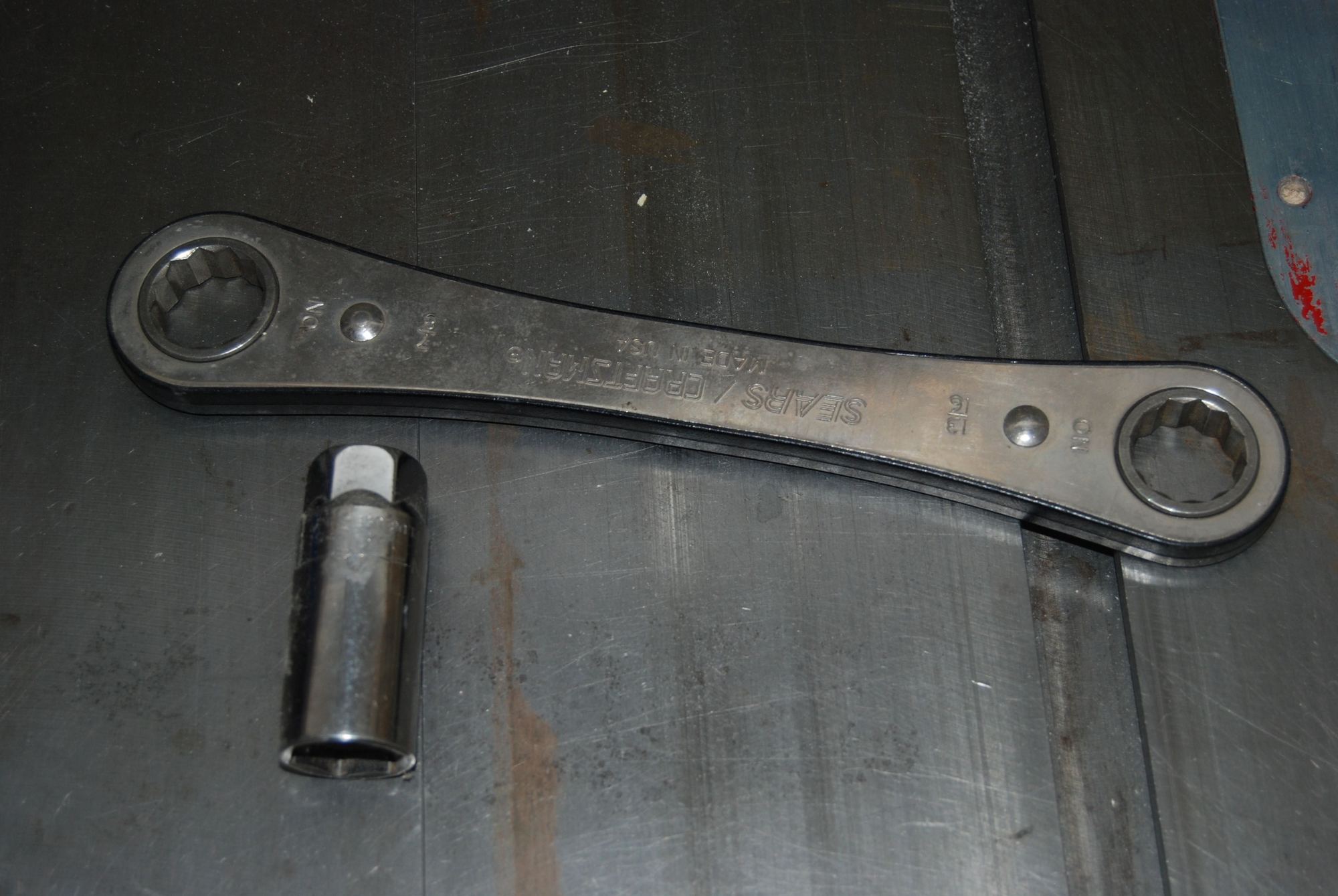

There's another way Alan, you just have to be a little creative.
Originally Posted by ignatz
JayRay: I was very leery about the crossmember bushings being badly stuck on the frame the first time I had to drop the differential and came up with this method, which I have posted before.
An alternative method to get the differential out without removing the crossmember is to use a flat ratcheting wrench and a deep hex socket as shown. See below. This just fits the narrow gap between the body and the crossmember and you do need to be a little adept with your fingers, etc.
Additionally some long bolts with the heads cut off and loosely held serve to reposition it going back in.
Why might you choose this? Well when I pulled the body off I had to pound on my 45 year old crossmember with a sledge to get it out. These things don't just pop out. And of course going back in you'll want new rubber insulators so that is certainly a consideration, as they also are a bitch to get out. And course if you really really want to change out the bushings, installing the aluminum pancakes is a nice upgrade.
The only real downside is you can't correctly torque the mounting bolts. But in 10 years of hard use, it never loosened on me.

can you provide a picture of this welded rear crossmember just to make sure we are all talking about the same thing?
Old Nov 22, 2017 | 07:17 PM
fede's Avatar
fede
Joined: Jun 2016
Posts: 119
Likes: 5
From: Spain
Sure but I only have crappy pictures as usual...

Ah ! so is it the very back one that's now permanent , with the big flat piece of homemade bracing. ?

No, I was referring to the crossmember, the one that the diff bolts too. The beam that looks like it has 2 cup holders in the middle.
According to my brother that thing is welded to the frame.
Old Nov 23, 2017 | 09:06 AM
Alan 71's Avatar
Alan 71
Joined: Sep 2006
Posts: 31,280
Likes: 4,372
From: Westminster Maryland
Hi F,
Typically that cross-member is bolted to the frame with a single bolt at each end.
There's a pocket and a large rubber bushing.
When in place the cross-member could well look like it's welded in place.
Even with the bolts removed often the cross-member won't release. Typically a large 'pry' bar is needed to break the cross-member loose.
Might your cross-member be 'stuck' in place?
Regards,
Alan

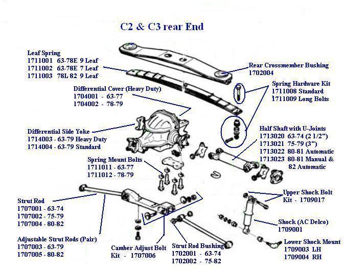

can you provide a side view picture identical to the last one in the previous post from Alan 71?

Here is a diagram of the cross member assembly.
Hope it helps.
1970 Crossmember
1970 Crossmember
