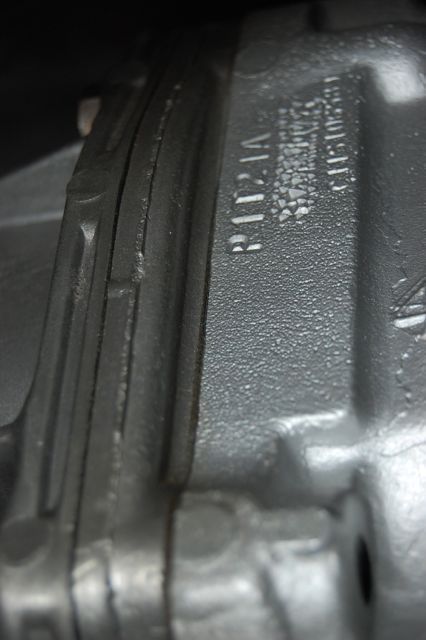

The transmission is stamped on the side of the main case's flange.
There are typically 2 stamps.
The first was done when the transmission was assembled and will indicate when it was built and in what configuration.
The second was done at the assembly plant, ( St.Louis for Corvettes), and indicates what vehicle the transmission was first installed in.
Regards,
Alan
I think there are some signs in the engine compartment and in the interior that are pretty good indicators if the car was originally equipped with the a/c option when it left St.Louis.
The stamps on the side of the transmission case.
