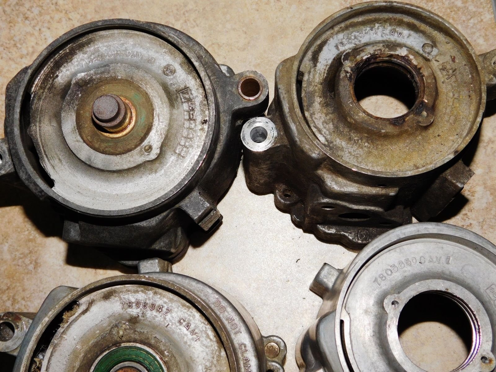

The attached explanation for interpreting date stamps on pump bodies is really all a person needs to read the date and match a pump body to their car, but there is more to it if anyone cares. The numbers 7801149 and 7817872 are Not the (part or casting) number for the pumps, but are simply the casting number for the bolt on back of the pump body. The pumps themselves have their own casting number that can only be seen when the fan is removed. Here are 4 pump bodies with 3 different casting numbers. 2 are corvette (78 & 68) and 2 are Cadillac (69 & 72 same casting numbers). The 3 different cast # bodies would bolt on the same way, but the case configuration, relief valve or none and case machining are all different.
The Cadillac pump bodies are very similar to early corvette pump bodies, but do have a slight casting difference on the side where they were machined to mount the diverter valves direct with no elbow where the '68 corvette pump body was machined to accept a relief valve in that area and the '77 corvette (different casting) had no relief valve since the diverter valve acted as the relief.
The back cases also were machined differently for other model cars.
Also, the Cadillac stamps do not have a letter at the end. The other 2 have the S. I have an early Camaro pump with a Z.

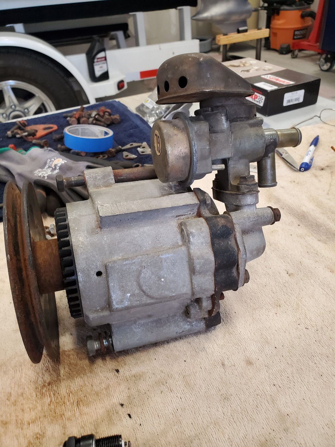

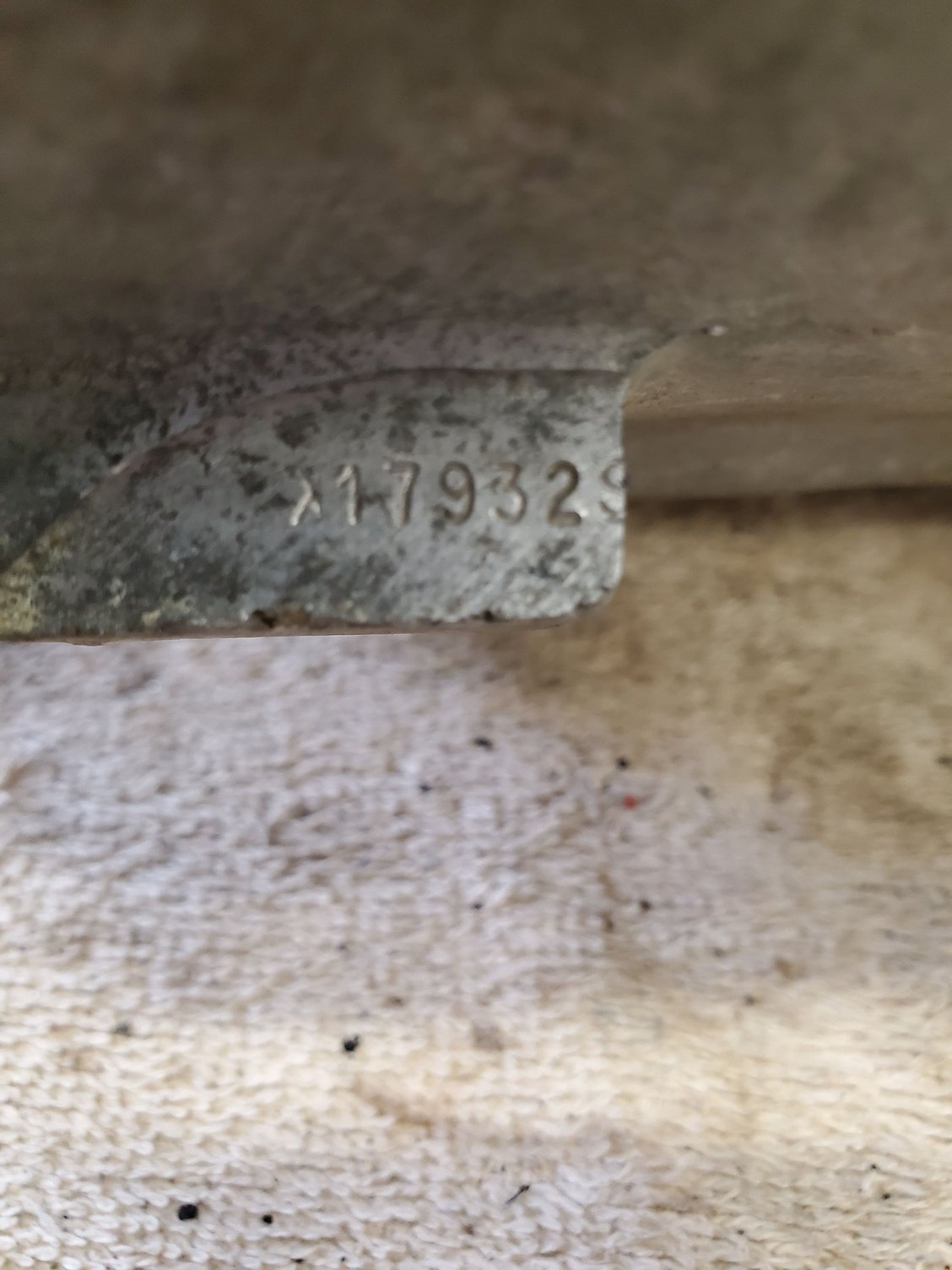

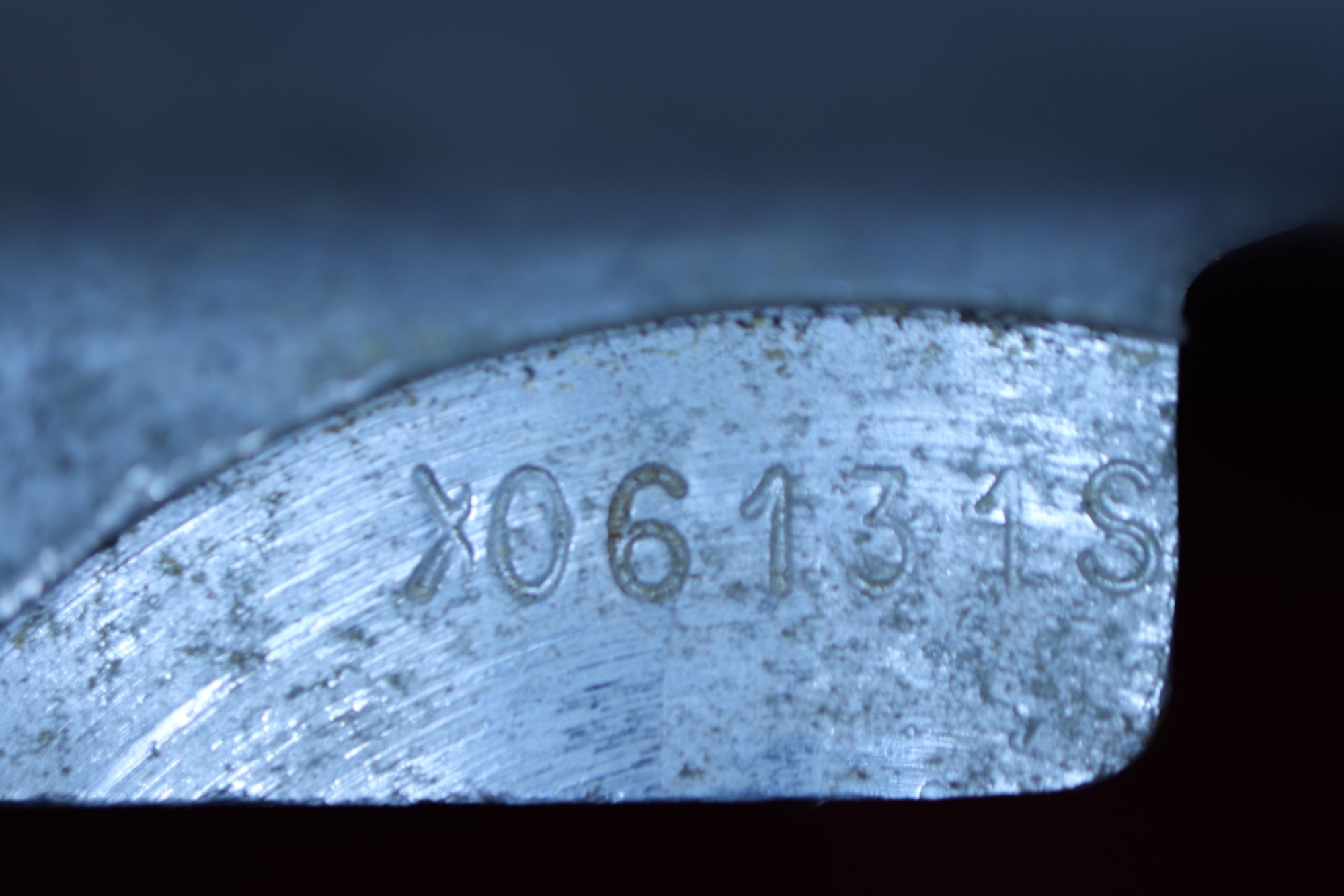

i know this is an older thread, I have a small block pump with this on it, can someone decipher it
Old Jan 29, 2021 | 08:35 AM
toylman's Avatar
toylman
Joined: Dec 2006
Posts: 979
Likes: 254
From: Bethlehem, PA
See if the top of your pump case looks like the one in this picture. If so, it is probably the 179th day of 1973.

That pump came of a Vega!
the one I posted ? you can see a partial S........I thought that meant Corvette ?

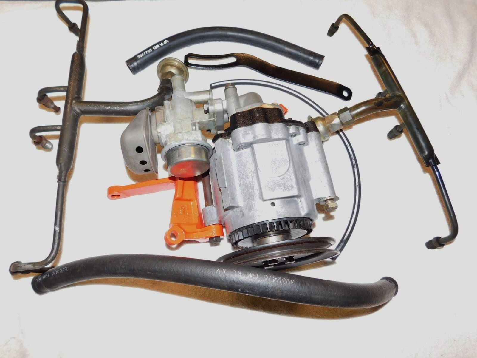

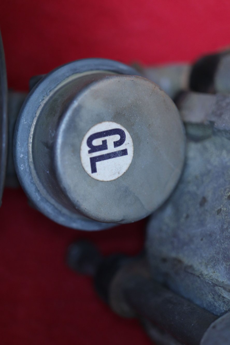

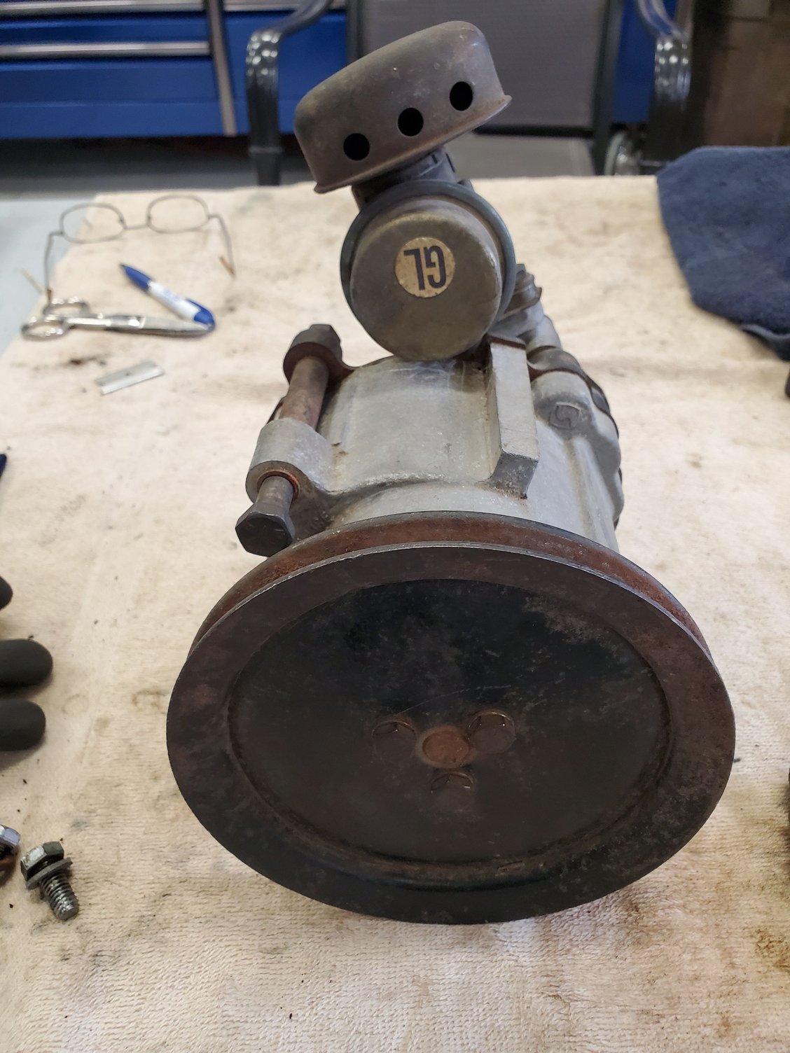

I agree with toylman.......179th day of 1973 or June 28. The GL broadcast code on your diverter valve is correct for a '73 as well.
Attached are pics of the AIR Pump and Diverter Valve from my'73 L-82/M-20, removed in 1974
1973 AIR Pump and Diverter Valve, removed in 1974
1973 AIR Pump stamp 61st day of 1973 or March 2 1973. Body build date is H23 or March 23
1973 Diverter Valve

If there is a first letter, it is for the assembly line. The next three numbers are Julian date; the fourth number is the last digit of the year; fifth number is the shift, and the last letter shows the model of the pump. Pumps built early in the year have been seen containing no zeros at the beginning of the Julian date. For this reason, sometimes there are not five numbers in the stamping.

The "S" stands for Saginaw
The Saginaw Division of General Motors manufactured the air pumps used on all domestic cars during 1970′s

"If there is a first letter, it is for the assembly line...the last letter shows the model of the pump"
It is possible, but doubtful that that unusual first character stand for the assembly line. You were correct the first time regarding the S in the stamp
"The "S" stands for Saginaw"
The cast S on the case indicates Saginaw, not the S in the stamp as there are other letter that were used besides S
This is from a 2013 NCRS post written by Joe Lucia
The alpha character at the end of the series represents the pump model.
1966-67= "A" (and, possibly, other codes, too)
1968 (GM #7803947 with relief valve)= "Y"
1968 and 1969 L-88/ZL-1 (GM #7806686 with relief valve)= "S"
1969-74 (GM #7803948 no external relief valve)= "S"
1975 (GM #7817575 no external relief valve)= "S"
1976-78 (GM #7817809 no external relief valve; different configuration than 69-75)= "S"
The first 3 digits of the stamped code represent the julian date. The 4th digit represent the last day of the year. The 5th digit may be a shift identifier. The final alpha character is pump model.

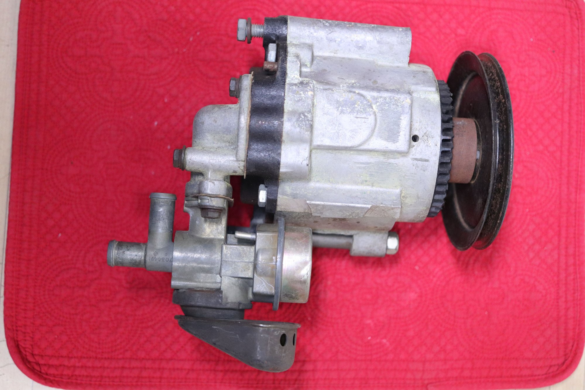

I cant find any stamping in the diverter valve, unless its under where the muffler clips on ?

It is on the flange well below the muffler (or should be), above where it bolts on. I will try to find a picture as an example. The stamping may be faint and hard to see.

This is where the part number should be. I grabbed this picture off the internet.
