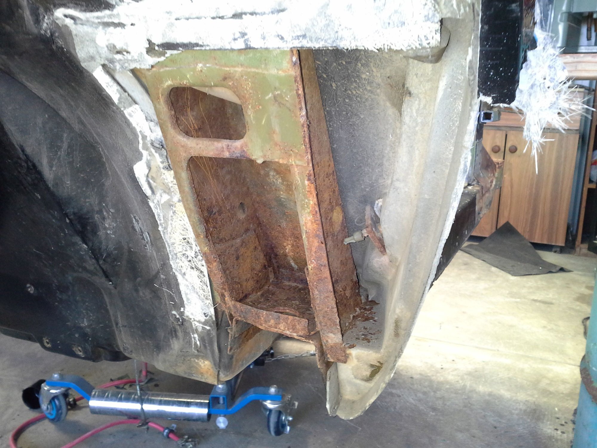

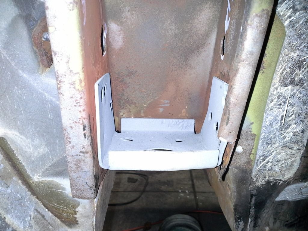

No , my 3rd picture shows the area open , that is a separate panel I unglued with a heat gun , As I said I was lucky the rust didnt go higher . Normally that can be done with out disturbing the rear quarter panel dog leg , I started to take the dog leg off as I'm going to replace that whole quarter panel later anyway (smashed and repaired badly ) .
What I did there gave me access to all the spot welded joins ,
Here's a pic of the back end after I ground out the spot-welded rusty rocker panel and its joiner piece. That is the joiner off the 74 donor sitting in there . I had to cut rusted areas from that pillar to get enough "meat" for it to join onto something
Here's the channel removed , you can see the 4 spot welds (ground out , shiny spots ) on the bottom of the original joiner to channel , there 3 more rows of welds , one on each side , pillar to channel and a front of pillar edge (which bends forward to lay flat on top of the channel , an excellent guide to ensure the new piece goes in properly ) they vary in the amount of spot welds , if you look close you can just see 3 small shiny spots on the right side at the bottom of the pillar that's why I sandblasted to see them more clearly . In reality most had already rusted away on the back side and weren't holding anything.
I have lots more pics if you want to look at some more .
I did the front first and left the back "joiner pieces" in there original position so I could check for fitment of the new piece , here is the new piece trial fitting with clamps ,
I did cut away some of the fibreglass , you can see it in my second pic , just to get enough clearance to weld around the pillar , I wouldn't normally cut so far back but I used the big hole as a guide to help put it back together .
