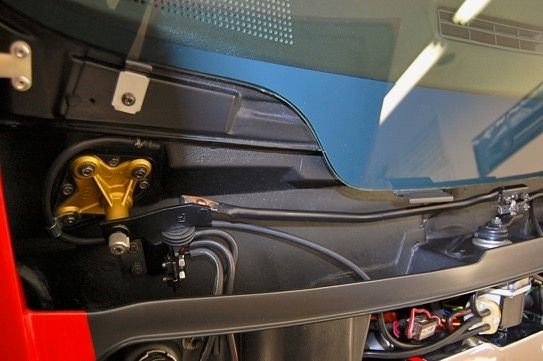

Alan i am looking for any photos of the wiper tray area for restoration of various item in here and the top of the firewall.
Anyone else with good photos are welcome also. Ive been looking but cant find them and i know I've read a few threads on the topic
Thank you

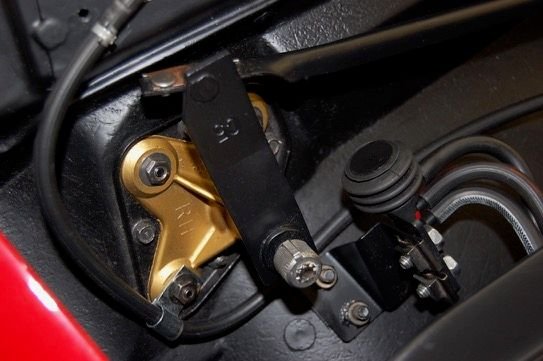

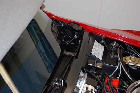

Hi,
The wiper tray area was pretty carelessly done in St.Louis.
That being said:

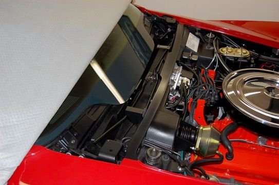

Here are a couple of photos of the tray with the parts in it but no black-out.
This is an interesting appearance but not typical of the way cars were.

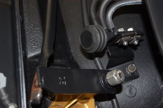

Here are couple of photos of the same tray with black-out on it, so more typical of production.
The application of the various sealers used in this area was much more roughly done than in these photos.
If you need to see something else... please ask!
Regards,
Alan
After Black-out:

Well its not gonna look like that. Very impressive Alan
Thank you again

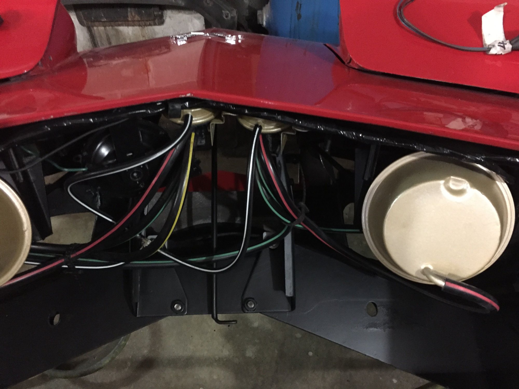

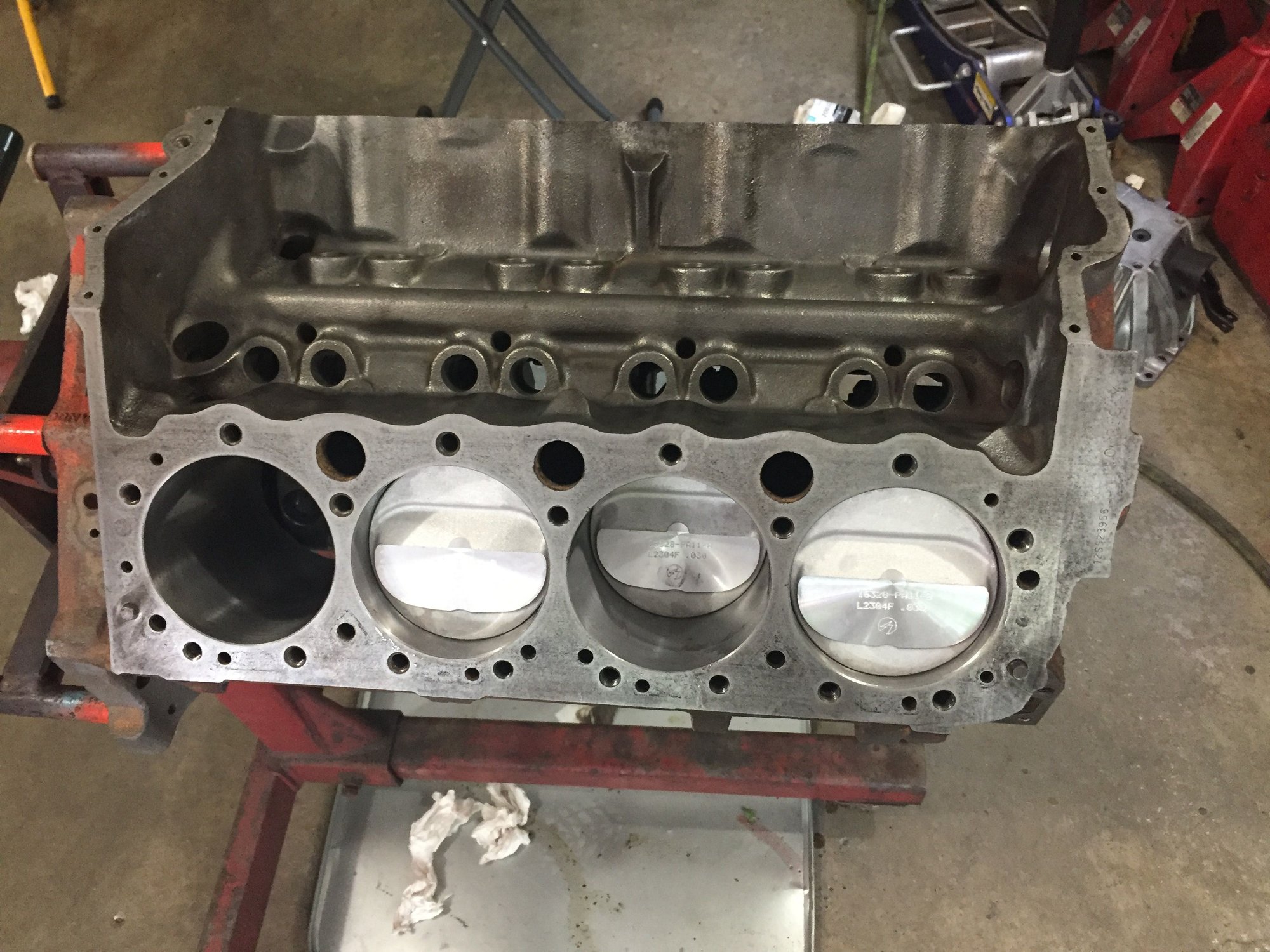

So here is the progress so far... pre paint prep

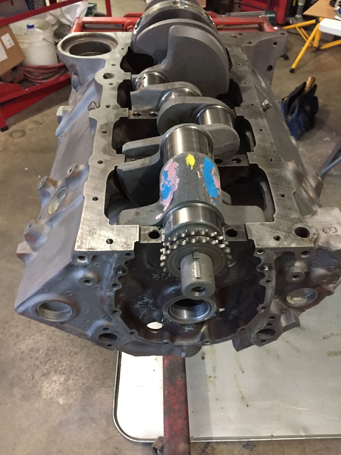

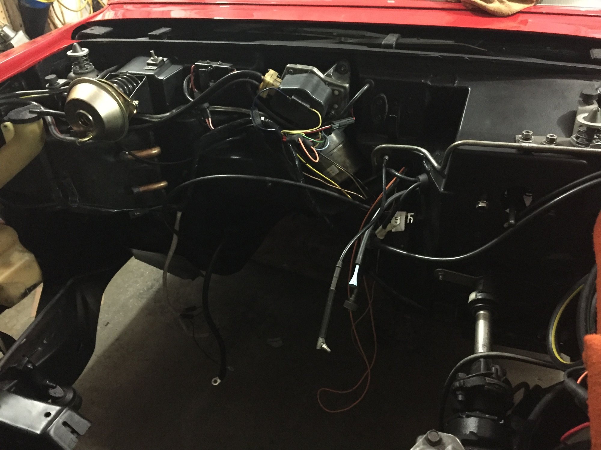

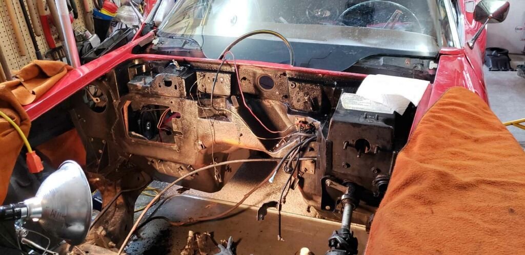

So it's getting there. Working on the shroud support today and got the engine assembly started.
