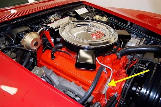

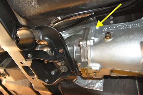

Are you ASKING HOW to determine if the car has it's original parts or saying that it does?
The engine and transmission were stamped with information that will indicate if they indeed were originally installed in this car at the factory in St.Louis.
The engine information is stamped on a small pad on the engine block located in front of the right side head. It consists of 2 stamps; one indicating when the engine was assembled and in what configuration and the other the VIN of the car it was first installed in.
The transmission information is stamped on the side of the transmission. Again there are 2 stamps; one indicating when the transmission was assembled and in what configuration and the other the VN of the car it was first installed in.
Once you find those you can begin to look for the other date and part number information on specific parts.
