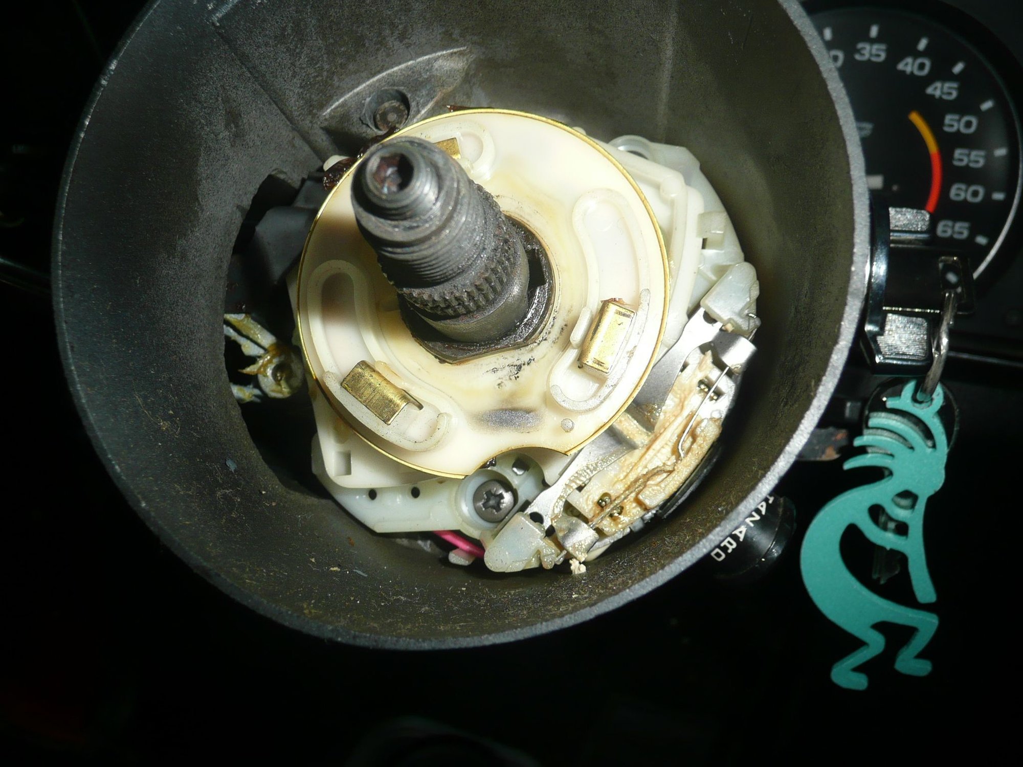

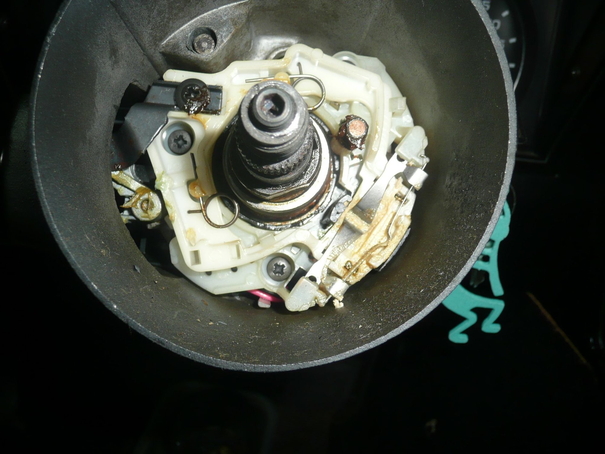

I believe if the steering wheel is not centered going straight, then the cancelling cam is not in the right position. If you turn the wheel straight, will it then "click" into position?
The pictures below show the cam which is below the lock plate. It will only go in one way.

THEN...you need to get it back apart and get it so you are looking at your column like the second photo in POST#7.
THEN...you do not have to totally remove the turn signal switch...but at least get it up and away so you can manually check and see if it will lock in place WITHOUT it being installed.
I KNOW this may seem pointless..but I HAVE encountered some turn signal switches that did just that. I could manually work them in my hand BUT when I installed it some of the plastic of the switch was causing a problem in one of the directions that I was moving the turn signal level it would not engage.
I would really look close at the motion of your switch for the direction DOES engage and lock in place and then see what is happening when you go into the opposite direction.

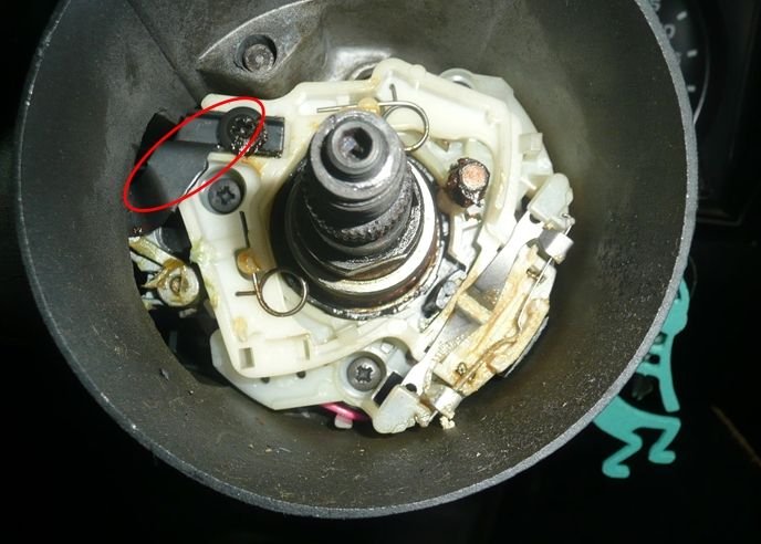

I was just dealing with this same issue. I had no driver side rear turn signal with my old switch, and it also would lock right, but not left. Additionally, it took a lot of force on the stalk to move it, and a pretty heavy yank to get it to lock right. I confirmed that a new switch plugged into the harmonica did indeed cure the issue with the driver side rear, so I proceeded to swap out the switch assembly.
Of course I tested the newly installed switch as soon as I screwed it in, and all was good. I then attached the arm that connects the switch to the stalk, and tested that. Still a little stiff, but it operated all the lights and clicked into position left and right. So far so good.
I then reassembled everything, and tested again. The second or third time I went to lock it left, summamabitch ! It wouldn't lock left. So I pulled everything apart again. Looking everything over, I noticed that the linkage in question (circled in red below) flexes a little bit when you move the stalk to the point where it locks into position. I hypothesized that since the stalk had been reefed on repeatedly, it would stand to reason that the linkage could have been twisted a little in the process. I sprayed the piece connected to the stalk down with PB Blaster, and cleaned it out as best I could, then used two crescent wrenches to bend the linkage slightly inward at the end that mates with the stalk, slathered that end in grease, and reinstalled it. After that, the stalk moves a little more freely, and locks into both left and right.
I put everything back together again, and all seems well with it. So far anyway.
On a related note, I haven't seen anyone mention it, but I had to wrestle the lock plate retainer into place manually both times I reinstalled the lock plate. Maybe I'm missing something, but I don't see any place to lock the shaft in place, and on my column (tilt only), when the lock plate retainer is out, you can pull the center shaft right out of the outer one. The inner shaft just slips in with a keyway to mate the two.
*edit - I was mistaken about the lock plate retainer. That does keep the inner potrion from sliding clear out of the outer, but It's the star shaped bolt that locks the inner portion in place. I noticed that when I had to pull the wheel back off this afternoon to line it up straight.

I have the exact same problem on my 79, and have taken mine apart down to the circled screw more than once, readjusted and the left turn signal would lock, for a while, but it's always stopped working again after some time. Looks like it's time to go back into it again.
