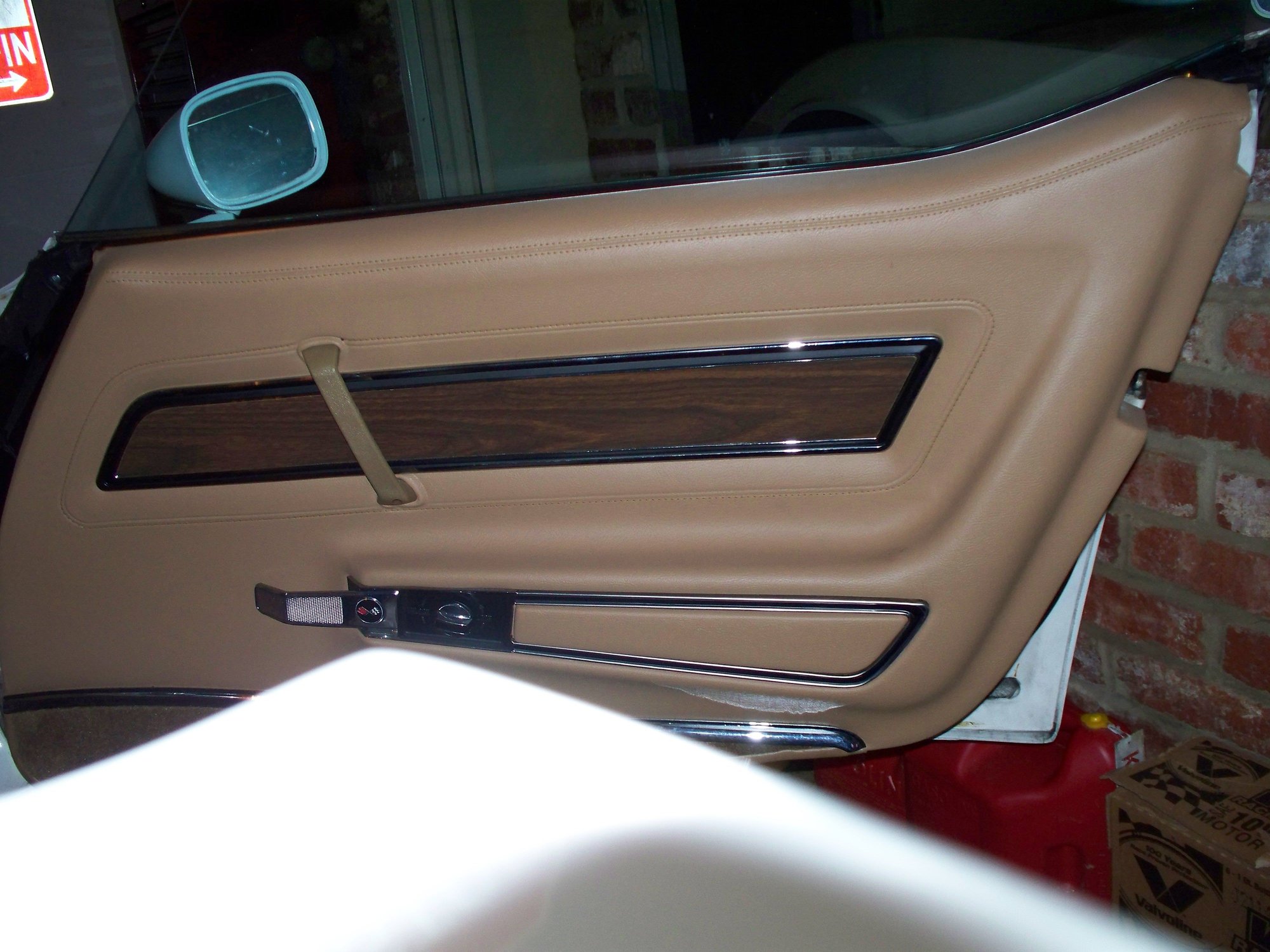

Here's a picture of mine.

Yeah I think I'm going to leave them off for now, I kinda like the cleaner look (just me).
