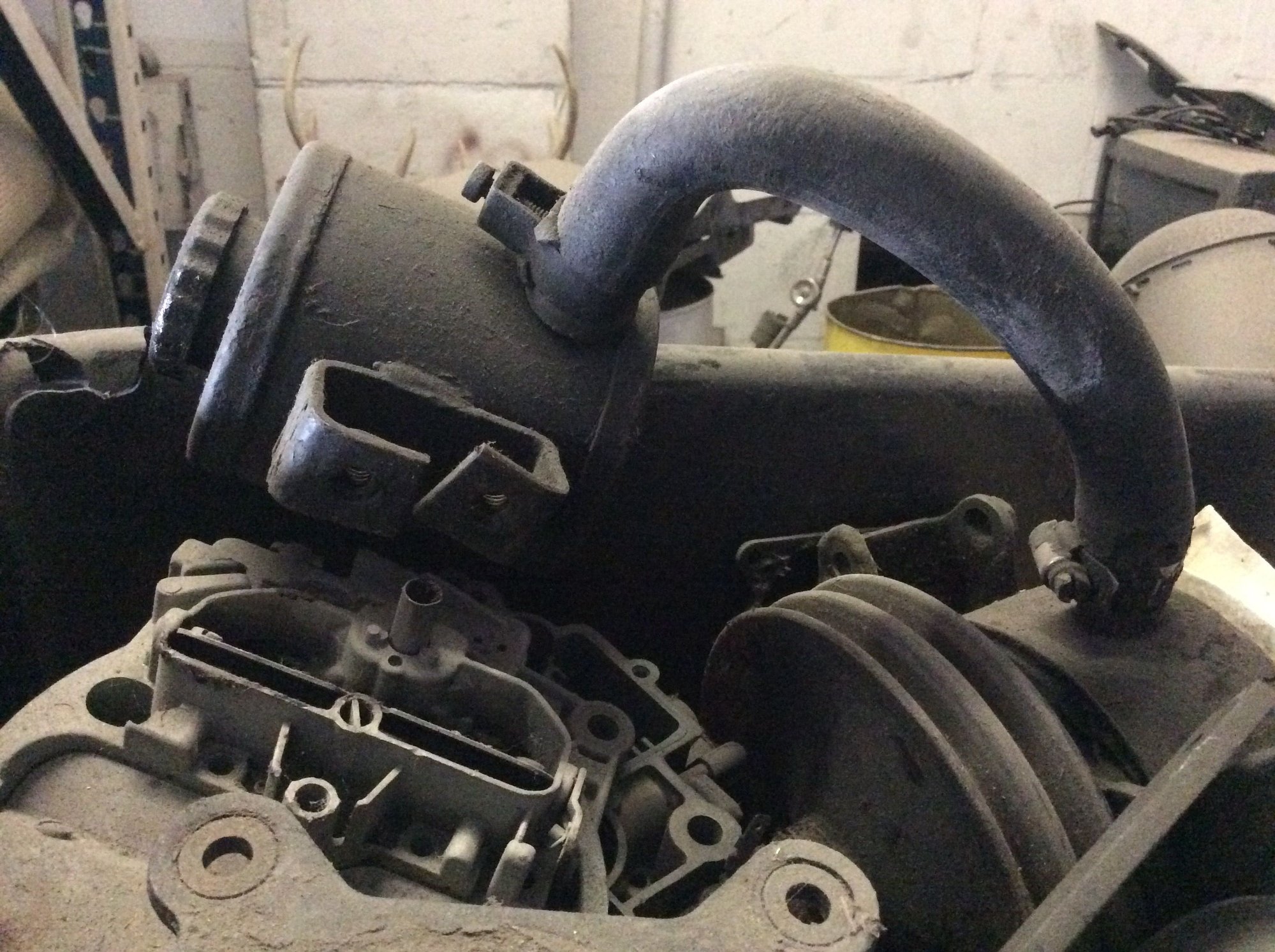

As soon as I get a chance I'll take a pic of a reservoir that I have that just might work for you and David ! If so I'll pack it up and send it to you !
This came off of a 72 GMC Sierra Grande with a big block !
The pump had no reservoir itself on this and by going to a custom hose shop you could have one built and mount wherever you wish ! I'll send a pic soon!

Got a pic for you of the reservoir still attached to the pump !
