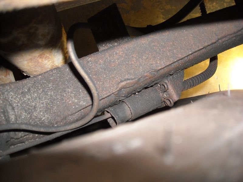

Originally Posted by 69Vett
Not factory bracket weld it is sticking out to far,
those lines on the trailing arms look offset like someone has rewelded this area,
as much corrosion as i see i hope you inspected these arms well before powder coat.
i see it also.
pitting, not smooth, angle seems wrong.
potted. they are old and corroded.

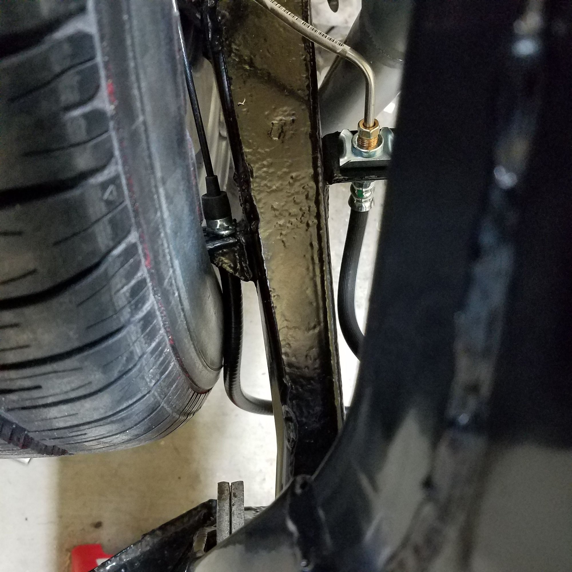

Originally Posted by 68bigblock
Here is a picture of the problem
Why would you powder coat and re-use a trailing arm in this condition when doing a body-off?

Looks like the base of the brake line bracket is not welded flush up against the T arm. Looks like there is 1/4 to 3/8 of weld material between the bracket and the T arm.

Yes these are the original matching wheels. Yes the arm was inspected before blasting and powder coasted. Yes, the entire frame was inspected and placed on computer to make sure we had a straight frame. What I do not know is if the bracket was moved in the past.

The OP didn't have trouble in the past because this new tire is a larger size than he ran before. He ordered them because he'd read other posts where this size, 235/60/15, fit other cars with no problems.
I, too, have the same size BFG's on my '72 but they are on 8" rims. There is absolutely no interference with the parking brake brackets at all. His bracket looks to have been moved/modified by someone in the past.
I was going to say that, too. Someone has welded that on maybe a reinforcing plate or something and it sticks too far out.
