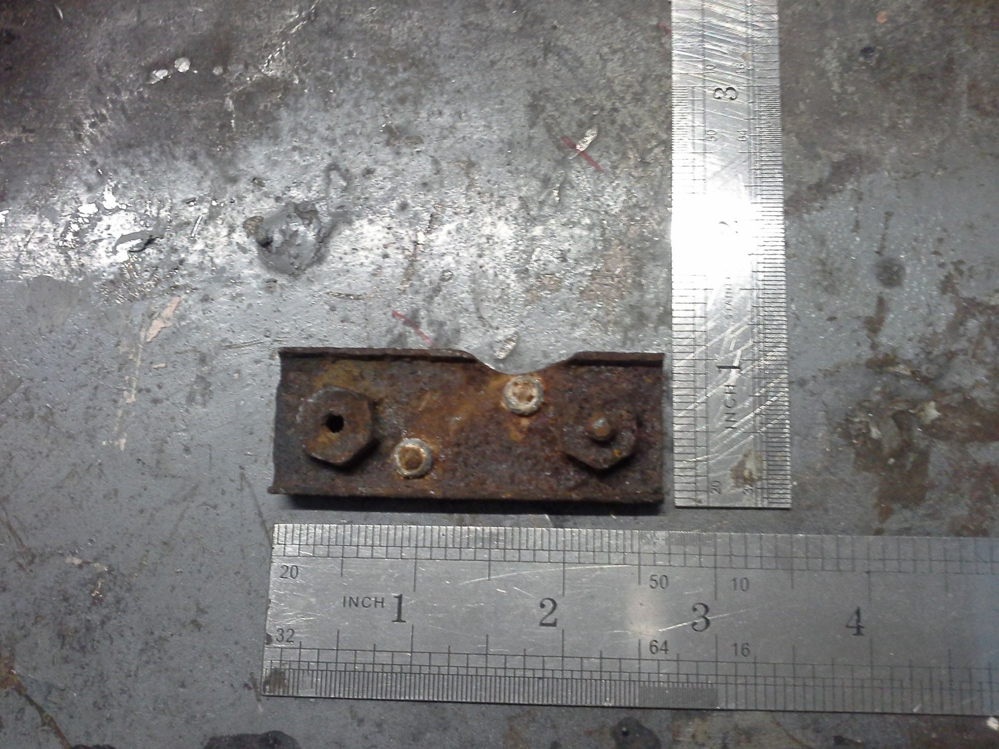

bazza77's Avatar
bazza77
Joined: Jul 2010
Posts: 3,176
Likes: 633
From: perth western australia
this is what fell out that channel of my 77 LH door when I had it stripped and was prepping for paint ,

KenSny's Avatar
KenSny
Joined: Apr 2001
Posts: 3,399
Likes: 278
From: Olmsted Falls, Ohio
The driver's side mirror was mounted with the plate shown by Bazza77 it was attached to the door skin.
If you have a passenger side mirror attached and are going to replace it, be aware that this was ONLY a dealer installed option. This mirror can be mounted with well-nuts thru the skin (no inside plate).
I came across a '75 car a few years ago that was basically a parts car and the driver's side mirror was removed. I made a template of the mounting holes in relation to the front and top of the door for a friend in the same situation you are in .
