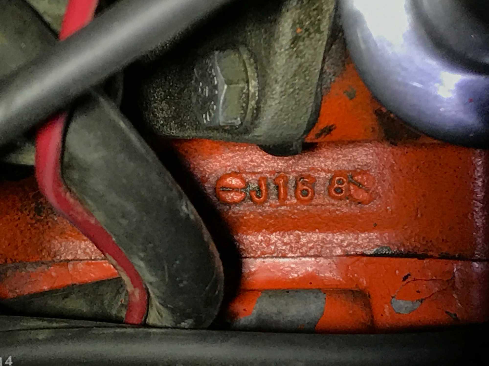

Here's the stamp pad from my 3963512, '69 427. The "0" following "CE" designates 1970 and the following 7XXXX is the Tonawanda built, unit sequence number. The block casting date is "L5 9" (December 1969). The starter mount pad is stamped "T129" (December 1969).

if the pad is blank and nothing is stamped, then that is a sign of a previous block decking from a previous rebuild.. whenever.. maybe decades ago and many owners ago.. then you have to do some further sleuthing and check for the correct broach marks, block casting number, and date casting number.

From: Tampa, Florida
But not always. My block pad isn't stamped and hasn't been decked.

they did not leave the factory unstamped, sorry.
yours most likely was decked in the past.
and would be interrupted as such, by most knowledgeable people.
Way back when, not long after acquiring the car, I posted a pic of the pad. The general consensus was that it probably wasn't decked.
