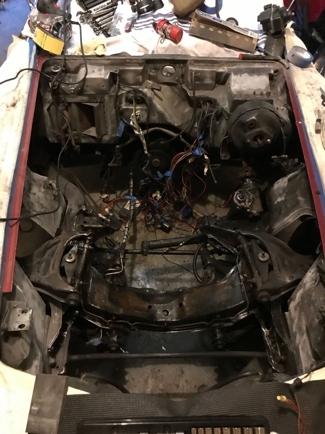

Just a bit more degreasing, pressure spraying, scrubbing, scraping, sanding to go and it will be time to paint. Thinking I'll use some of that anti-rust paint on the frame, but after then what? Acrylic Latex for the firewall? Epoxy based paint? I'm not a purist it's a 77 model resto-mod. I may talk myself into waiting for a frame off option, not enough room now and will be where I at till May or June.

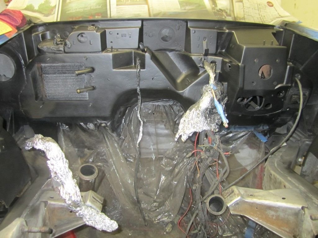

Before
After
I used John deer blitz black on the fiberglass parts and a high gloss VHT chassis paint on the metal parts. And the accessories are powdercoated.

(two above)
Blitz Black on the firewall (frame was done in eastwood chassis paint later on)
M
