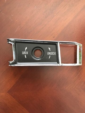

Anyone have any secrets or pointers on how to refinish the black inside this bezel and keep the lettering chrome?

Remove all the old paint (stripper)
Clean it all extra well (laquer thinner, acetone etc)
Paint everything (light coats) with semi-gloss of your choice (krylon, JD-blitz black, etc)
Carefully wipe the dried paint off the tops of the letters off afterwards using a thin cloth (like an old t-shirt) pulled tightly around something like a popsicle stick and a little laquer thinner

Well technically you can skip the stripper part as either lacquer thinner or acetone will remove the old paint quite easily.
My advice would also be once you strip/clean it that you put down a light coat of self-etching primer so that the paint will actually stick to that nice, shiny (slippery) metal.
You have to be VERY careful when cleaning off the paint. From the picture it doesn't look like there is much definition in the reliefs around the text/arrows.
I haven't refinished mine yet. Maybe I will take a walk down to the shop tonight and take a look. Maybe something else will come to me.

I agree with the general process. Remove ALL old paint; clean part VERY well and make sure all detergent/cleaner is removed as well; black paint should be satin black or semi-FLAT type (different mfgrs use different titles for it)...I like John Deere Blitz black spray paint.
When paint is still uncured (15 minutes after spraying), use a sharp X-acto knife to shave the paint off the areas that are to be chrome. DO NOT try to wipe off shavings. Just let them harden...THEN blow/wipe them off.

a new sharp razor blade does a great job

Originally Posted by PainfullySlow
...put down a light coat of self-etching primer...
There's no real need to prime these. Originals were not primed. They need to be squeaky clean before shooting the black.
To each their own I suppose. I know the originals were not primed, and I also know that with age the paint flakes off all of them
For me, I intend on doing this stuff once and the car is not being judged so I feel better with some primer under there. Maybe it is overkill, who can say?

They're done! I removed all the old paint with lacquer thinner and thoroughly cleaned the surface. Then I masked off all the edges and painted the bezel flat black. After drying overnight, I took a 1/4" chisel and slowly and lightly pulled the chisel across the raised letters to remove the paint. I tried to post a pic but for some reason I can't.
