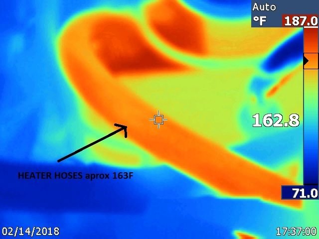

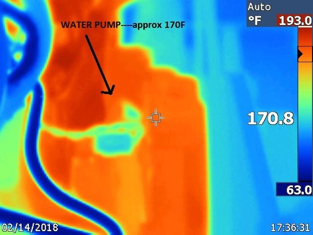

OK, update here, brought thermal gun home and shot car after about 20 min of running, water pump housing about 170F, heater hoses about 160F, so that tells me it is heating up but the gage still reads about 140 maybe, and the oil temp gage reads 110. Can 2 gages be bad or 2 sending units? Have to look at wiring diagram, and see where sensors come from. There are also calibration resistors on back of gages too. Think I will replace the water temp sending unit as it is easiest, versus ripping out dash. Here are pictures of thermal imaging. This is making me crazy, any ideas
