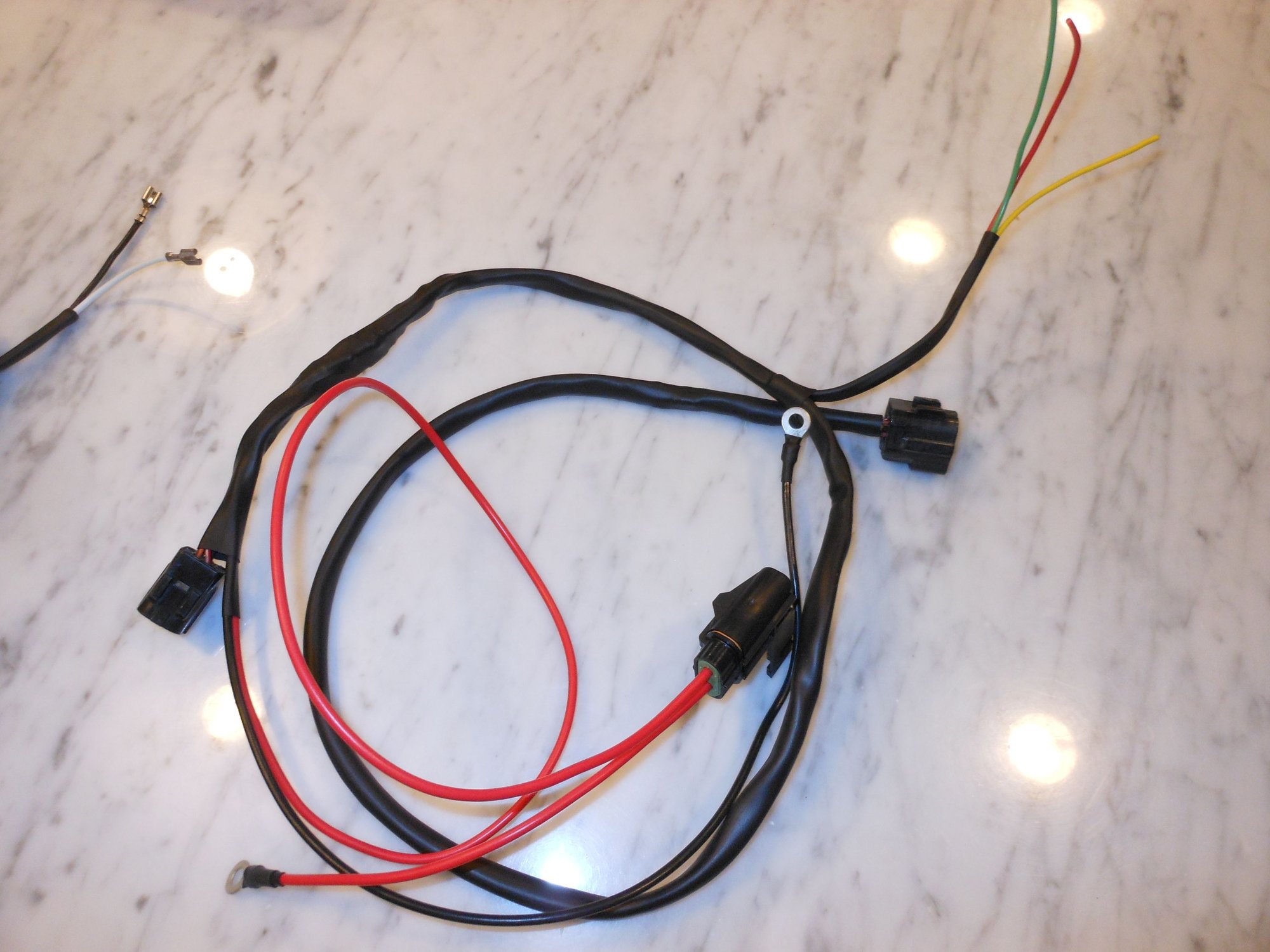

The fuse is to protect the wire from the amp to the battery- that's all it's suppose to do. The amp will have it's own fuse-that's to protect the amp. No real need to add a fuse block- unless you are planning on running several other amps and/or other electronics.
Wire the fuse as close to the battery as possible-
I like these as they are waterproof and minimize connections-
I use them on several different applications- this is a wiring harness for electric headlights-
