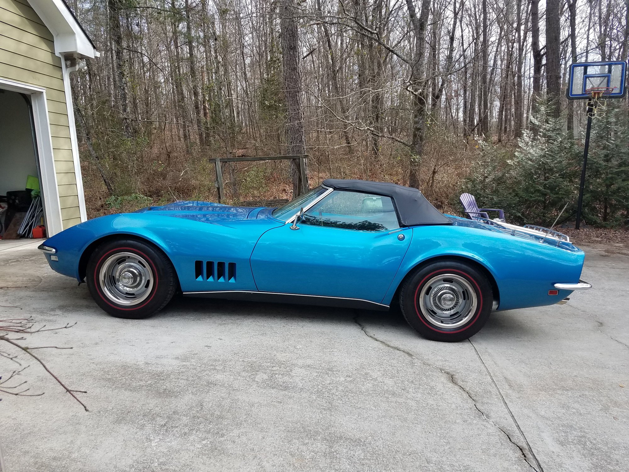

Originally Posted by lvmyvt76
WELCOME to the forum, tell us about your ride!!!
68 L79 Convertible

Sweet ride
