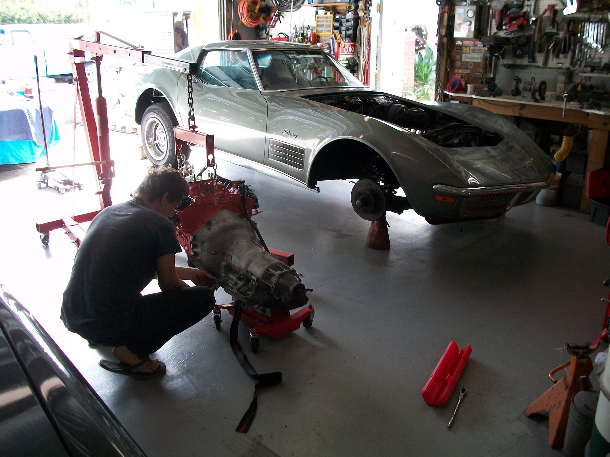

I found a cheater method for extending is standard cherry picker. Most of us have a engine stand the universal type. The piece that goes forward to the front wheels on the engine stand will slide right into the boom on the end of the standard cherry picker. Now you're hanging the engine in front of the front wheels, so you need to add weight to the back of the cherry picker. I usually do this with a boat, it's much more mobile, so changing it to a couple of spare. Big box behind the Hoist is not a problem. But you might need to just stack a bunch of weight on the back arms where the wheels are.

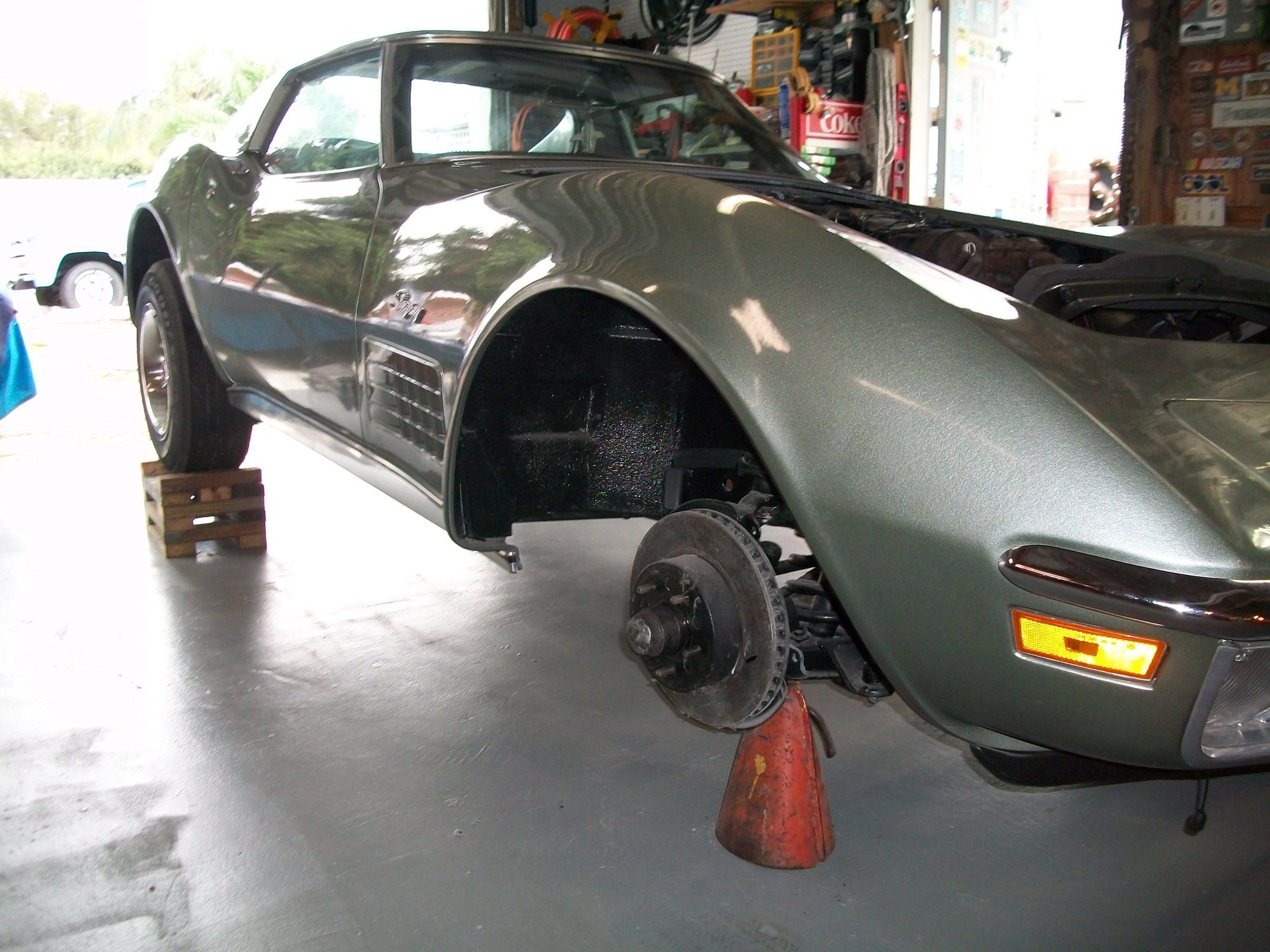

I use the harbor freight 2 ton. From the side with moving blankets on the fender to protect the paint. I use the engine tilted from them as well but you have to improve the handle and grease the crap out of it. I take the front ires off as well to move it around easily
I had it on stands once but use my quick jack now. I can move the car up and down to help when I put the motor in or pull it. I leave the 4 speed in the car and pull the motor and bell housing. But bolt it up as a unit to install it. It's a lot easier to do than try and get the shaft to go in the flywheel bushing.

We also used a Harbor Freight 2 ton, with the right front on a jack stand with tire removed, moving blankets for the fender, and some EXCELLENT advise from fellow forum members, we raised the rear. This changed the angle of the car, let the engine & auto trans slip right in, AND made it easier to get a creeper under it for the trans cross member.
