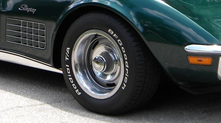

The white letters on my new(1 year+) BF Goodrich tires are turning tan and brown. Does anyone else have this problem? Can they be painted? I have tried tire cleaner and even sanded them lightly with wet/dry sand paper. An internet search shows a lot of complaints with these tires and some people having them replaced with new tires that turn brown shortly after installation.

My research and my experience suggests that "browning" (not just dirty) is caused from either defective materials or from the letters coming in contact with black sidewall from another tire - as you'd get from stacking the tires in storage/transport. These stains are typically permanent. I do have a friend that successfully returned a fairly new set of Cooper tires for staining. Cooper acknowledged a defect and made good on it.
If it's dirt you're dealing with, tire bleach and scrub brush + elbow grease will help. Since I was a kid washing my dad's car, I've used SOS pads with lots of success (and sore fingers at times). If really dirty, you might try a LIGHT application of lacquer thinner, using a WHITE terry towel, wiping only the surface of the individual letters. This must be done very carefully, as the lacquer thinner is actually removing the top surface of the letter/rubber itself. In fact, I've used Q tips instead of the terry towel at times for this project.
Keeping tire letters white is a regular maintenance item. You must stay on top of it. Letting the letters or side wall stripes get really dirty and expecting them to come back to white with infrequent effort will disappoint you in the end.

There has been lots of threads on this, and it is very common. I use Bleche White, brush and water....five minutes later they are white, and stay that way for a couple months....and then you have to do it again. No big deal.

Brown RWL's mean that they are dirty. Either they haven't been cleaned in a while OR because you've been using some petroleum-based "protectant" on them.
Clean them with Westley's "Blech White" cleaner (it's not spelled like normal English) and a scrub brush, then rinse; repeat if needed.
After cleaning, NEVER put a petroleum-based substance on your tires again. They will stay clean longer if you wipe them with a clear polymer protectant like Nu-Vinyl (not NU-Finish) or Meguiar's protectant for plastics.

I've never had a condition where Bleech-Wite didn't clean RWLs. But, if that happens, using a clean rag/cloth with lacquer thinner to wipe them down should clean any 'difficult' material off. And, if that doesn't work, there was something amiss when the tires were made.

If you have the receipts for tires, contact bfg , think they are Michelin now. Anyways, they will put on brand new tires free.
I had 2 tires go brown 6 months after purchase, sent them pictures and receipt, a few weeks later tire shop replaced free of charge.
They actually have a pretty good warranty if you read up on their website.

I will let you in on my top secret way of cleaning BFG.
WD40 with shop paper towel brings them back to white in seconds.
Been doing this for 10 years after trying to scrub with brush and everything else. Try it.

On another thread the problem seams to be with 60 series tires while the 70 series were ok.
From the other forum it is allegedly due to the manufacturing process.
A friends 60 series on his Chevelle lasted 3 months and 200 miles before turning brownish. The 70 series on his corvette are still white.
I have 70 series 2 years old and have no issues..
This is what I've been told...

I have BFG RWL purchased in 2012 in the 70 series.
When they get brownish, I have found it could be brake dust sticking to my Armour all
treatment. I do not put it on the RWL any more just the black walls.
Yes Westley's works amazing. I had what we call Gangster white walls on HD dresser.
The got dirty on almost every trip out.
Rubber gloves, Westley's and a white rag and they looked like new when done.
