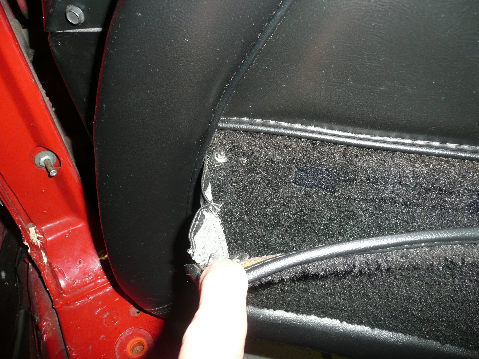

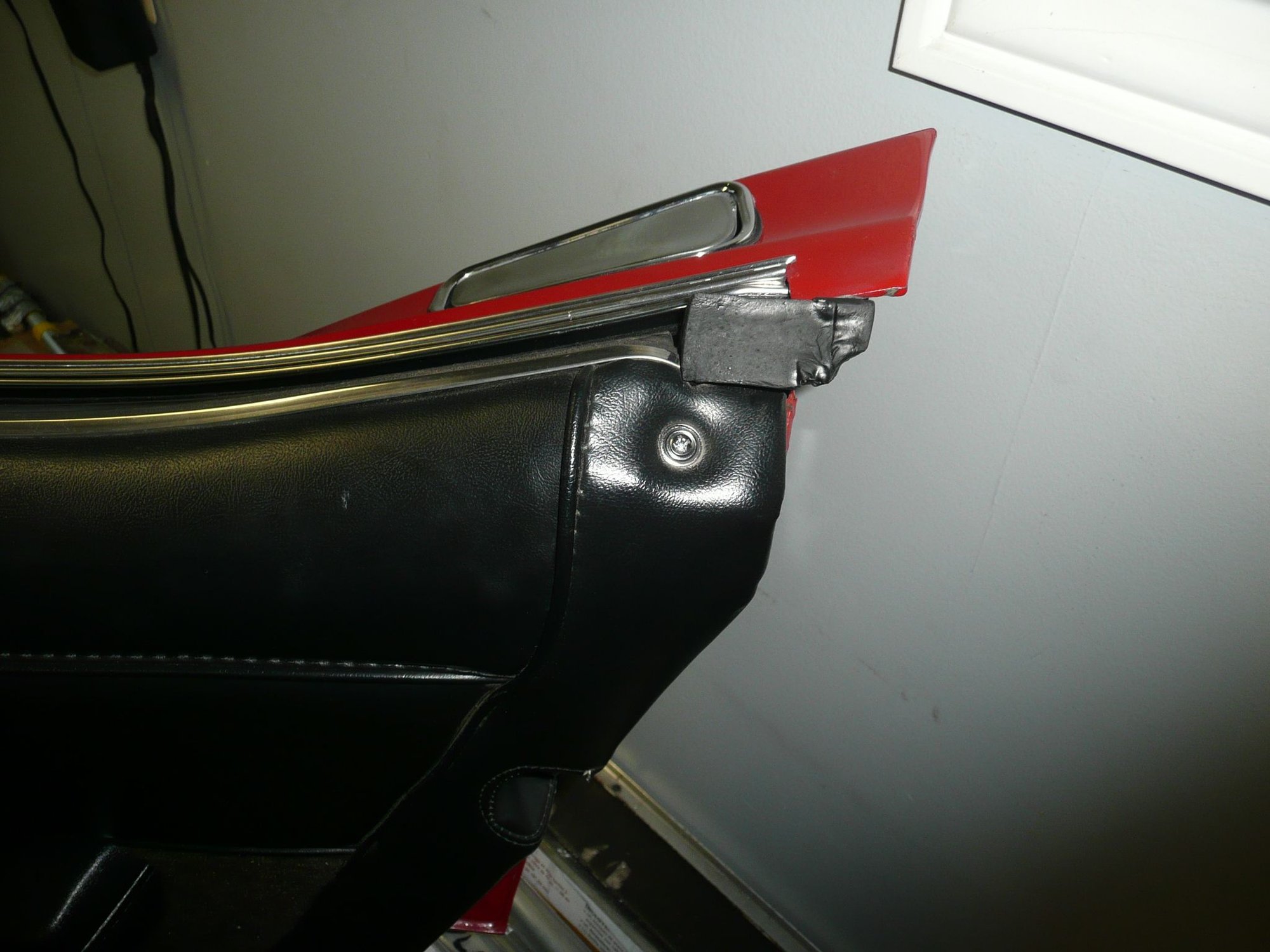

You can see the lower rear in this photo. The lower front is behind the map pocket Toward the front about a 1/2" down.
Hope this helps.

Thanks! So i'm assuming the lower rear is exposed? What about the top? I know one is at the rear but does one go at the top in the front?

There are only 3 screws for the panel. The arm rest and door handle bezel do the rest. The top of the door panel hooks over the top of the door.
