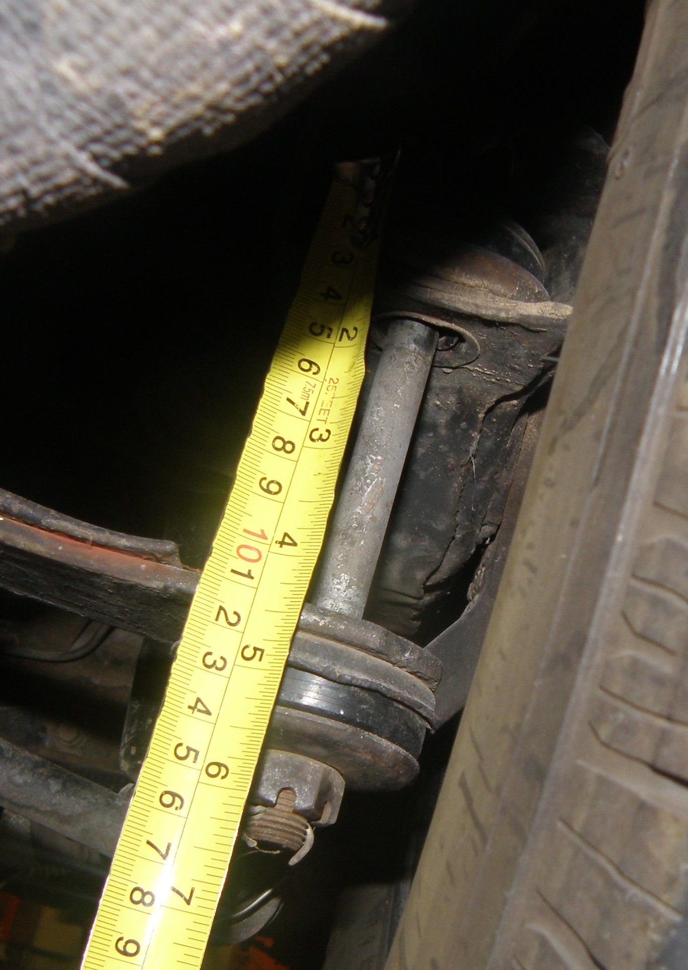

Took some pic's of the bolts.
Front end
I have a question about the number of threads exposed at the top of the attachment. Should their be less of them showing???
Rear end
the bolt is 6 inches. an 8 inch bolt is needed.
And the leaf spring is 9 leafs stock spring. it was suggested it me be sprung causing the difference in ride height from the front end.

The front bolt is a sway bar bolt, has no effect on right height. In the back of a longer bolt will drop the car down as much as you add to the length of the bolt. 27 and 3/4 front and back is the correct on paper right height from ground to wheel well Arch. Maybe just take the small block out and put a big block in up front. That would probably bring it down an inch or so. Now that is a 396 small block correct? Did you buy springs for a 396 big block engine? Because all small blocks weigh within 2 or 3 lb of the same weight. Except maybe a couple of pounds off for Aluminum Intake or aluminum heads could be about 80 pounds lighter but I don't think 80 lb is going to give you an inch and a half of additional height...
