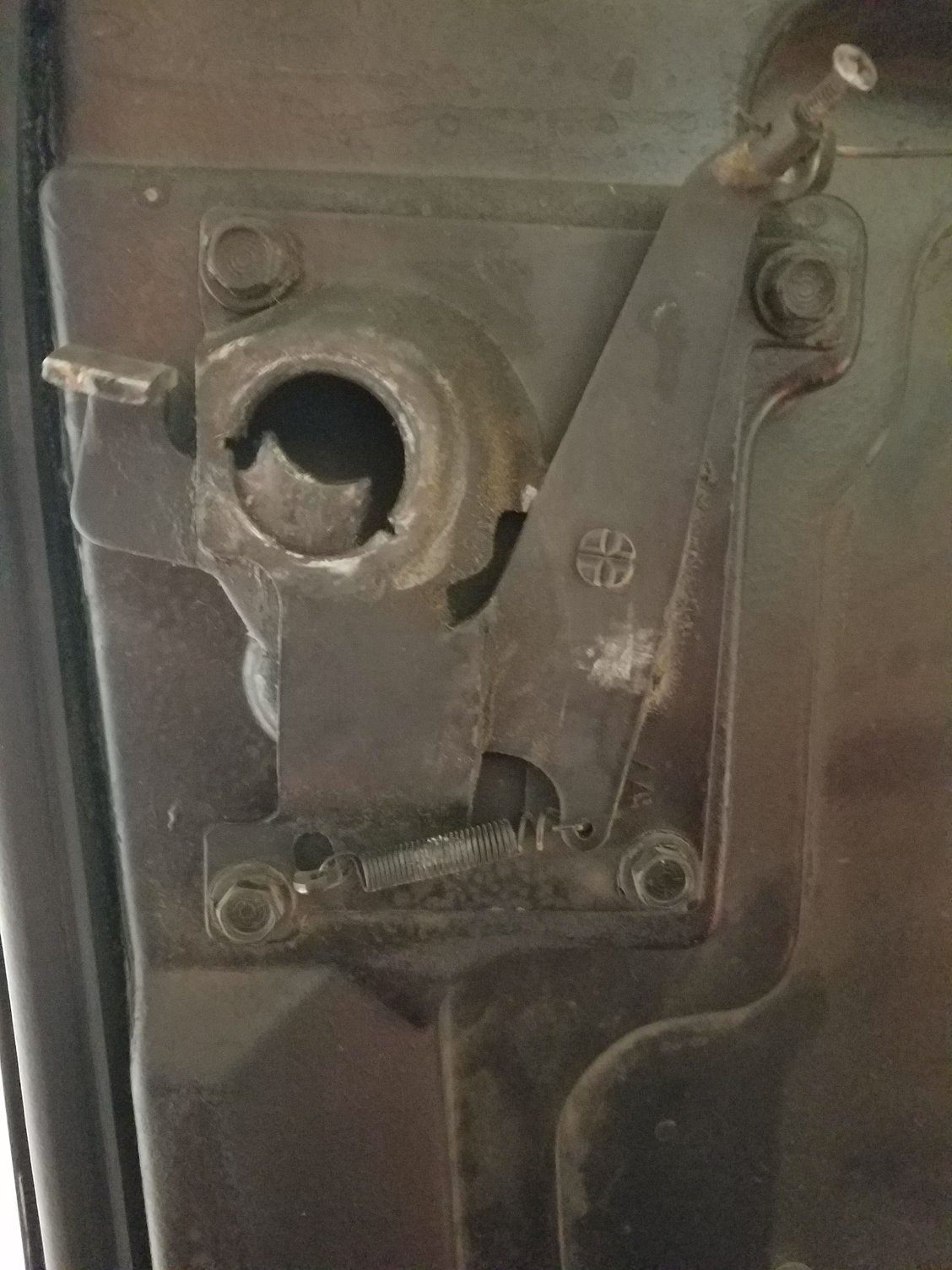

Male or female? I'm not sure what I need. The issue is that the left side of my hood keeps popping open when I hit a mild bump. I was going to replace both the male and female latch parts in an effort to fix the problem.
I understand your answer to say that I can use a left 1969 - 76 latch as long as I use an appropriate male latch part to match the female. Correct?
I have attached a photo of my current latch for clarity.
Thanks for your help!
Alex

Your pic is the female side. Have you checked the alignment of male pin to latch? Is the pin high enough it engages in the latch? You can lubricate this latch and try a bit stronger spring. The one shown look to have lost some pressure.

"The issue is that the left side of my hood keeps popping open when I hit a mild bump. I was going to replace both the male and female latch parts in an effort to fix the problem."
This may very likely be an issue with how the latches are adjusted.
It sounds like the latch on the hood is not fully grasping/seating under the probe on the cowl mounted latch.
The probe could need to be adjusted, or the 'stop' on the cowl latch could need to be adjusted.
Also check that the latch on the hood is fully closing when the cable is released.

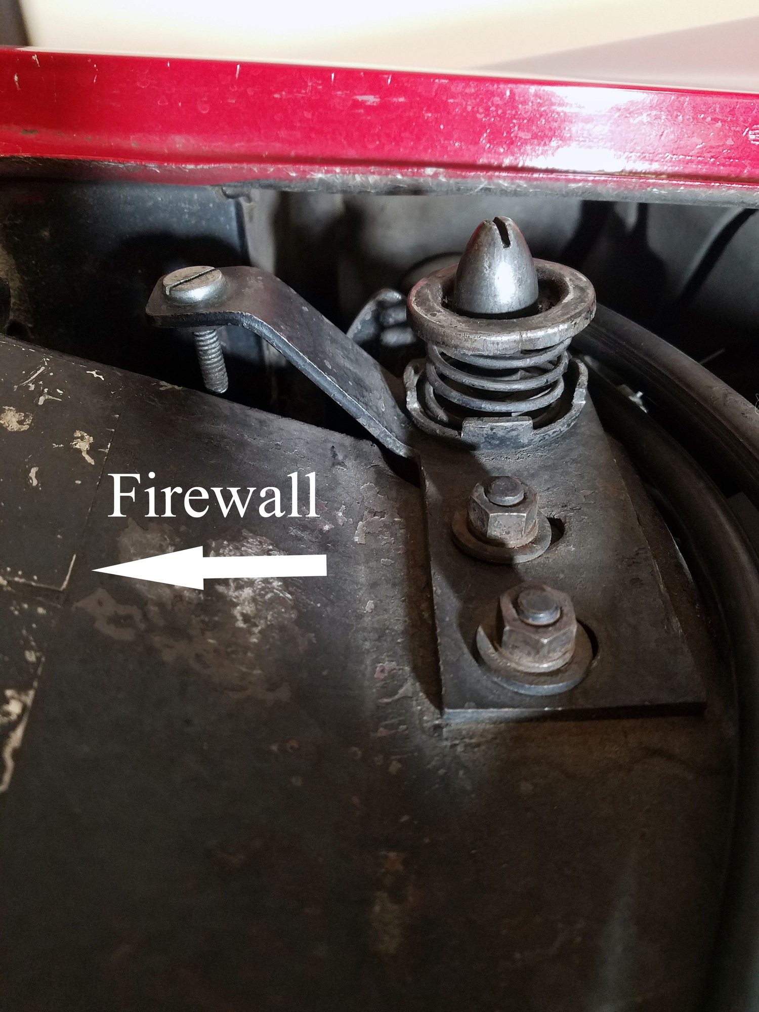

Here is a photo of my male component. Note the "stop" adjustment screw is all the way down. It is this way on both sides. Is it supposed to have a rubber topper like yours?
There is no way the stop is touching the hood at all. Must it?

Both cowl mounted latches should have the adjustment bolt and jam nut with the rubber bumper on them.
As I said earlier, the position (height) of the bumpers determines the fit of the hood compared to the hood surround and wiper bay door.
The fit and gaps on the hood should be set first using the stops. Then the latches can be adjusted so that they open and close easily. (You DON'T want to have to drop the hood from high up to get it to latch fully but neither do you want to pull hard on the hood release handle to get it to open.)
I adjust the latches so that I can lower the hood in place and then apply only very little pressure on the rear corners of the hood to set the latches. When you push down on the hood the ring with the spring under it is being depressed so that lever on the latch on the hood will seat under the probe.
So start by getting the bumpers for the hood stops.
Regards,
Alan

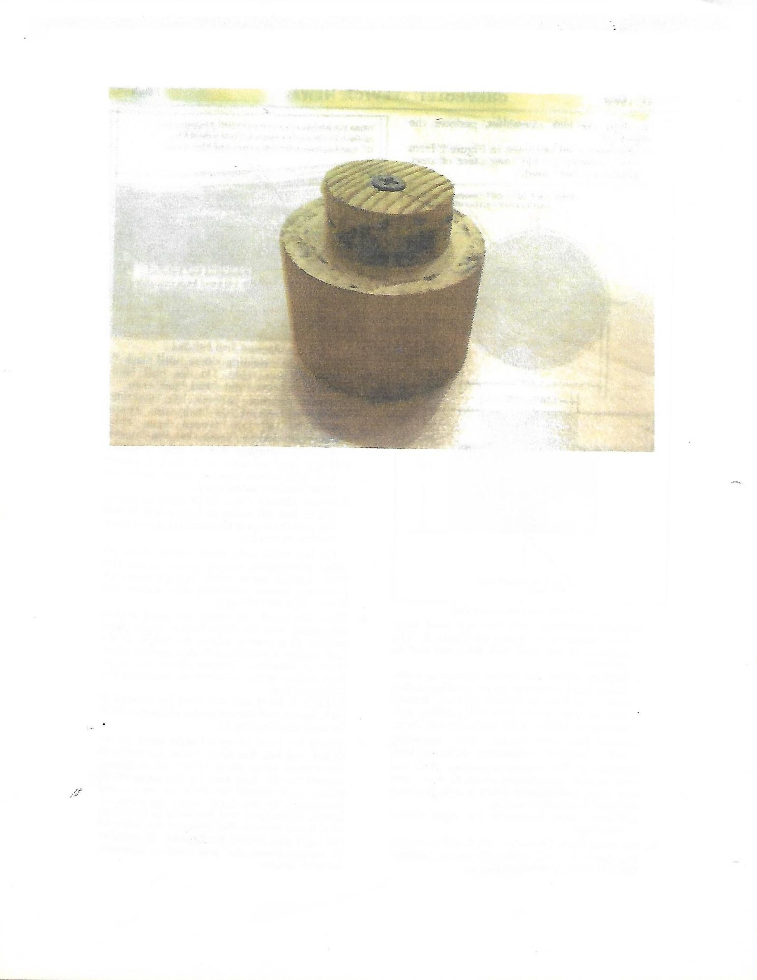

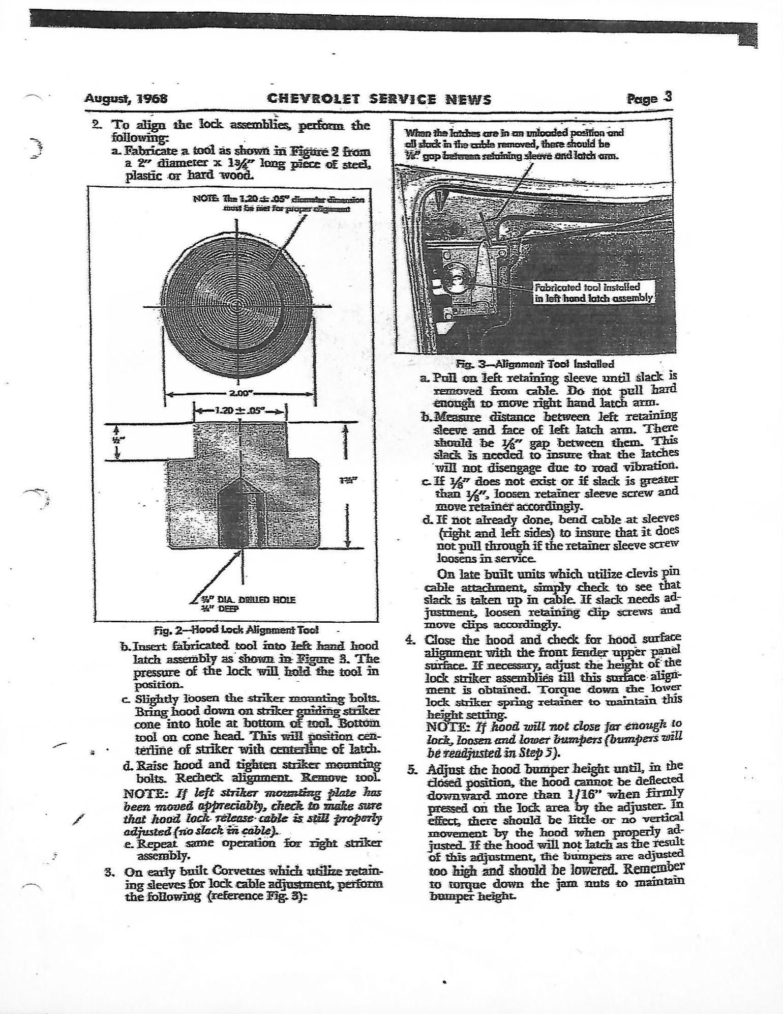

Here are some alignment instructions and a tool.
