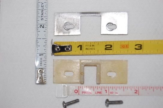

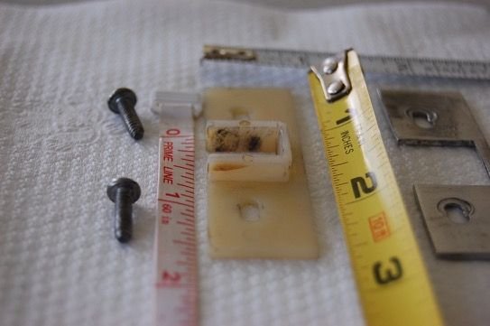

Hi,
Perhaps the screws that mount the receiver bushing and plate in the window sill need to be loosened so the pegs on the bottom of the window frame can move them a bit as the window settles down in to place?
After adjusting the fit and seal of the window those screws could then be tightened again?
Regards,
Alan
I also loosen the screws on the 'pegs' so those can move a bit too when first adjusting the windows.

Hi 68,
Both the aluminum retainers and the nylon bushings should have slotted holes in them which should give you at least SOME adjustment.
On my 71 I need to make certain that the widow is fully 'seated' at the bottom so the top will clear the latches when I push the top of the window in place.
