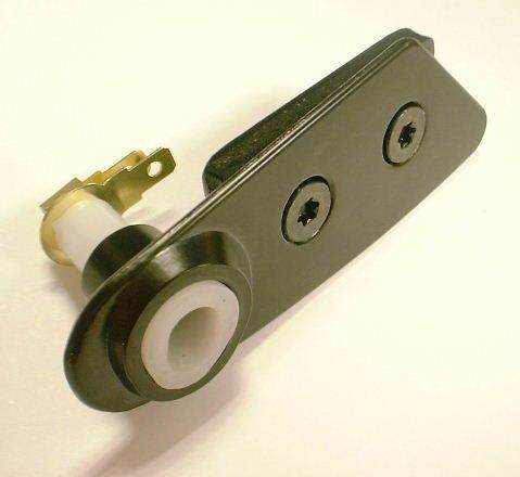

You'd need to remove your triangle pins & plates and replace with a pair of this style
More than one person has said that unscrewing the triangle pin and drilling the threaded hole out will also allow the newer style t-top pin to go in but I've never tried it myself
