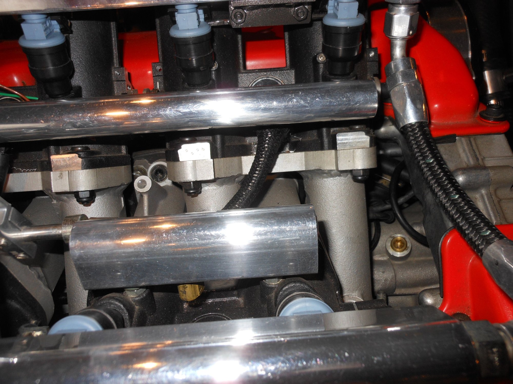

I've used several different things-
On the injector wires-
some split loom - then used some ½ copper pipe - cut up and painted
Also added screens to the velocity stacks-
For the harness running to the headlights- I used SS AN-12 hose- I ended up changing over to the black braided stuff- which is easier to work with.
I bought the expensive stuff for the fuel and oil- and the cheap knock-off stuff off eBay for the wiring-as I'm not worried as much about the hose leaking!!!
The smaller wires- I used the AN-6 black braided hose- lower left-hand corner
For the big wire I use heat shrink and expandable sleeve-
And where I need to protect the wires- I like this stuff- the spiral plastic
To pretty it up the split loom- even use the split loom to cover vacuum lines

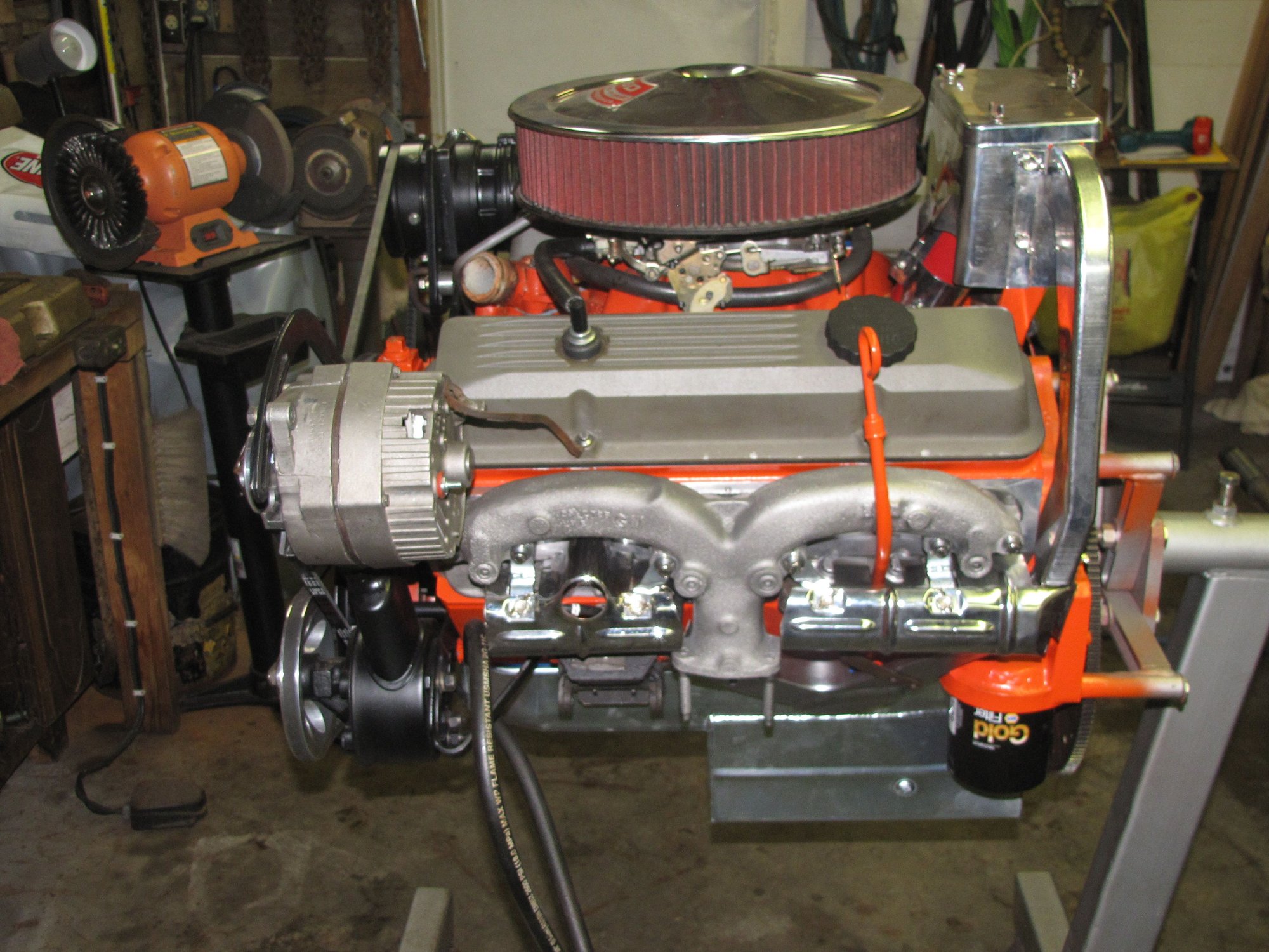

I made some brackets from alu angle (painted black) that I mounted separators to, parallel with the sides of the rocker covers. Sorry, not the best picture.

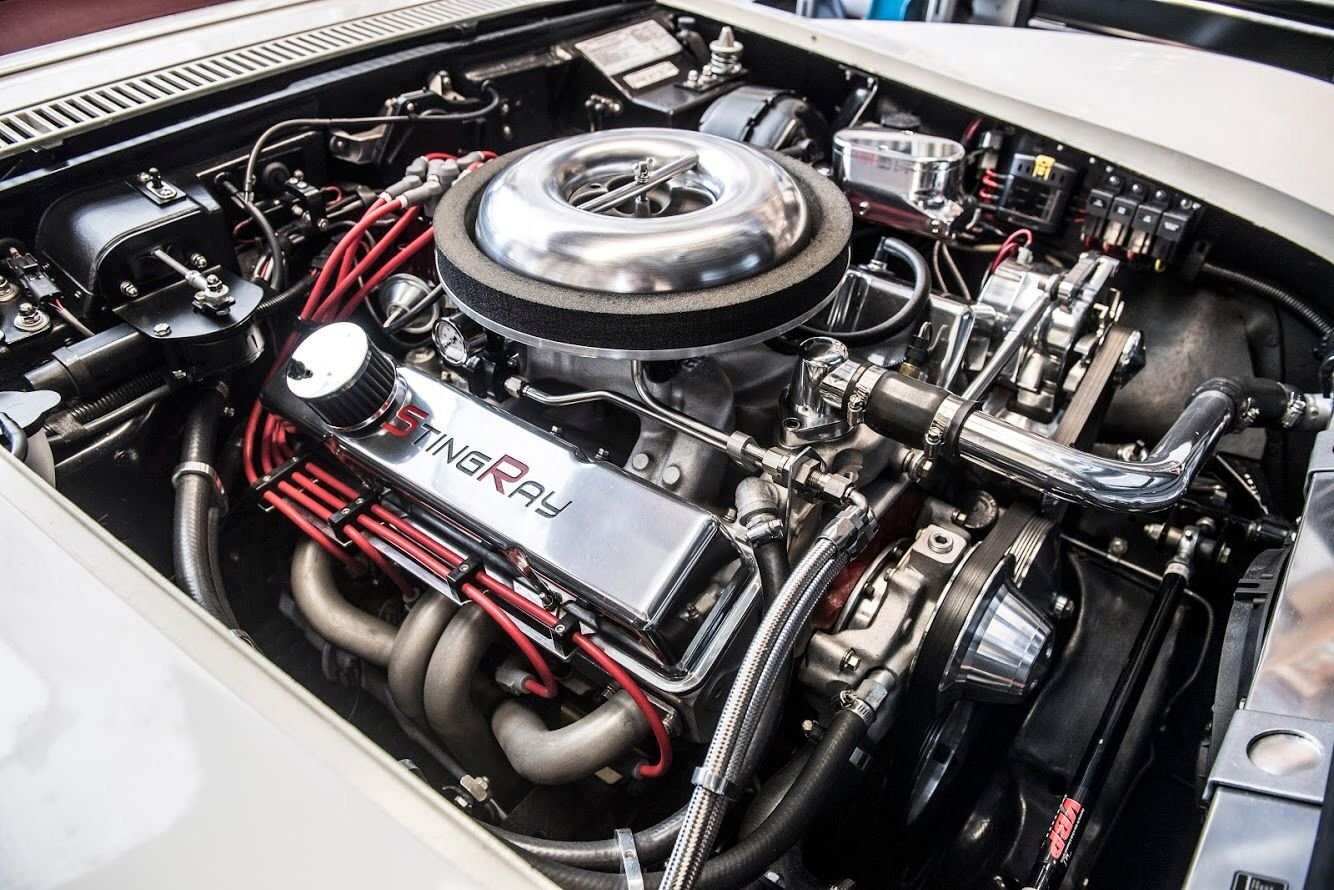

A couple more ways
Moroso
OEM
T
