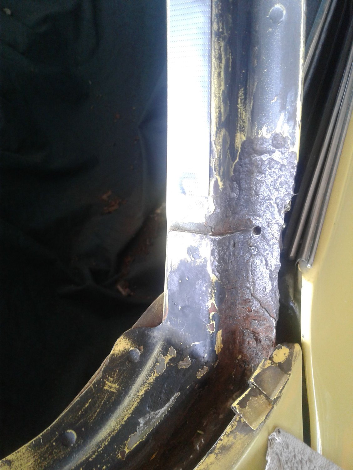

[QUOTE=Novusuhu;1596857192]
I'm scared as hell from frame rust[/jQUOTE]
What makes you think it is not already rusted? I have owned my car for 14 years and was always concerned about those gaps. Ignorance is really bliss, because this is what I found when curiosity got the best of me.

When I removed the interior vinyl under the header, this is what I found.
