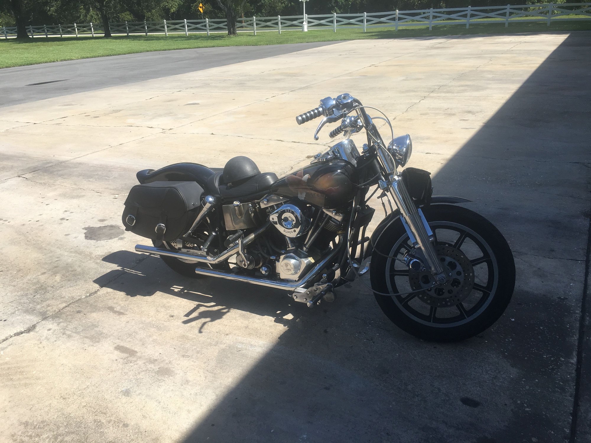

On mine I removed all the rust , then I put a mist coating of Ospho and blew dry with compressed air ! This was only to kill the rust that was forming on the metal from moisture in the air and the metal being exposed!
Then I quickly primed and painted to seal the metal from oxygen so that it wouldn't rust again !
I also have a 77 Harley LowRider that was redone in 2002 that has 0 rust or pits on it to this day ! That frame was sandblasted, sprayed with Ospho too !
