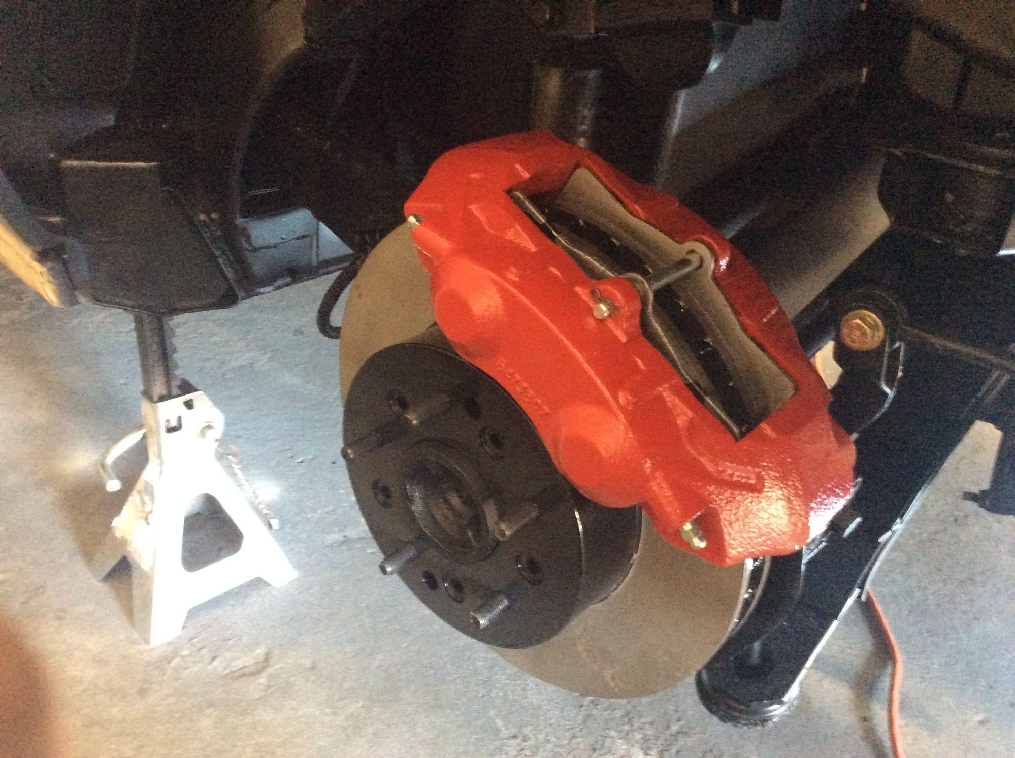

Did mine from back to front ! First step , remove rust !
Second step , spray with Ospho ! Same stuff Chapter 2 was talking about !
Let dry , prime and paint !
Everything was sandblasted! Calipers are new ! Rotors were bead blasted !
It's a slow process but worth it for me !
