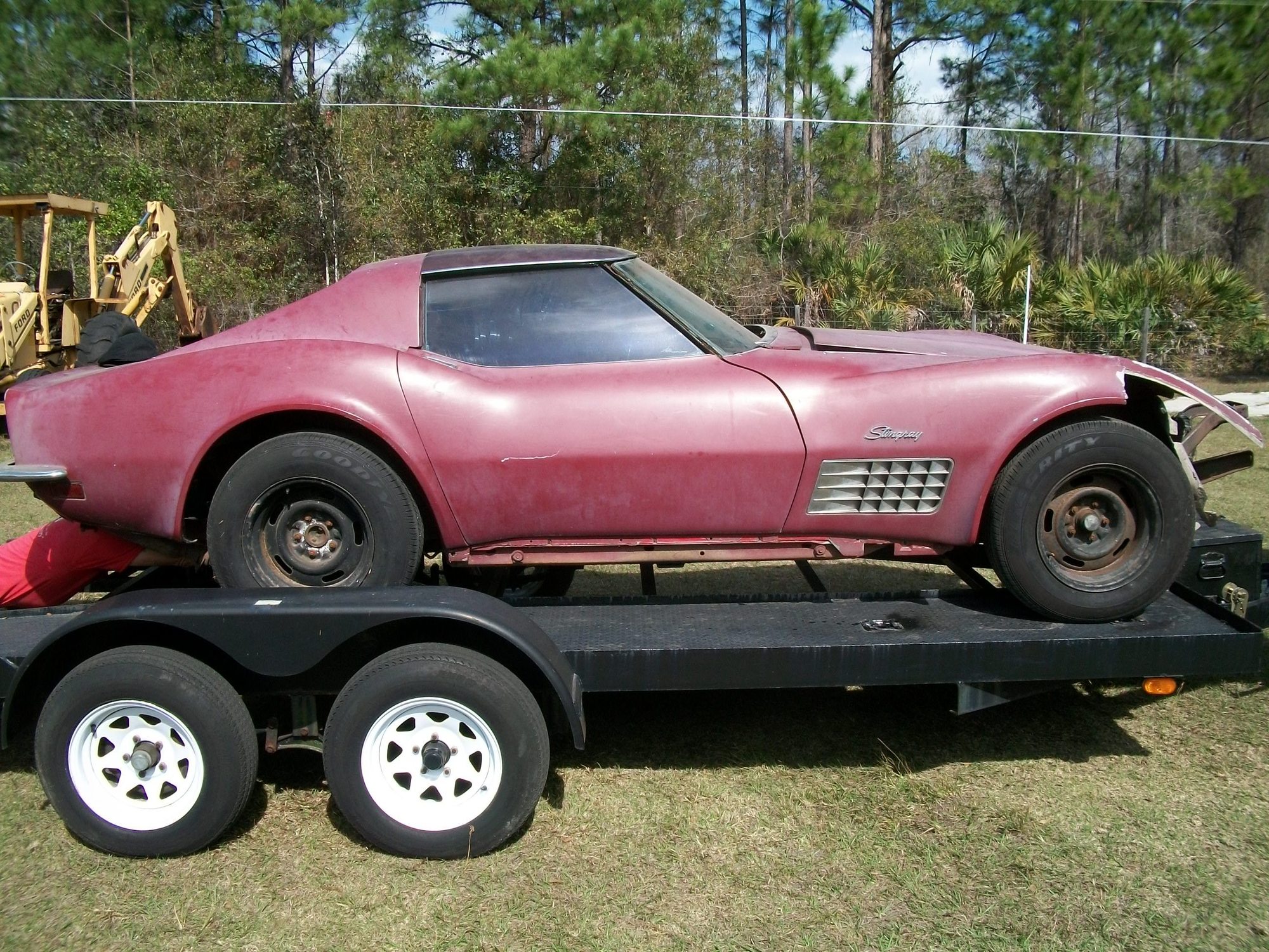

Several weeks ago, I bought a 1980 C3 out of Jacksonville, Florida. Next week, I intend on using my 16 foot, tandem axle dovetail utility trailer. The inside width of the trailer is 76 inches. Will this work, I mean, Have any of you hauled a C3 on this type of trailer? It is a 16 hour drive from Texas to Florida, and now I am getting a bit nervous.
Thanks for any input!
STONE

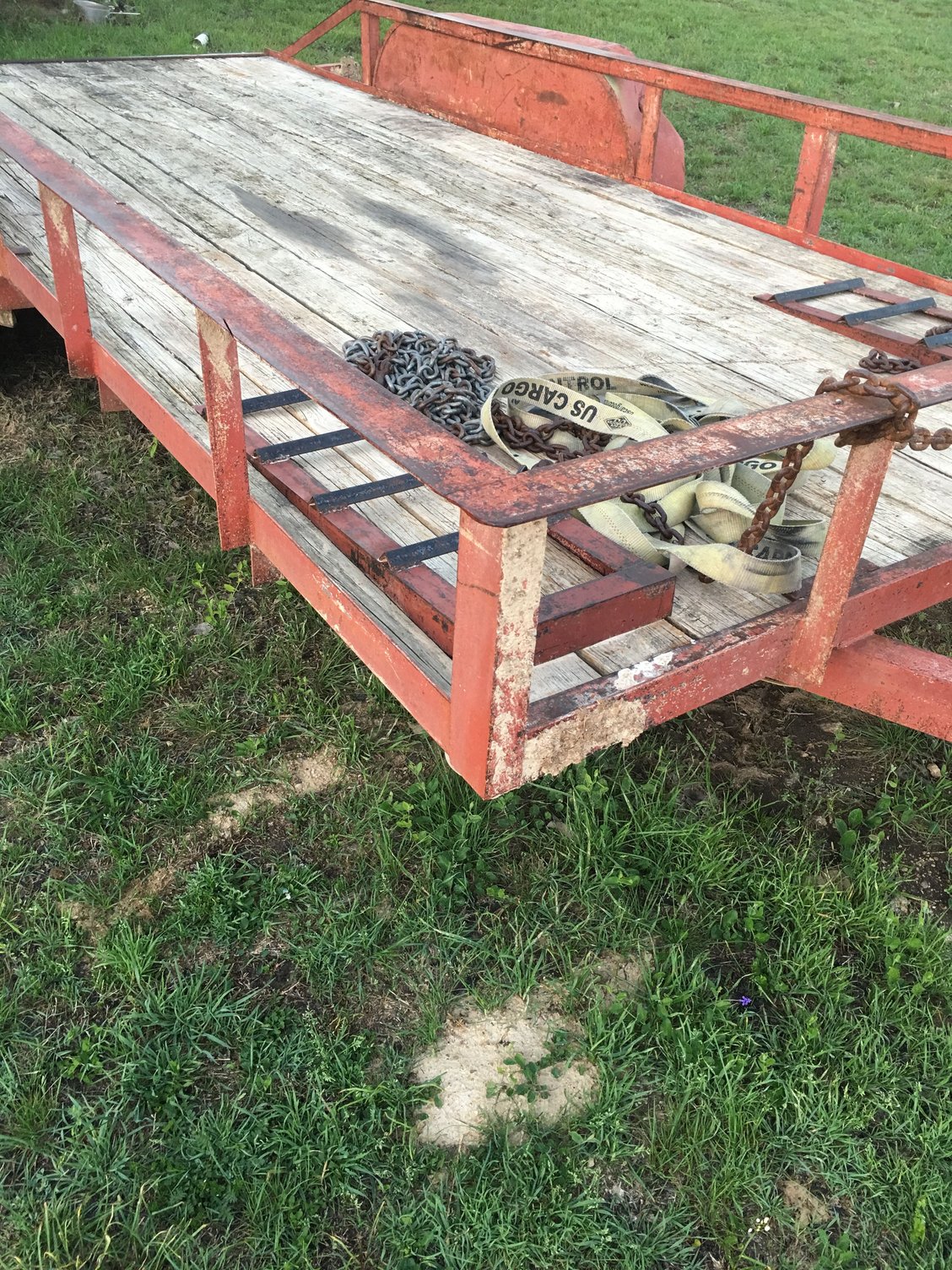

Thank each of you for your input. I bought this car a little over a month ago and due to work schedule, finances, and logistics, I am very limited on my trailer options. The side rails on my trailer are 13" tall, so I had already assumed that I would be climbing out of the car, the width was my biggest concern over the body rubbing or touching the rails during loading or transport. The loaded trailer weight is not a concern because I have carried much heavier loads. With a new battery, the car starts and drives, so we WILL be able to driver her onto the trailer. I have long ramps so as not to high center the vehicle while loading...We will also jack the front of the trailer up to further lower the rear.

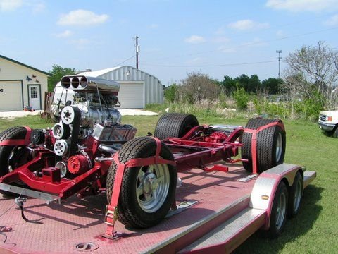

Here is my 71 on the 16' trailer
