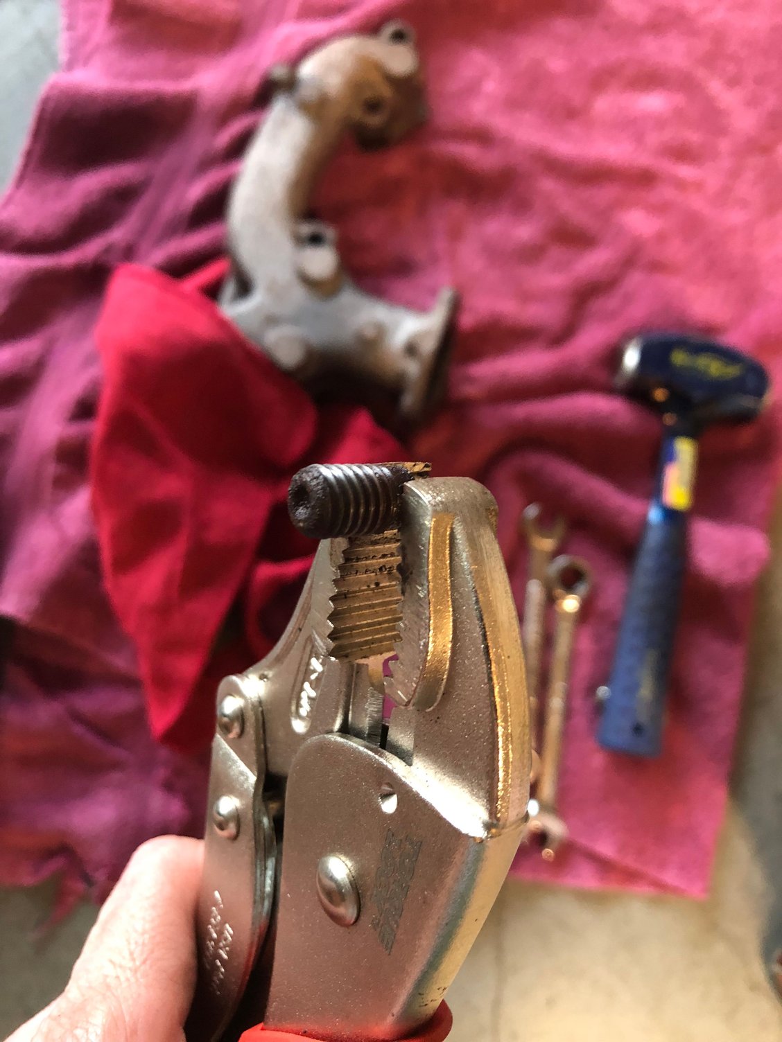

Sigh... sheared it.
Old Mar 29, 2018 | 08:21 PM
Jeffs 74's Avatar
Jeffs 74
Joined: Mar 2015
Posts: 203
From: Dallas Area Texas

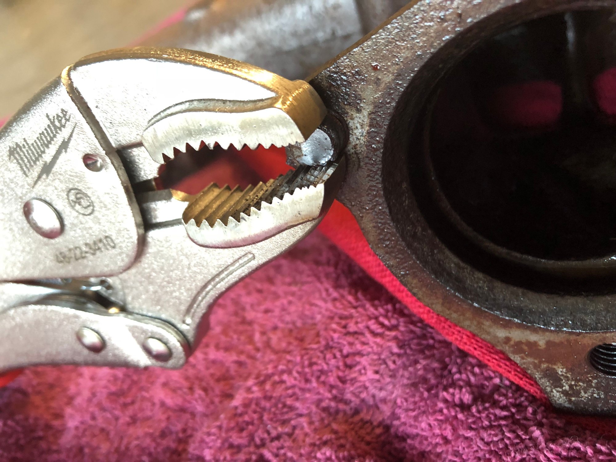

Well after shearing it... I put some more penatrating oil on it and did the other studs... came back with vice grips and a few hits with a hammer - and the dern thing came out! Early Easter present!
Sweet! 🤙

You got lucky. I had to have one of those drilled out on a manifold one time. Buy a lottery ticket! :-)

GM used cheap soft bolts. They drill easy. Roughly same hardness as cast iron, so missing by a hair isn't going to cause broken drill bits or taps.

Excellent. Good tip too as I am staring at one of those now. Did you use PB Blaster, WD-40, or some other penetrating oil? Thanks for the pictures.
David
Old Mar 30, 2018 | 08:04 PM
Jeffs 74's Avatar
Jeffs 74
Joined: Mar 2015
Posts: 203
David
pb blaster - sprayed them in the morning before work and the evening after work for 3 days

Heating the area with a small hand-held propane-canister torch while working the vice grips back and forth works well also.
