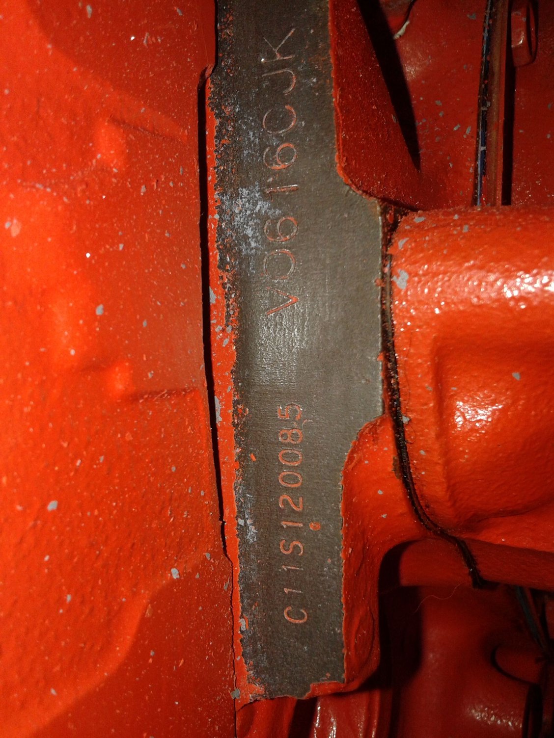

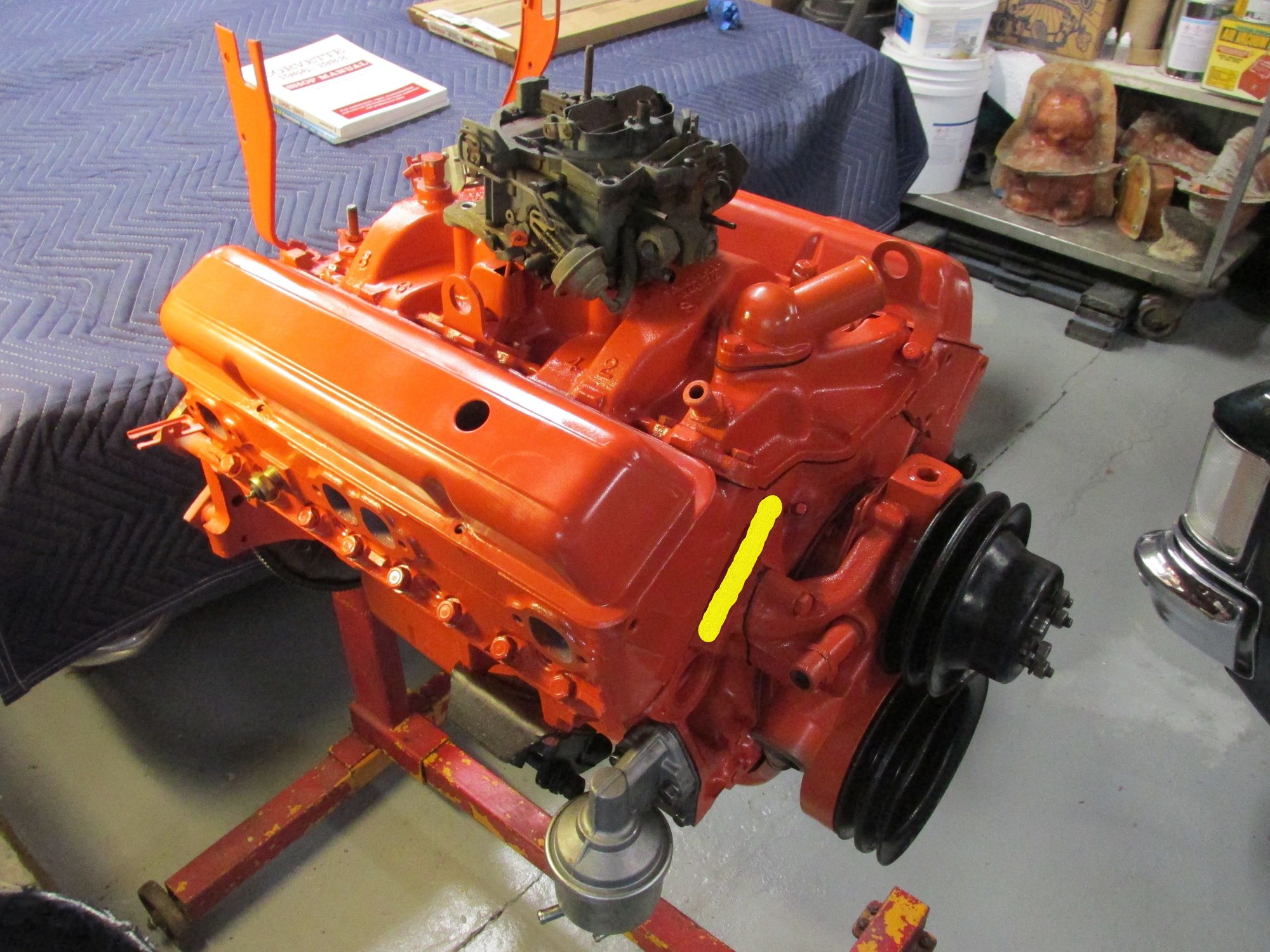

There is a pad on the block at the front of the passenger's side head which should have two stamps on it; one for engine identification, and the VIN derivative for your car as the second.
First picture...Engine stamp pad marked in yellow
Second picture...what stampings that Mike mentioned should look like
