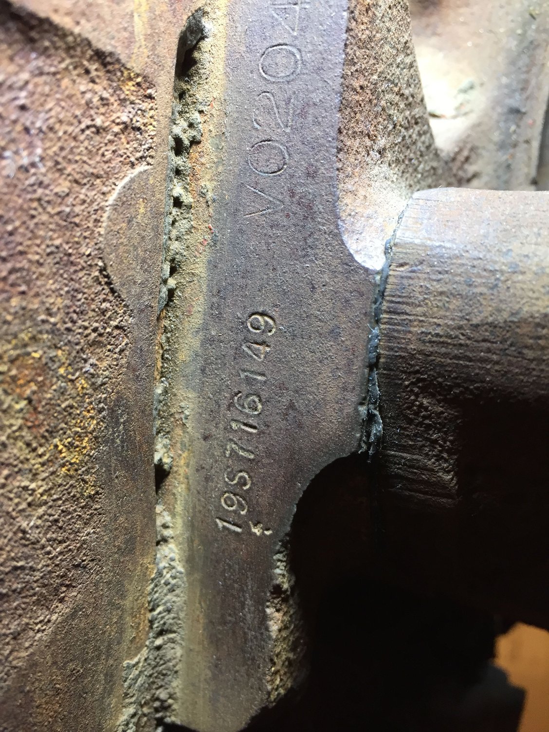

What can you tell me about my engine?
It is supposed to be a 350/350
Here are some pics
Thanks
Glenn in San Diego

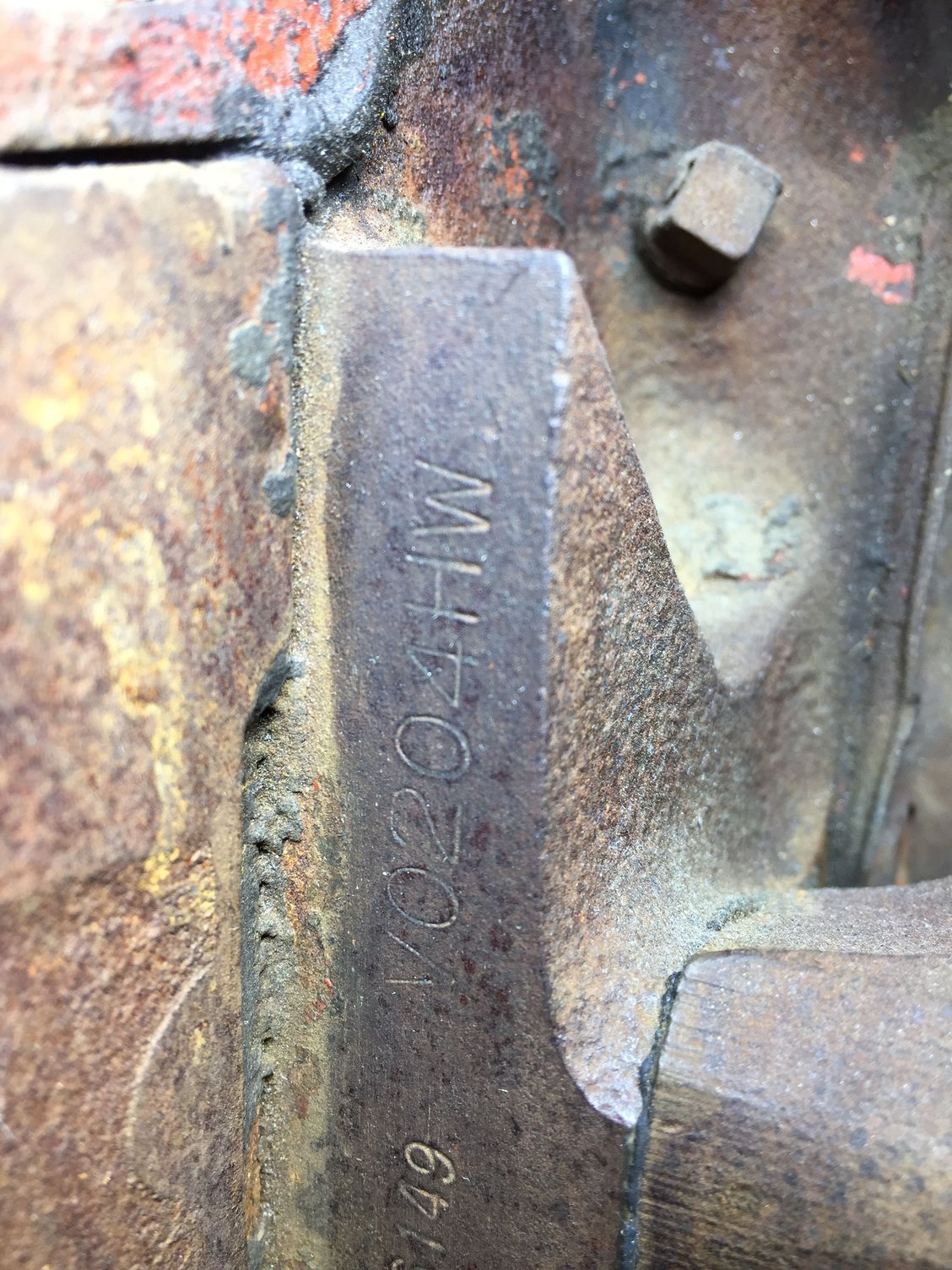

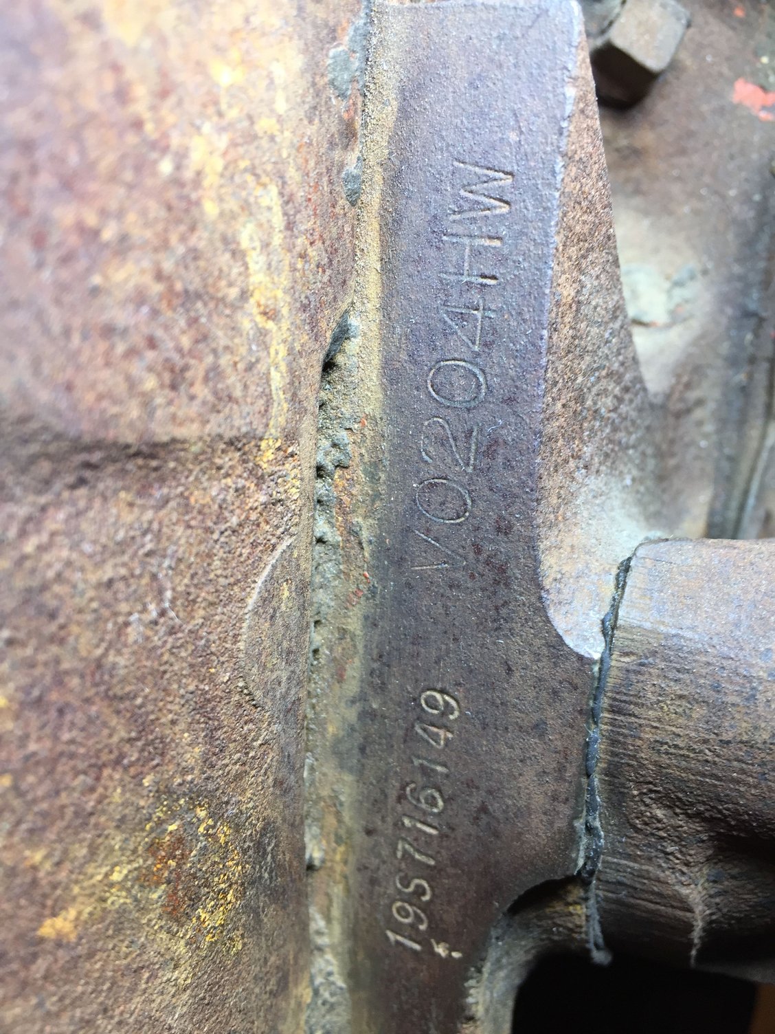

There are 2 HW engines. 65 327 shp or 69 350/350. Flint plant. Feb 4th. Does that 716149 match your VIN?

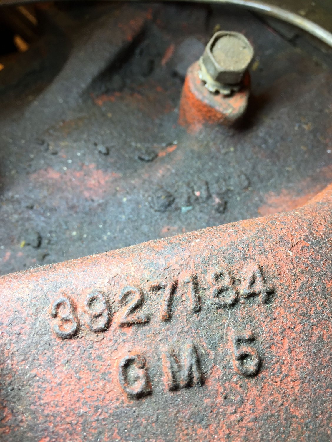

3927184 intake is a i969 used for both 350/300 and 350/ 350 . The HW block is a special cam (350HP) and 4 speed trans as derek noted. Need the head part number and date stamp to ID. 3927186 can be either .197 or .202 heads so you need to look at the valves to confirm. 3927187 will be .202 heads . Date stamp will confirm the year, could be 1969 or 1970. Nice find. Tim Also Stamped block vin ID falls within the 1969 Vin range

That's definitely a 69 vin stamp.
I have a 69 with vin number 716665 and my engine build date is Feb 11th, one week after the engine pictured above.

Yes the engine stamp matches the VIN

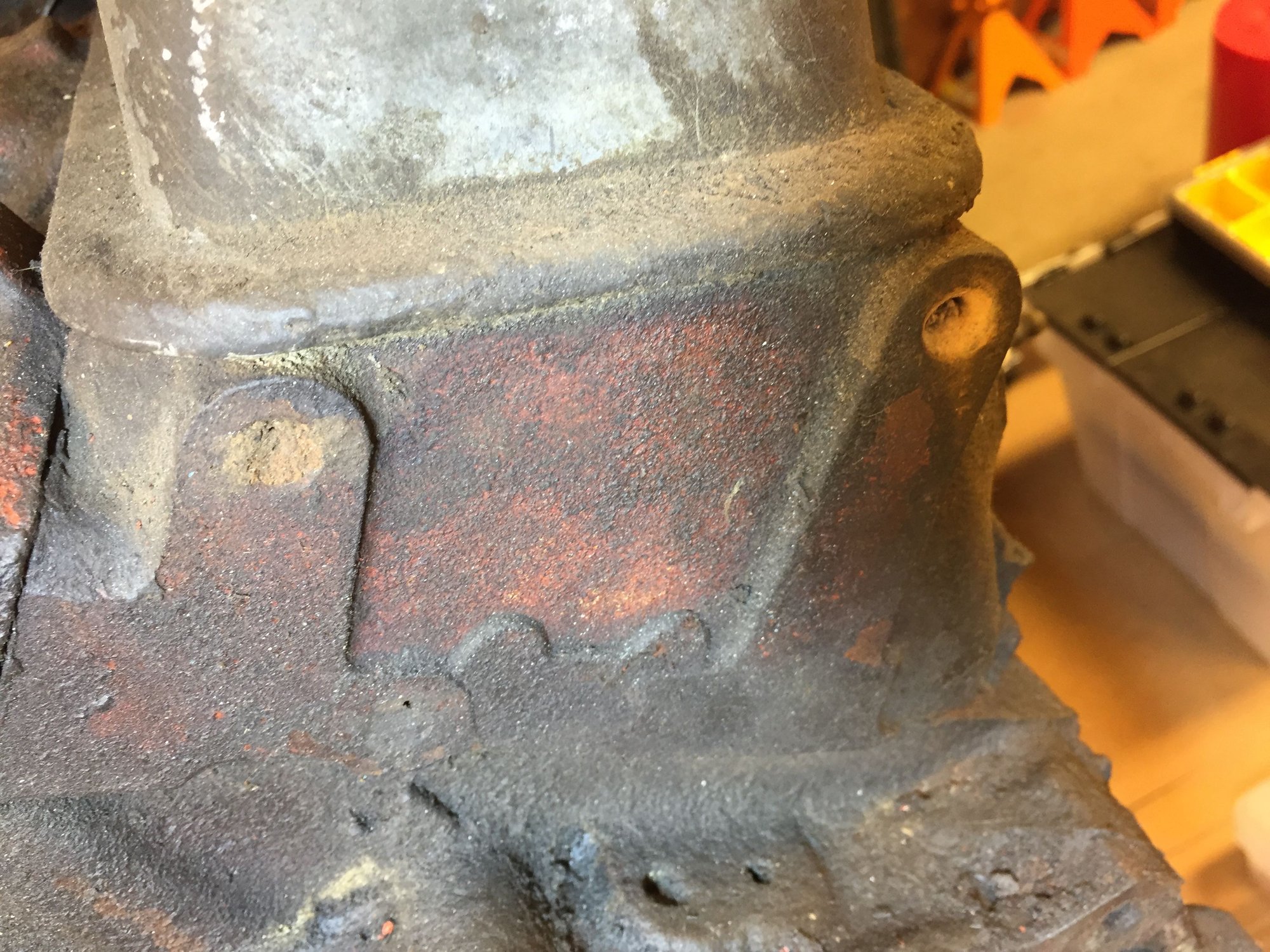

Old Apr 7, 2018 | 01:00 PM
Alan 71's Avatar
Alan 71
Joined: Sep 2006
Posts: 31,335
Likes: 4,450
From: Westminster Maryland
Hi Glenn,
The part number and casting date for cast iron intake manifolds are near each other on the runners just a little forward of the coil mounting bracket.
The alpha/numeric date code is the same as that used for the engine block. (A....January)
Regards,
Alan
Part number upper.
Date code lower.
The part number and casting date on sb heads.
It can be seen on the left side head by looking through the oil fill hole in the valve cover. The valve cover needs to be removed to see the info on the right side head.

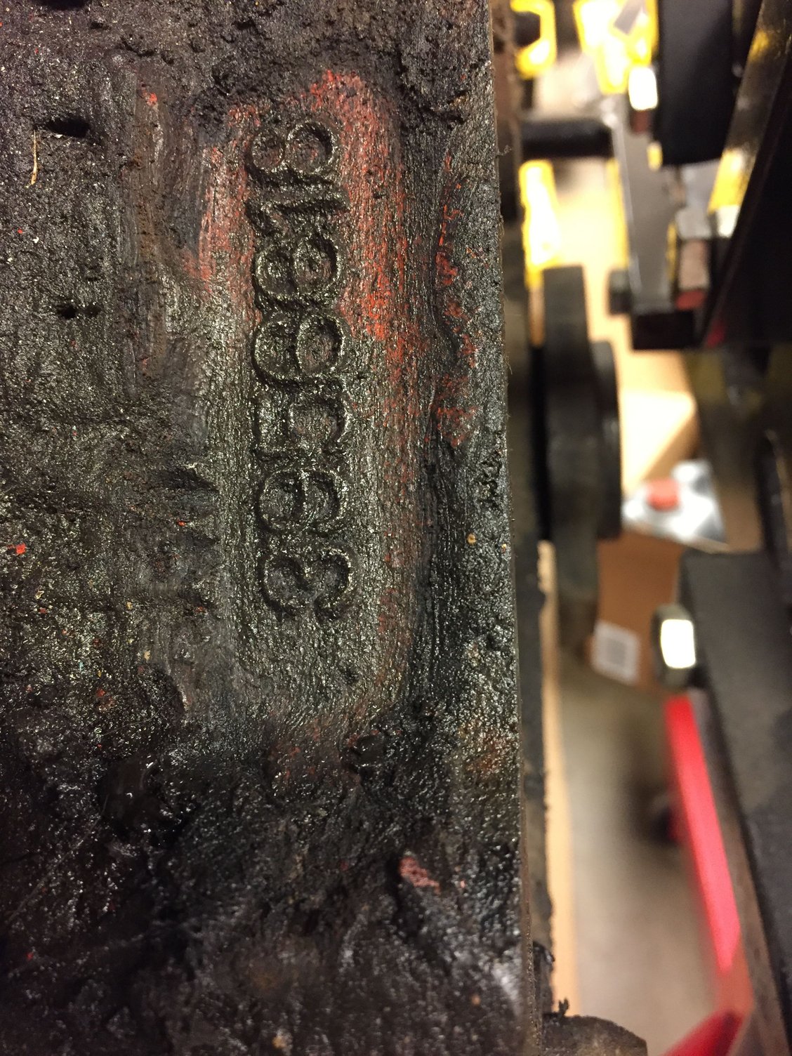

Hi Glenn,
Here's one just for fun.
The foundry needed to keep track of when the blocks were cast.
A 'casting clock' was used for that. It's located on the rear flange of the block along with the date code and the casting number.
The 'clock' had 2 parts:
First the shift needed to be noted... D for day, T for twilight, and N for night. An arrow was rotated to indicate the shift.
Secondly the hour of the shift needed to be noted.... an arrow was rotated to indicate the hour within the shift not the time of day. The double dot indicates the first hour of the shift.
This clock is from a block cast on December 31. The shift indicator is pointed towards T.
The clock therefore indicates that the foundry was operating and pouring blocks on New Year's Eve.
The block was poured on the 7th hour of the shift.
The Flint Plant was assembling 5000 engines per day so there was a tremendous need for blocks from the foundry.
Regards,
Alan
