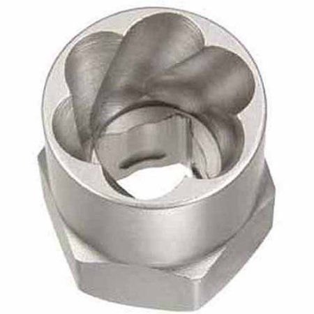

The #2 body mount area you posted a photo of is not that bad. Gosh knows I have seen worse. It is nothing that a bit of cleaning and POR-15 products could not take care of.
I do agree...I would try to see if I could get a six-point socket on the head of that bolt ...but if that does not work I would then try my Irwin bolt extractor tool ( which have saved me time numerous times)....if it did not work..I would cut it off.
http://www.irwin.com/tools/screw-bol...-expansion-set
