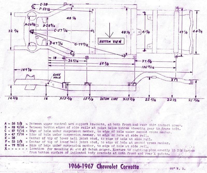

Look at how different the rear bumper area is on a 66,67 frame. Lou.
