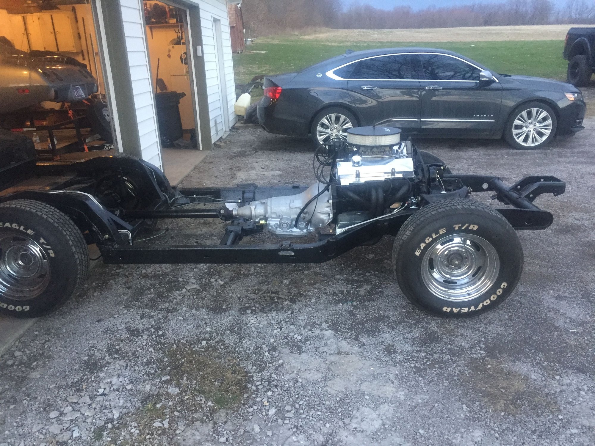

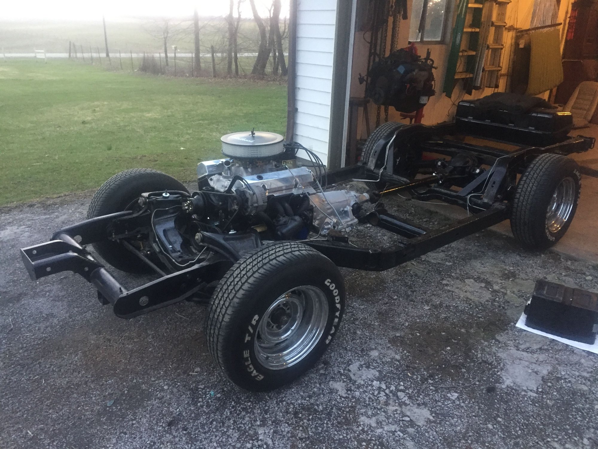

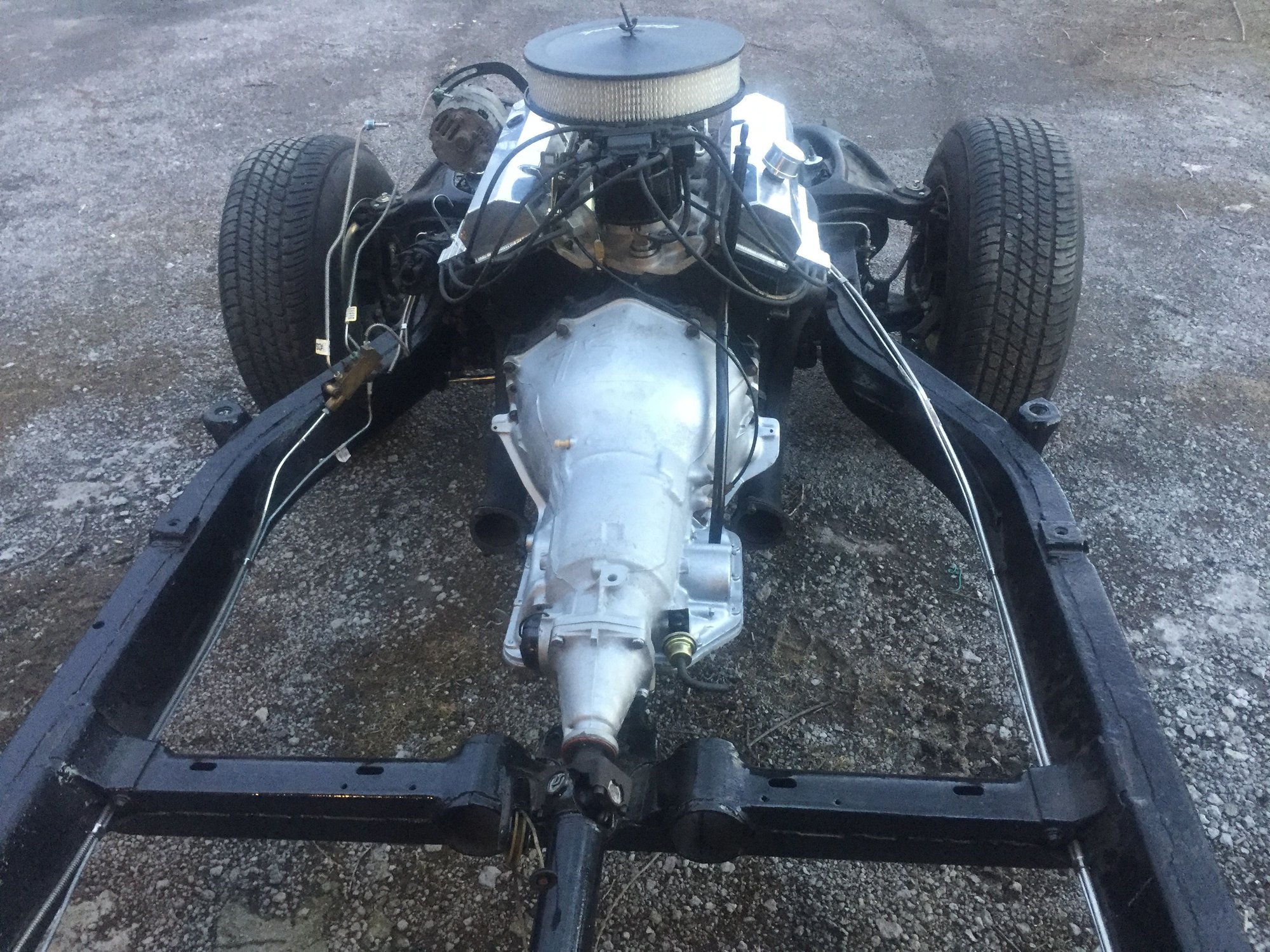

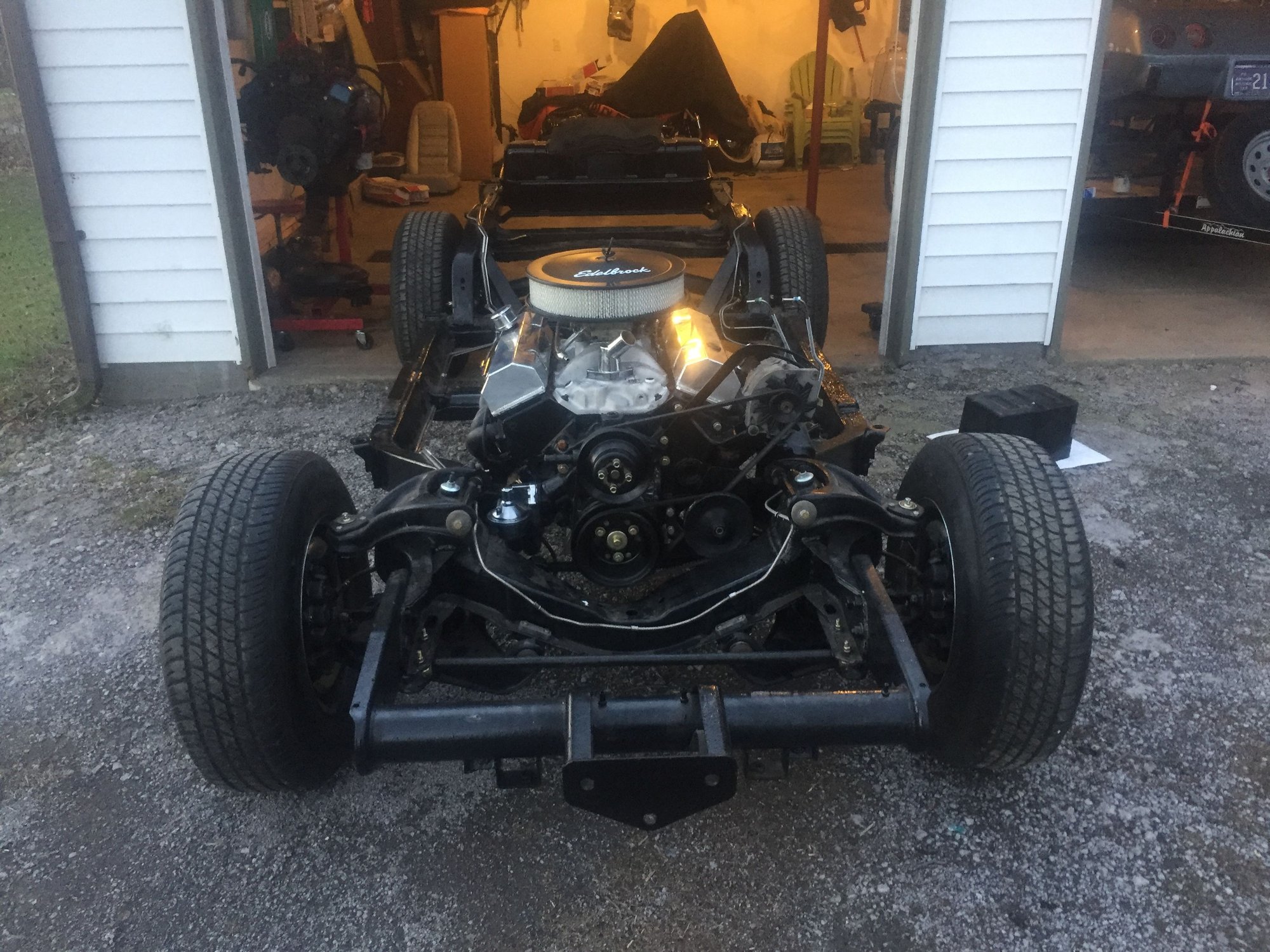

Default Here are some pics

thanks John! The body is off and ready to go back on. It had a bad frame so I got another one and built it this winter. May 1st the body will go back on! I can’t wait!
