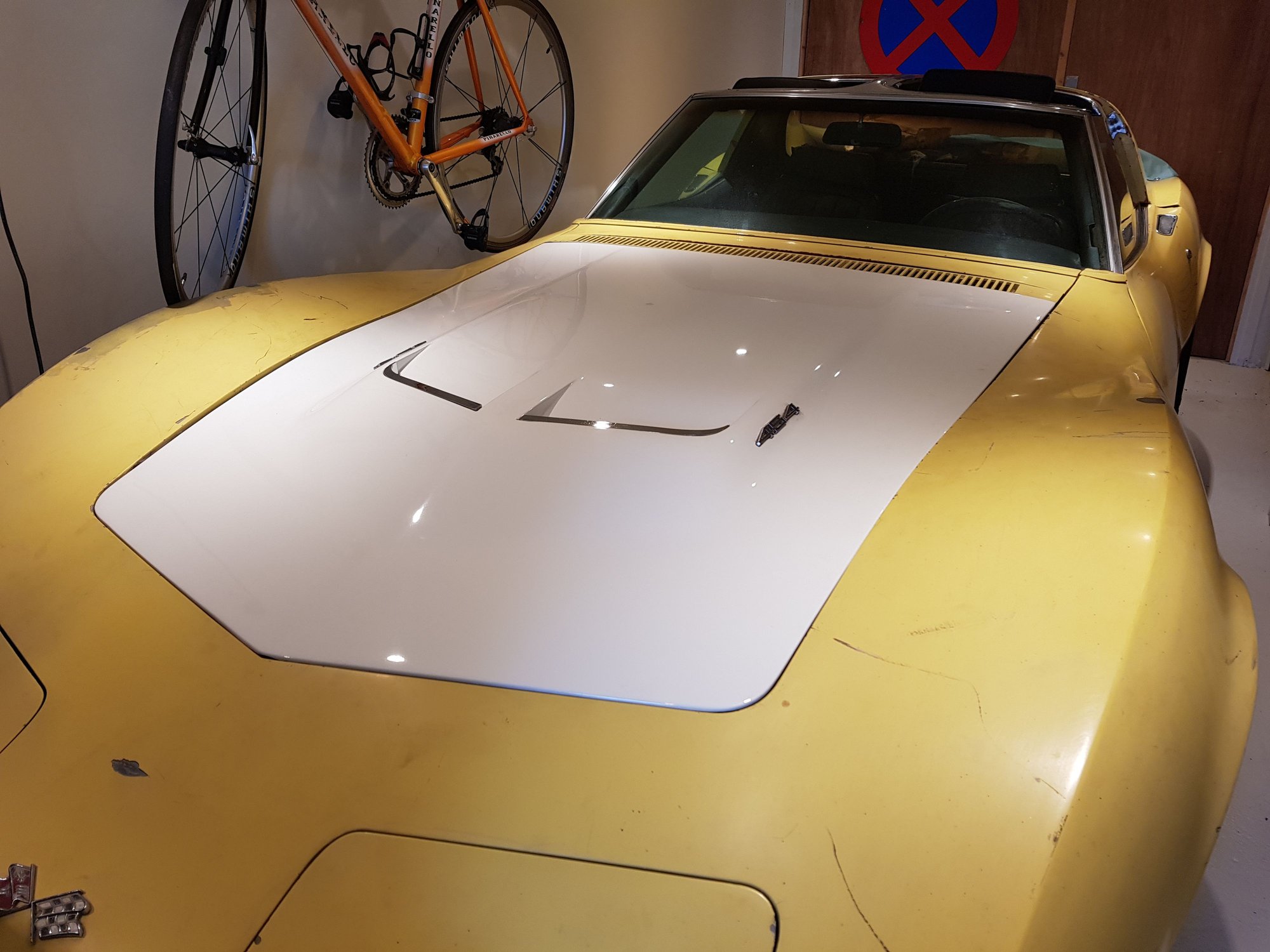

I have no answer to your question, BUT I just did like you would like to do, my car is a 69 Coupe project car.
I did find a VERY nice 1970 454 GM factory hood.
My price was $600, with the chrome hardware, and 454 text (will be replace with 427, a new 427 sbc will come into the car)
I'm happy :- )
