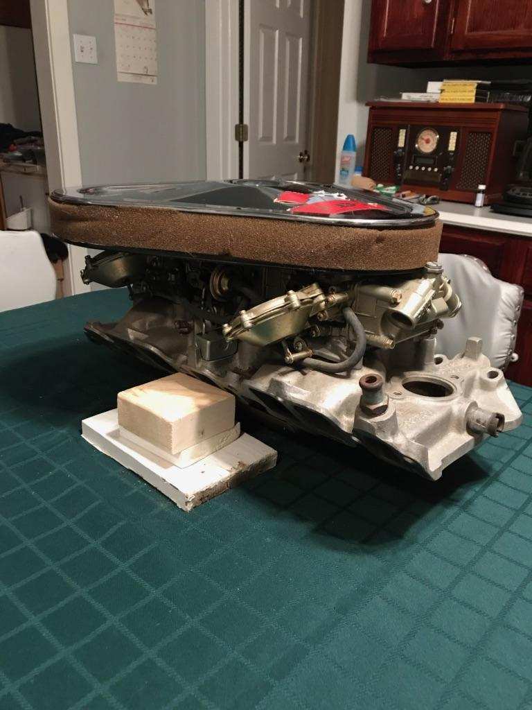

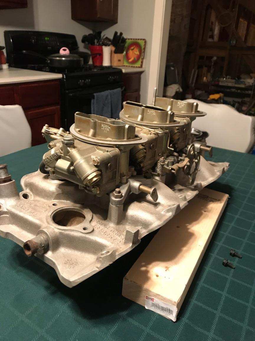

Front and rear carb numbers are as follows:
3902353-EU
List # 3659
8/13
Middle carb is as follows:
39440929-EV
list # 4055-1
981
Intake is :
GM 3937797
any ideas or should I look for numbers elsewhere?

It would be nice if you filled out your profile with the year, engine, etc. or stated it in your post.
813=1968 January 3rd week
981=1969 August 1st week
The chart on the bottom of this shows all tri power usage from 67 to 69
https://tech.corvettecentral.com/201...oubleshooting/

its out of a 1969 427 selling for my father in law and asked him for help in figuring it out since he is 900 miles from me and he is not tech savy

[QUOTE=Shane Mahnke;1597032426]its out of a 1969 427 selling for my father in law and asked him for help in figuring it out since he is 900 miles from me and he is not tech savy[
Here are the pics of Shane's parts........
