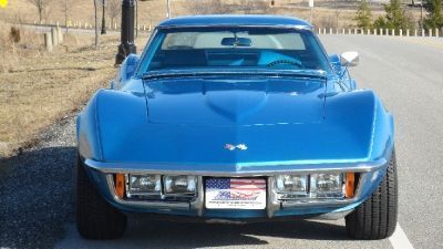

Have a 68 with the Eckler clip and plexiglass cover. i want the old pop up style with the round lights. Do I need a whole new Clip or can I just mount the boxes in the Eckler clip?

If i am not mistaken the ecklers clips and nose panels that had their monza lights are a different size hole to the stock headlight hole,
And missing the headlight bar, When ecklers still sold lots of custom stuff the catalog noted monza headlight covers would not swap out for the covers of a c3 with ecklers recessed headlight conversion, a bolt in kit that one could easily go back to pop ups if desired,
You will also notice your headlights are further forward than they would be stock,
You can do Pop ups but might be easier using a stock nose to make it happen,
Sorry i didnt have better news

farther forward and farther back at the same time. the front bumper lip is about 1/4 inch in front of the front edge of the headlight opening. so that whole nose is as long as newer style with composite bumpers. are you going back to chrome bumpers? you need bumper, grille surround trim, lower valence, bumperettes, possibly grilles and turn signal lights, and whatever brackets are missing under that nose, which may well be all of them. that nose may be marketable. try to be nice to it while removing it.

A little more on ecklers monza nose,
As you see it was offered as a clip with functinal hood, it was also offered as a one piece flip tilt clip, with or without flares,
And without grabbing my old catalogs to be 100% i recall it being offered as just a front 1/2 wheel wells forward idea,
Ralph, in my opinion got the perfect non chrome bumper look with his monza idea,
Yes, its longer than 68 to 72, i didnt cover that as the op said he wanted pop up lights, he didnt mention if he want to go back to chrome bumpers too,
So ralph goes longer nose like a 73, used the larger better looking 73 74 grills and pushed the headlights forward to accent the low long flowing racer look, all monzas are made to have headlight covers, and seems to me he tweaked the peak a little,
To me this look is so much more visually appealing than bug eyed fia racer lights,
ps,
What makes yours more rare is most monzas out there are the tilt clip, yours has functional hood,

What I would do is raid a junkyard for later rectangular lower profile bulbs and all the mounting hardware you can get.....like late F body cars had.....the GLASS bulbs are about 2.5 inches tall, similar width as what you have.....I built my own frame to mount the hardware on, so fully adjustable....I used 1/2 PVC vinyl from HD to make the supports, held in place with GOOD glue and stainless screws.....AND as shown below I brought them forward 1/2 way and reduced the stupid looking openings by 1/2 also......if I had your car, that's what I would do.....

Mrvette i have to humbly disagree,
His car looks perfect as us to me the the littler headlights would make that big bucket look like its squinting,
If you want those smaller lights its best to rework the bucket smaller too,
I like your car a lot but i like this monza look better,
But this is all moot the op wants pop ups
