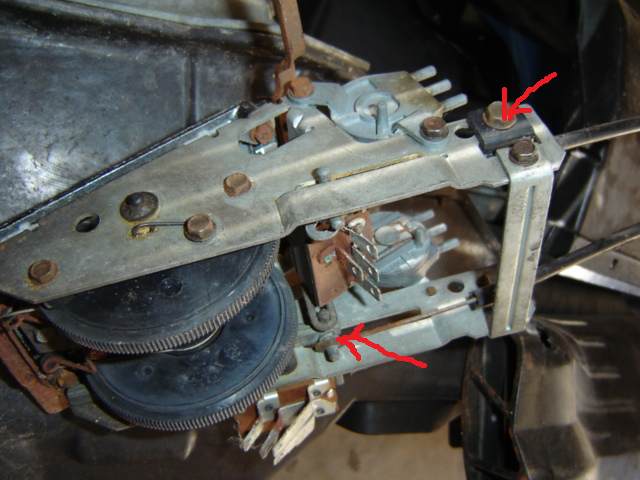

I don't know if this will help or not but I will pop in some old photos of my '68 so you can see what the thing looks like removed. I know my '68 is control is one year but there may be enough similarity to point you in the right direction. I am pretty sure you will want to disconnect the cables under the dash and leave them attached to the control during removal.

Thank you 68BB. I've decided I'm going to replace the heater control assembly, so I have to completely remove it. Does anybody know a trick to removing the heat control cables?

It’s been a while since I had mine apart, but IIRC there is a retainer that slides over the pin that the cable connects to. When I removed it I used some needle nose pliers and it came right off. Then pull down on the cable and it should pop off.

the small retainer that needs needle nose pliers to pull off and the cable retainer at the front end

Realizing that my photo above would probably keep some of the folks awake at night if they thought I installed that bracket in that condition, let me assure you it was not. Haha!
