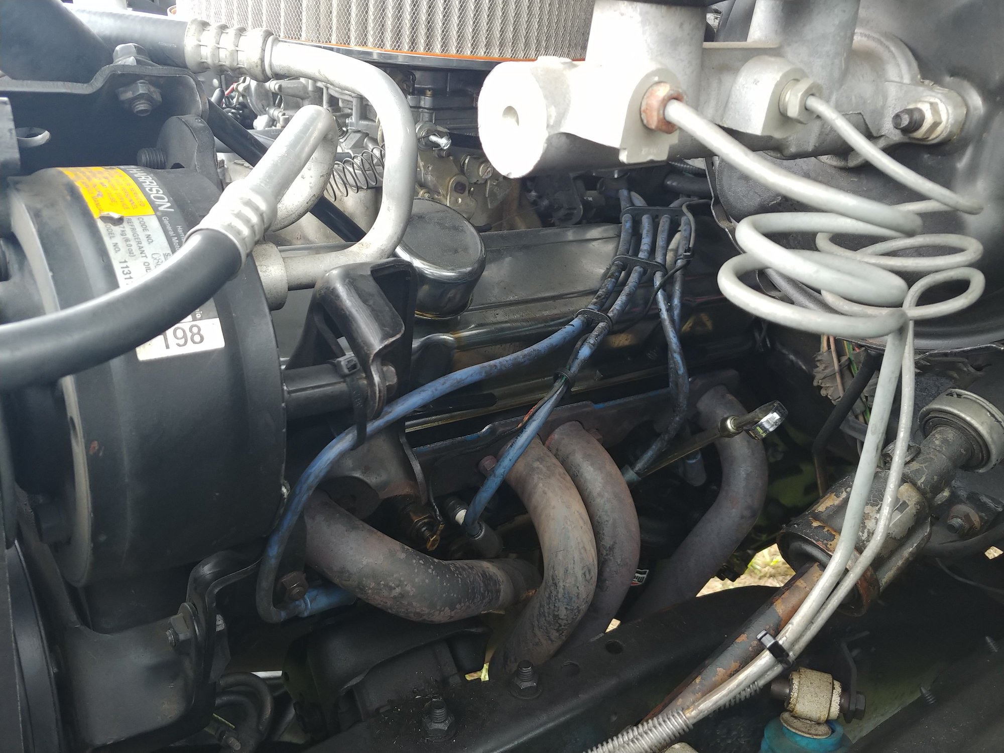

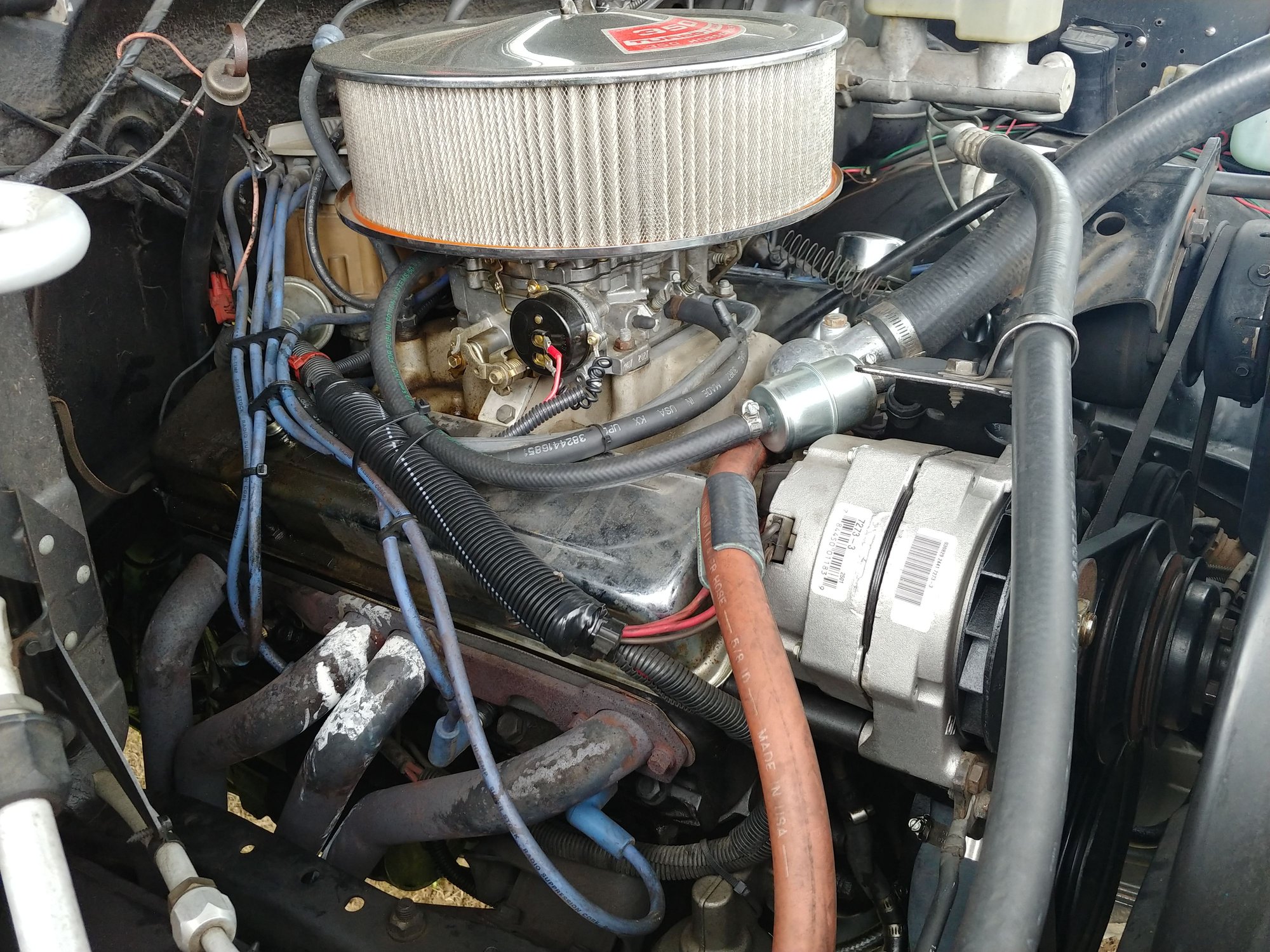

Hey everyone! New member here, really excited for what the future holds. I recently bought an 84 K5 Blazer with a Corvette engine installed, however the person didn't know exactly WHAT engine it is. I have tried finding the block number but the ones I found I couldn't find anything online about them. I've posted a few pics I took. I'm hoping someone out there knows what engine this is. Thank you everyone for looking!

I don't see TSB in any suffix code chart. engine was made in Ontario Canada. need block casting number. may well be 307 or 305.

alum intake and headers. must be a corvette engine... Troy. clean the number off below the k0607TSB. i bet it is the vin number of your truck. if so, it is a numbers-matching truck...

Holley Dominator aftermarket intake with an Edelbrock (not a) Performer carb. Can't tell if the block is blue or black? I am betting that this is the original engine that some one slapped some aftermarket parts on.
