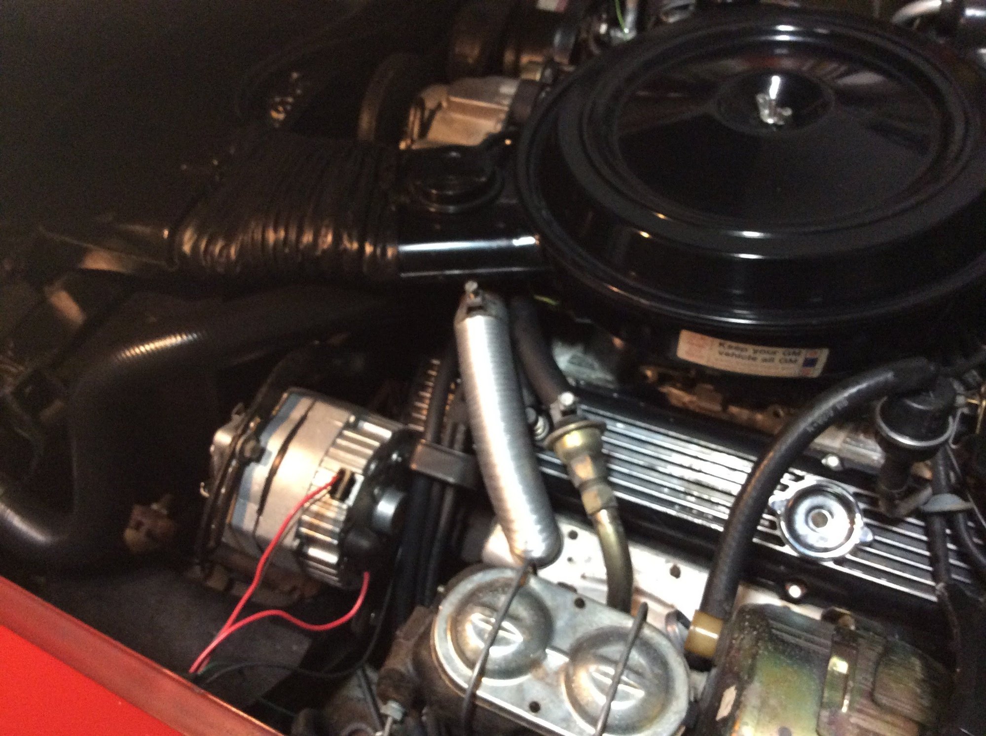

I got a remanufactured one from Advance Auto Parts, but decided to take a picture of the old one before I turned it in for the $10 core charge:

Sorry to hear that. Yes, I remembered when I had my car checked out that was one of the parts the guy was taking a very close look at. Alternators with that part number are relatively rare, and it is also a date coded part. The date 0B3 would be February 3, 1970. My car's build date is March 23, 1970, so it was a "numbers matching" part.
I figure I'll just keep it in a box for the next owner.
