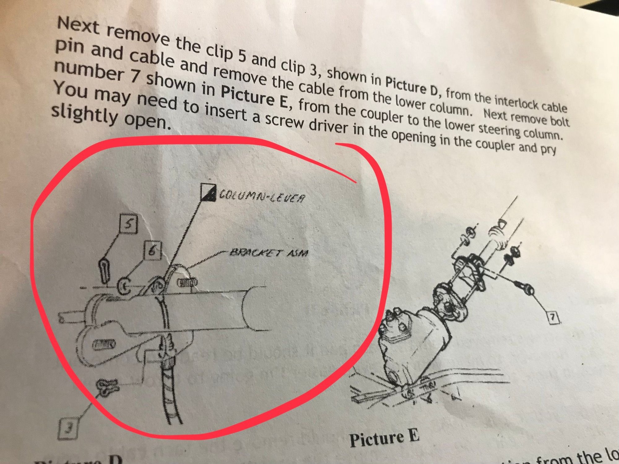

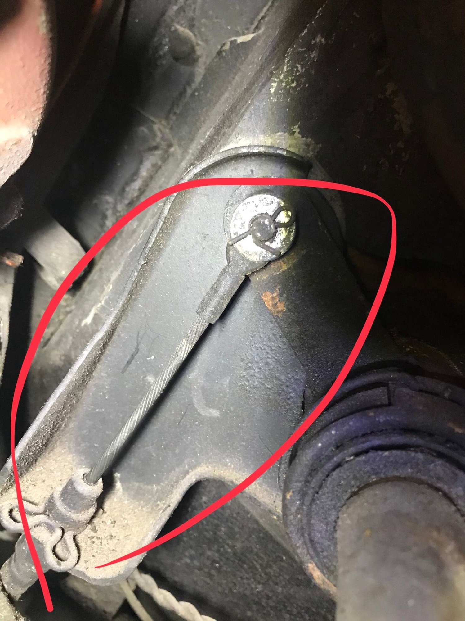

Removing steering column to get dash back in... before I dive in just want to make sure this is correct.... see photos and thanks

Yup. key / column interlock cable from the transmission
M
I'll also mention that the 2 carriage bolts that hold that bottom flanged part to the floor are actually loose (or at least were on mine) so when you loosen the nuts they can start to spin and you sometimes need a second set of hands to keep the square under the head engaged while you remove the nuts

Thank you....mine were tight and I had already loosened them and lowered the column hoping to avoid pulling it....now looks like Id rather do that than working in a cramped space.
