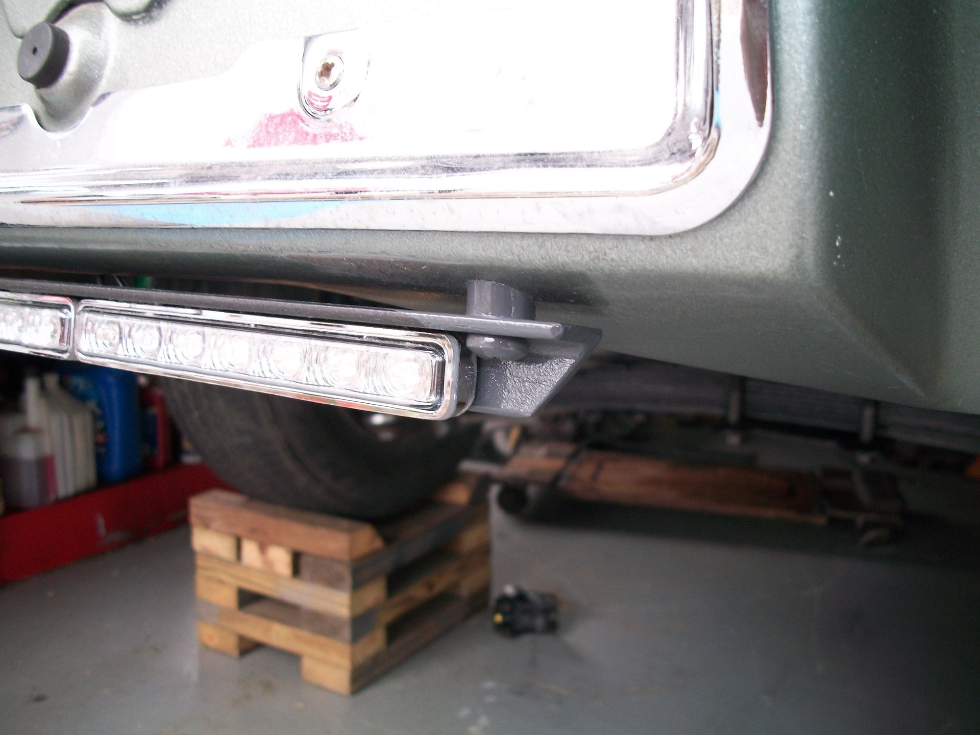

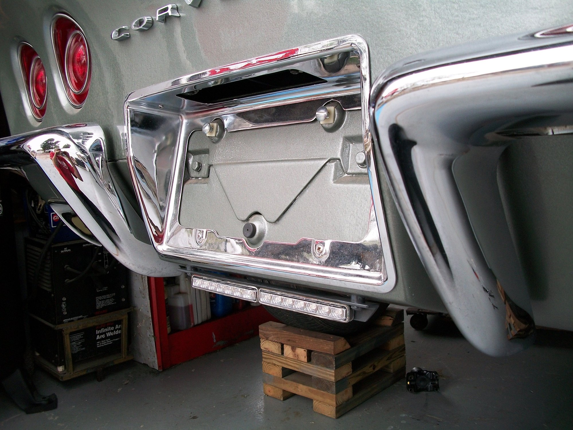

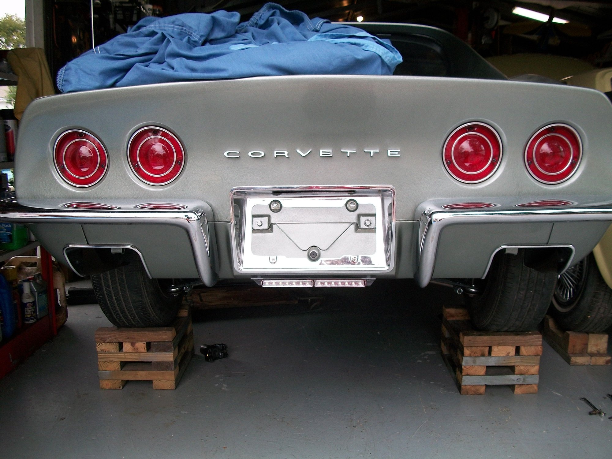

I swapped the inner buckets on our 71, to give us 4 tail lights. My plan for reverse was to use the LED license plate frame, but the one I bought wouldn`t fit in the stock license plate trim. So I cut the LEDs off, and mounted them below. Did someone mention "cheap"? Twenty bucks.

Originally Posted by oldgto
[COLOR="Blue"]I swapped the inner buckets on our 71, to give us 4 tail lights. My plan for reverse was to use the LED license plate frame, but the one I bought wouldn`t fit in the stock license plate trim. So I cut the LEDs off, and mounted them below. Did someone mention "cheap"? Twenty bucks.
That looks slick!
I've always preferred the 4 tail lights of the 68's vs the 2 but I just didn't want to install the 68 style back-up lights.
This is a inexpensive yet elegant solution.
Awesome!

Thanks! I used a scrap piece of 1/2 by 1/2 angle iron as a bracket, glued the LED strips to the bracket with weather strip adhesive. Then I took some plastic spacers, cut them at an angle, so it would sit flat while mounted to the curved panel.
