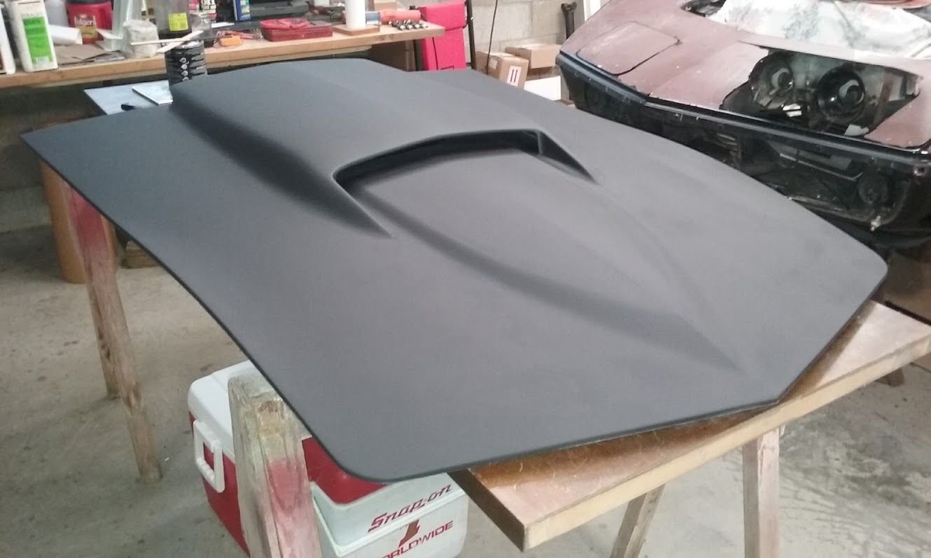

Originally Posted by PainfullySlow
I ran into the same issue: I know that my aftermarket manifold and air cleaner will not fit under a stock hood.
You mentioned having a bodyshop glass in a hood scoop. I am currently modifying my stock hood for a stinger style scoop simply because I really like the look
I don't have any finished pictures yet since I just started this project two days ago but it really is not terribly difficult. Here is my progress so far
Marking for the cutout.
The hole
Scoop bonded to the hood.
I chose to go with a lower profile scoop which is giving me approximately 2.5" of extra clearance. It is raining today so I will not be doing any fiberglass work but as soon as it dries up I will be finishing the underside with fiberglass and then blending the scoop into the hood for a seamless look.

Originally Posted by theandies
That is exactly what I want to do with my stock '71 SB hood. I can't wait to see the final project.
This was a stock '71 SB hood.
Bashcraft - that looks great. Exactly what I'm going to do someday. Thanks for the picture. I think that I'll move the stinger back a little to get the cowl induction effect. How far does the rear of the stinger go back on your mod?
It's back as far as it can go without the wiper door hitting it when it opens.
