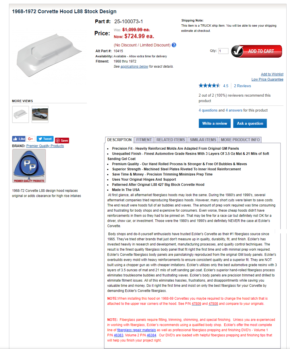

The Ecklers L88 hood is a well proven, good quality hood. I'd go that route.

Then right now I am looking at getting this one. Thanks.

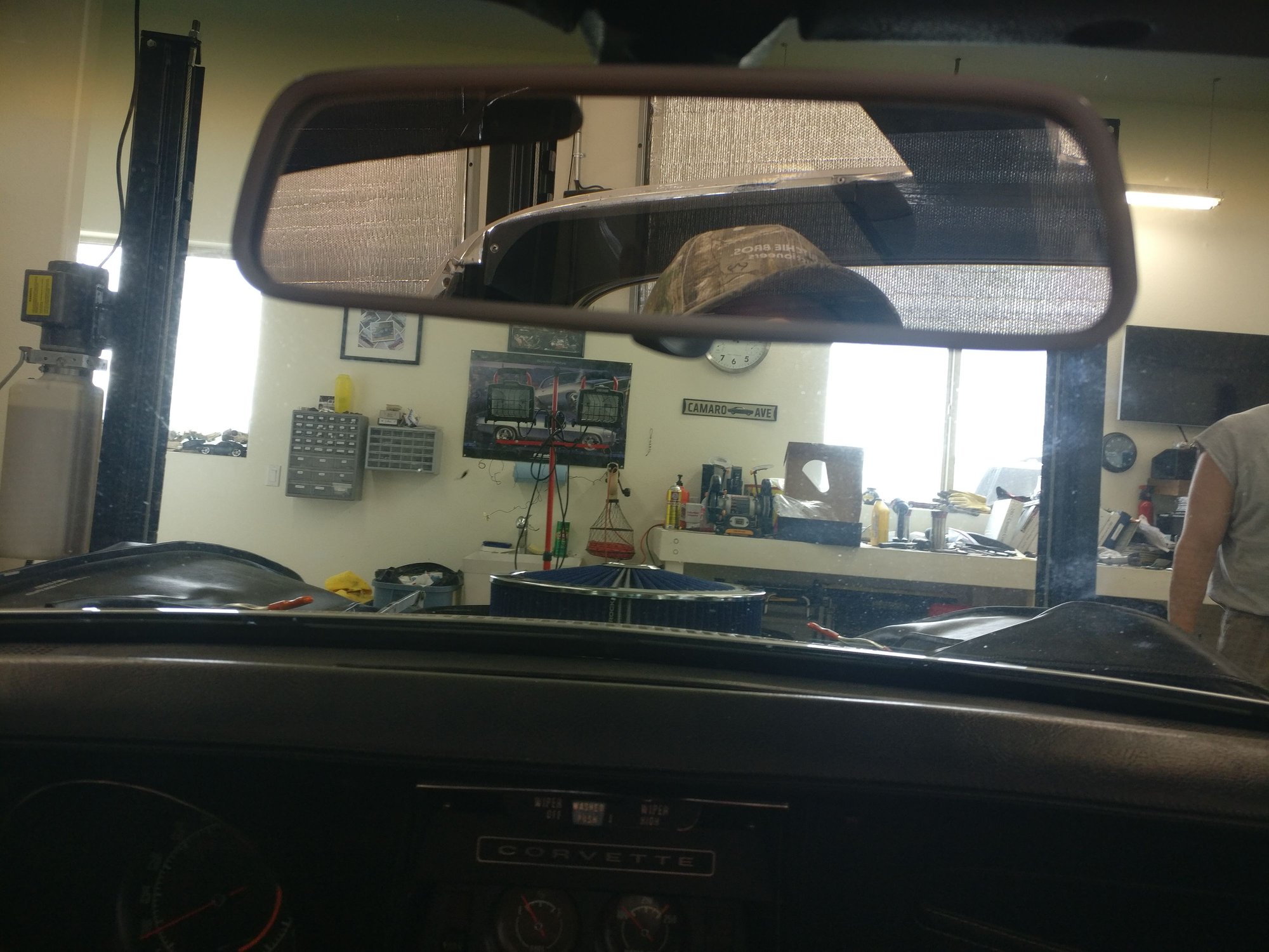

Before/after. Small block hood definitely isn't going to fit 😏. Might have to reduce the carb spacer size and the switch air cleaner nut to get enough clearance to fit under the l88 hood.

A 2" drop base air cleaner like the repro LT1/L88 air cleaner will free you up some room.. Your base looks like its only 1.5" drop.
Definitely do the 2" drop first and see how much more room you need.

Measure the space between the top of your air cleaner and the drip rails. If it is 4", the stock L88 hood will not be tall enough. You will have to get the Ecklers L88 Tall Style hood. The stock style L88 hood has 1½" less clearance.
Tall Style L88 Hood......https://www.ecklerscorvette.com/corv...1968-1972.html
